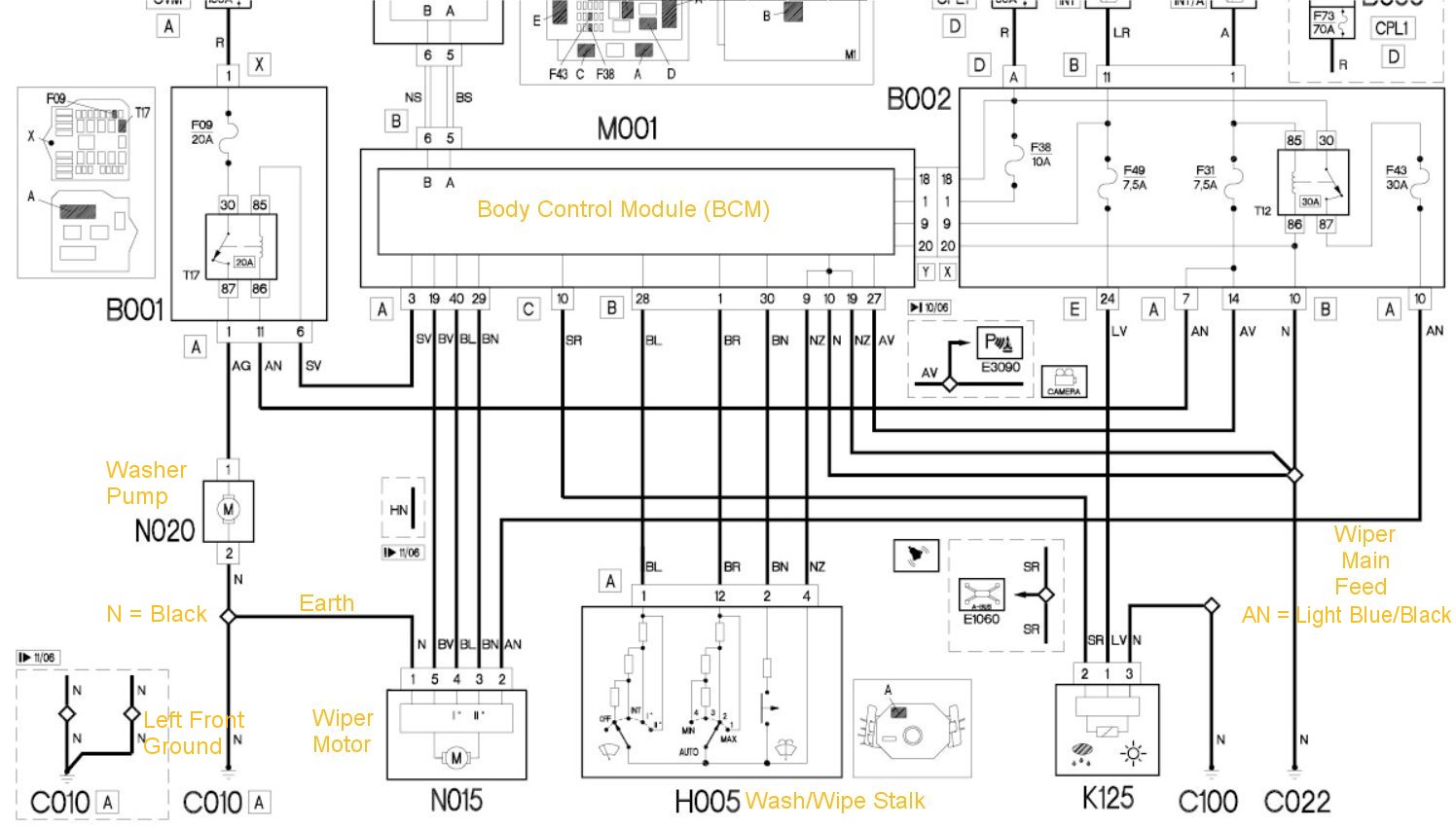

Hi
I have attached the schematic for the wipers. They have a main power feed, and logic control signals to and from the body control module. There is also an earth.
Inside the wiper motor casing is a thermal/high current overload switch, which protects the motor in case the arms/blades jam (e.g. frozen to the screen). Sometimes these switches become erratic, especially if the van is parked up for along time. If you tap hard with something onto the motor casing, it sometimes gets them going again, otherwise you need a new motor, or motor plus crank etc mechanism if you want to save on dismantling and swapping bits over.
Also worth checking that the spindles are running freely in their housings, as if they are partly seized and motor is having a hard time its current drain will increase. The extra voltage when the battery is being charged (14 rather than 12) will further increase the wiper current, and that might just be enough to trip the overload switch. Once the current is switched off and it cools down it resets itself.

Hi

As Communicator mentioned, you can easily check the connector if the correct signals are being sent. pin 1 & 2 should have 12V, other ones signal Interval, Low & High speed with an active LOW, this means 0V on the pin when the corresponding mode is active... Have you checked, with motor arm disconnected, if the wipers move freely and the linkage is not corroded? According to the schematic, the BCM is also responsible for activating the windscreen washer pump, does that still work?

As you have misbehaviour from several "customers" of the under dash fuses B002, I am wondering if there is a problem with the live feed to B002. It is supplied from F71, which is an 80A maxi fuse situated on the small panel on the battery positive terminal. A thick red wire runs from here to B002, where it joins with a nut and bolt. I suggest you check out F71 and the connections at each end of the thick red cable. If there is excessive resistance, as soon as you start to draw appreciable current the voltage will drop down, which may make the BCM play up. I also suggest you check out the 10A fuse F38 in B002, which feeds the BCM, as if it has a poor connection this too could starve the BCM of power. Of course, it could all be fine and the BCM is the culprit, but worth eliminating as a possibility.
