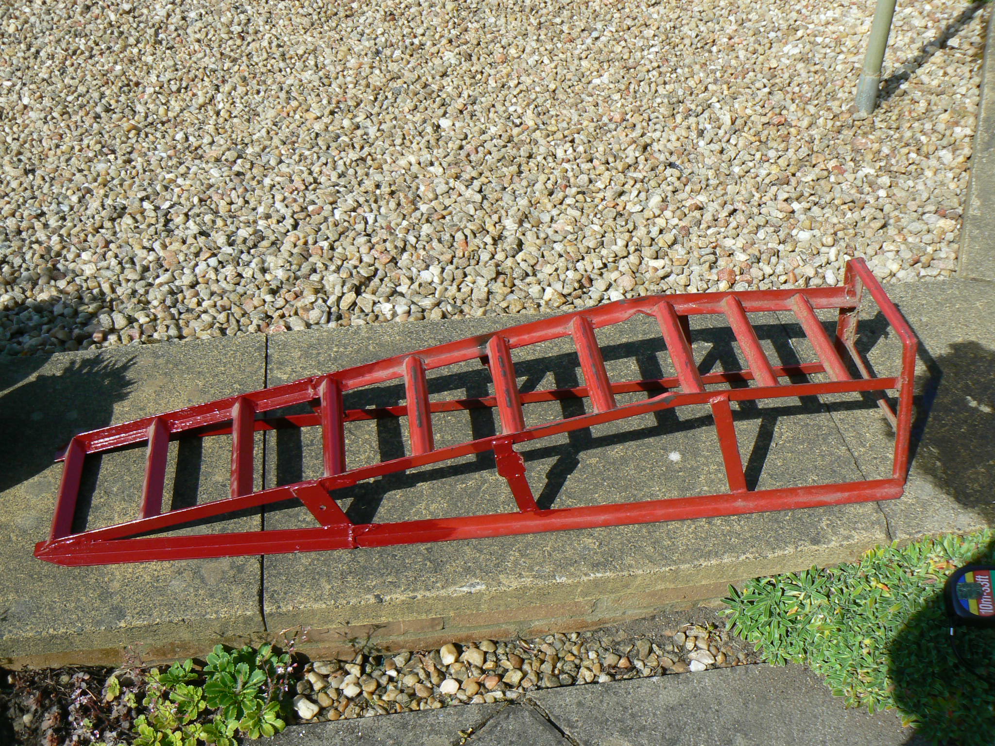

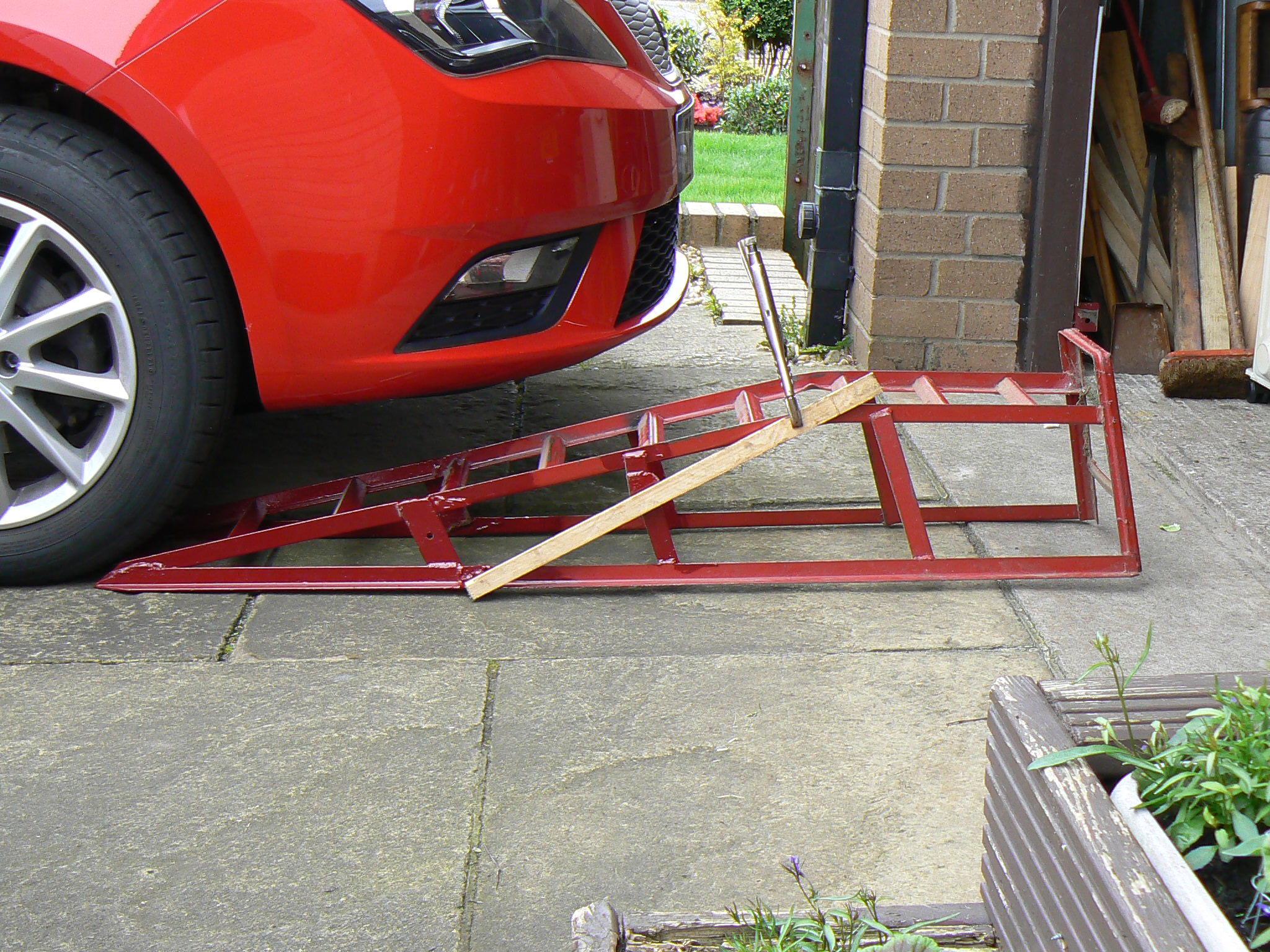

I've not, so far, ever tried using my ramps with a Panda - I tend to default to axle stands for the flexibility they offer over ramps. However I suggest you try the stands against the car before you buy. Why? because many modern vehicles have such an overhang - front bumper/valance - that the ramps are too steep to clear the bottom of the bumper before the wheels are on the ramps. Many years ago I extended mine to overcome this problem and these pics may help you understand:
The piece of wood illustrates the ramp inclination before extension. You can see how the ramp would come into contact with the bottom of the Ibiza's bumper before the wheel started to climb the ramp.
Here, because I didn't quite have a paint that matched, you can see the bits I welded in to reduce the angle:
Many a car has lost a bumper because of this exact problem. Including my old 1993 Mondeo which had an RS Body kit on it. (a factory option) which hung down very low, went up ok with a little scrape, but on the way back down it basically pinched the bumper between the car and the ramp and tour it off.
