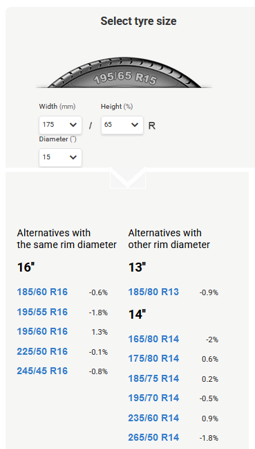

Sites like oponeo.co.uk provide accepted tire compatibility calculators:
As you can see, the circumference of the listed tire sizes is not even close (+/-2%) one to each other.
As stated by @Herts Hillhopper, you can't put 15" tires on 14" rims. Nor the opposite.
