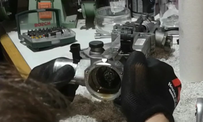

Option 2 : Full, long term fix is to take the robot out and clean the whole "barrel" inside and then re-grease it with high quality, wide-temperature-graded synthetic grease . You can see this being done here:
screenshot:
Option 2 best made by a mechanic, unless you really know what you are doing, followed by factory calibration in
