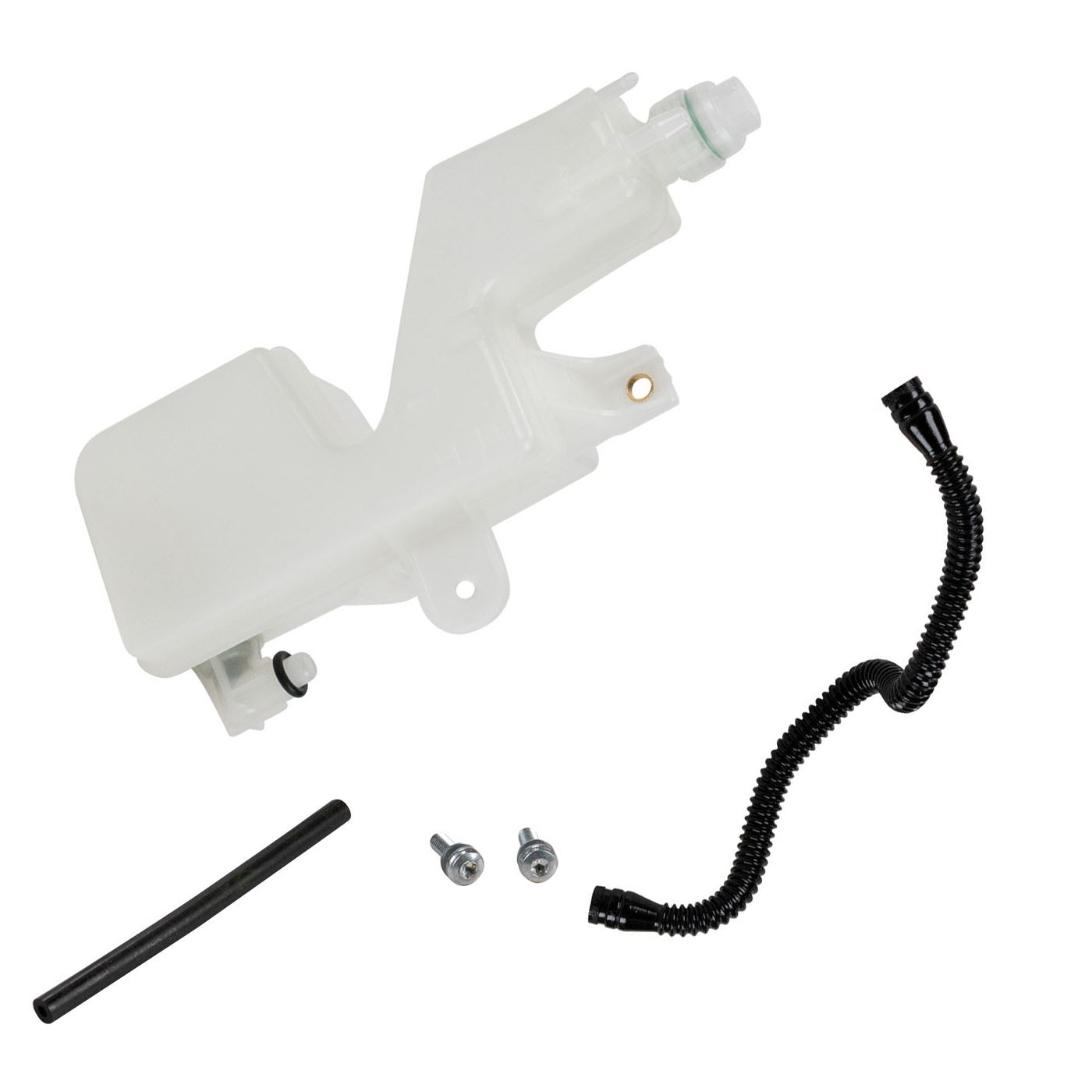

Hi, I'll see if I can help you...
The dualogic fluid tank has a "waist" section moulded onto it to allow access to the gearbox oil filler. Perhaps when you insert your hose it's hitting this waist?
Here's a picture not as it's fitted on the car. Filler cap is top right. Is your hose hitting the angled piece of plastic before it gets to the fluid below?
Hi and thanks for help.
I marked photo of my tank with arrows where i think hose is hitting.
That section is right under filler cap.
Ok, thanks for your photo. It does look like something else obstructing the hose🤔
Sorry I can't be more helpful, please let us know how you resolve the issue, I have all the fluids on hand and intend to do our Panda one rainy day soon.
If it were possible to change the oil this way, it would be the easiest for me, but I don't know how to get around that part at the top, so for now I'm giving up on this method until someone comes up with a way to change fluid on this way.
