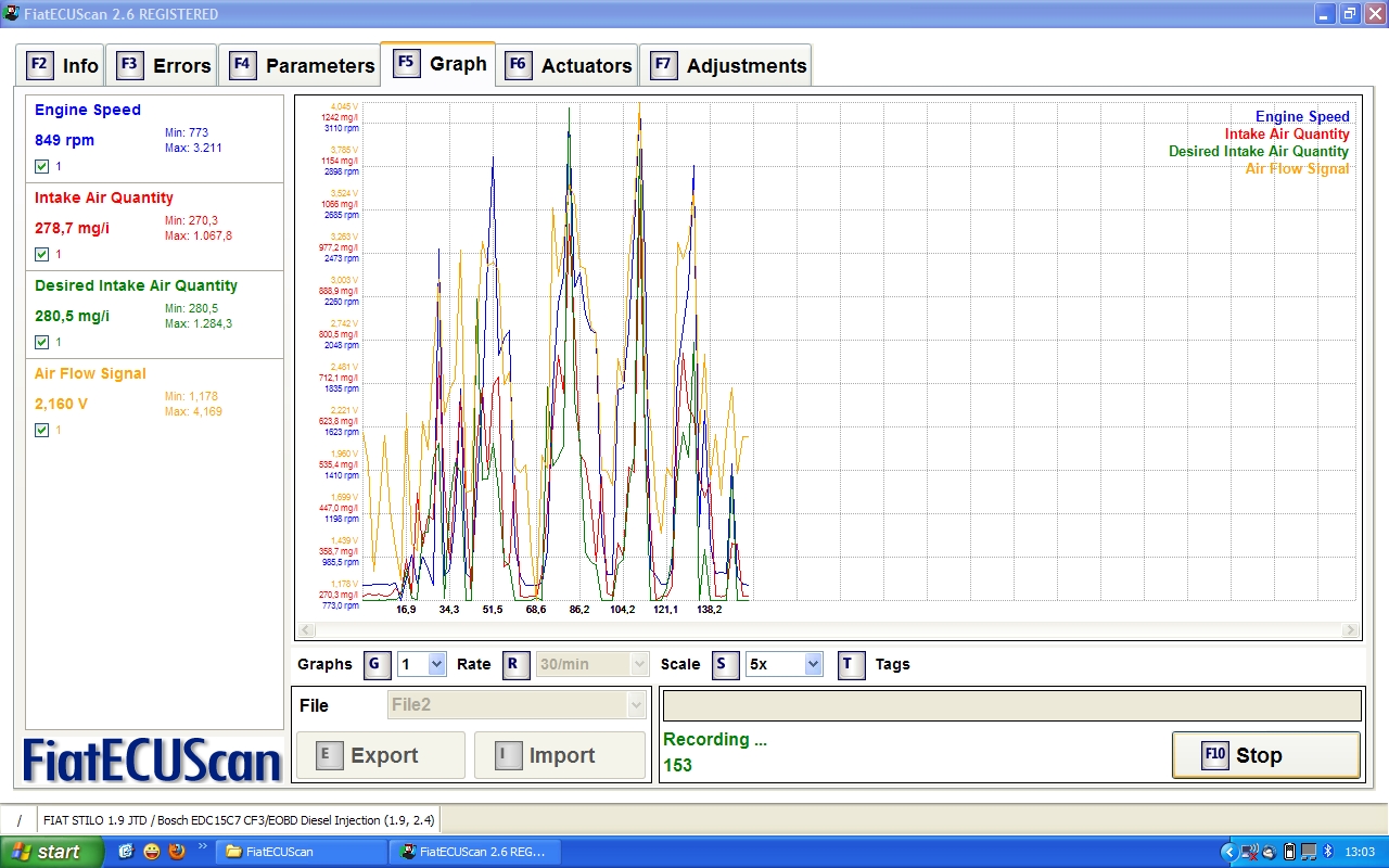

after a few miles, the engine warmed up and began to do his usual jerky moves like hell (around 2200-2300 rpm, and below-1600-1700rpm)
-->> i disconnect the MAF (my cleaned old one ) and the car works 90% the same with him connected, and no result, still there that interrupted working .
-->> i disconnect the EGR jack, and no result, a good improvement of acceleration(i never seen on FiaTecuScan 100% rate of working for my EGR, only maximum 47% ??!!!!!).
so, no results, the jerky moves are there...wtf?
MAP sensor? any idea?should i try cleaning it ? or how can i test if MAP works?
Although, no errors on my dashboard after i disconnect those 2 (MAF and EGR), but i think are stored in the Ecu, tomorrow i'm gona read and deletel them.
any ideas???
