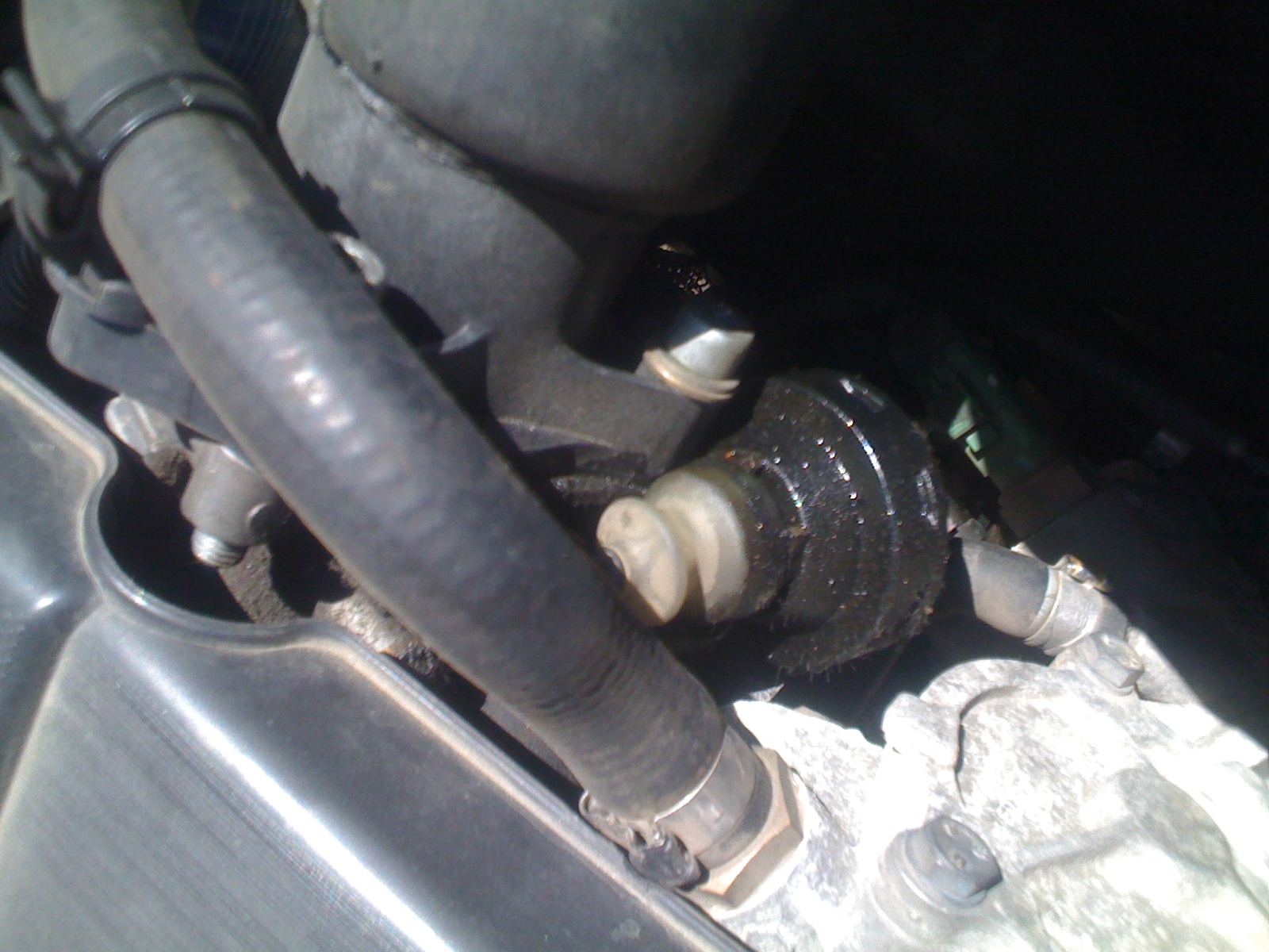

discovered some oil here

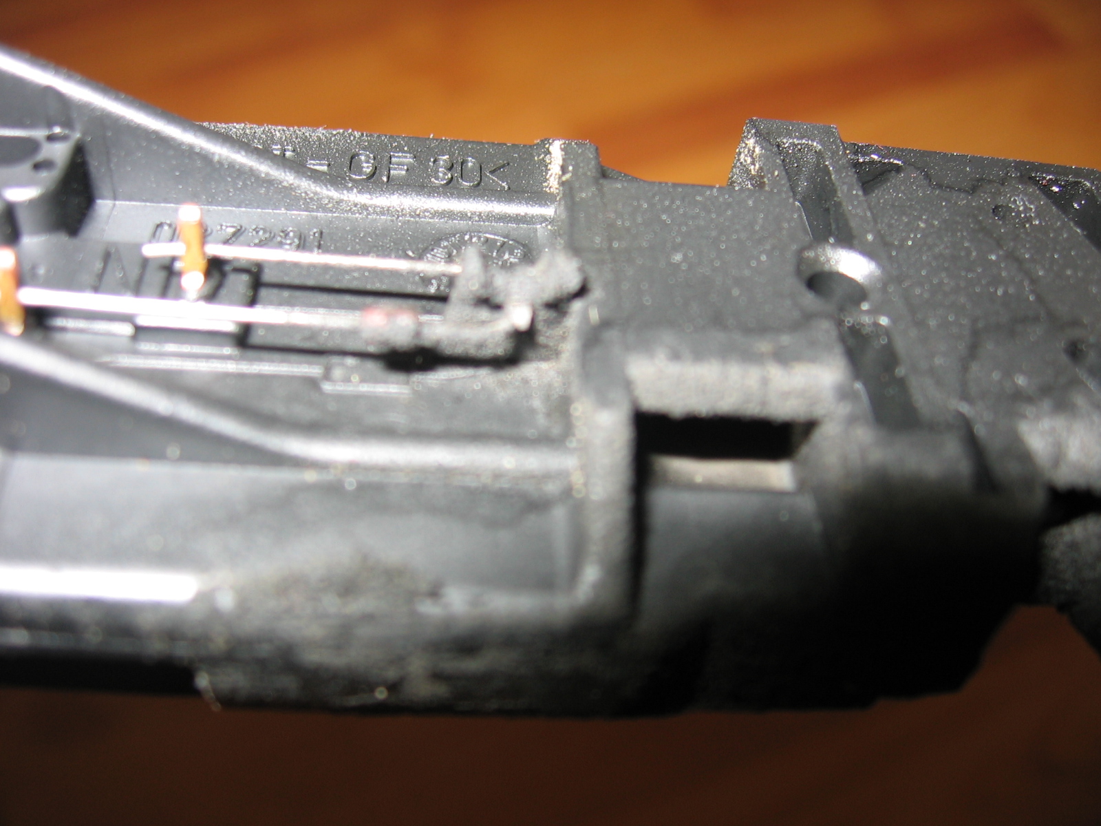

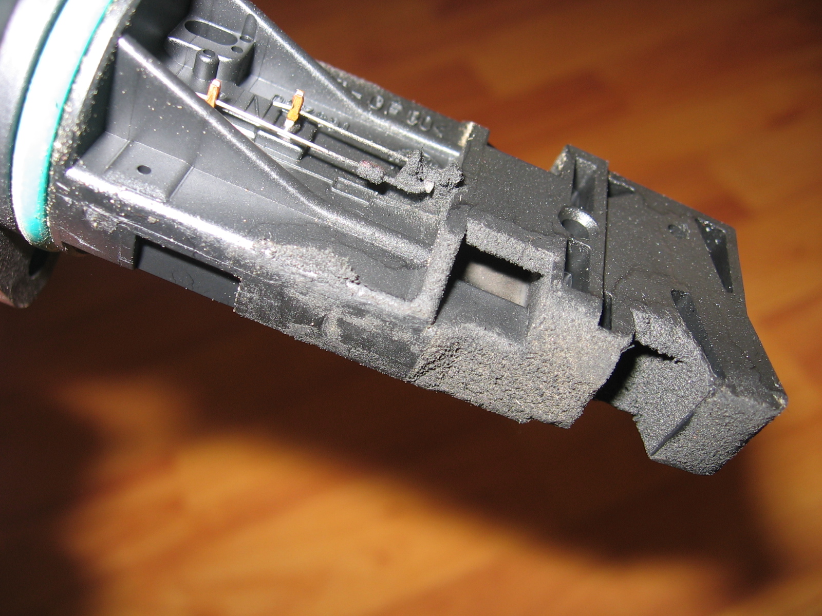

so, i replaced it with a new one(i had this ocassion, very cheap, Bosch, original, throught a friend)
so, i will post the old maf dirt, but i came with a question: should i change that maf case too? i changed only the sensor, and i have too the case of the new one, but i didn;t put it, just switched the sensors

i have the housing for the new one, but i changed only the sensor, keeping the old housing on the car.
my question was that should i change that housing too? or changing the sensor is enough.

Its ok to replace just the MAF Sensor and use the original Sensor Body, just check there is no debris stuck in and around the mesh.
