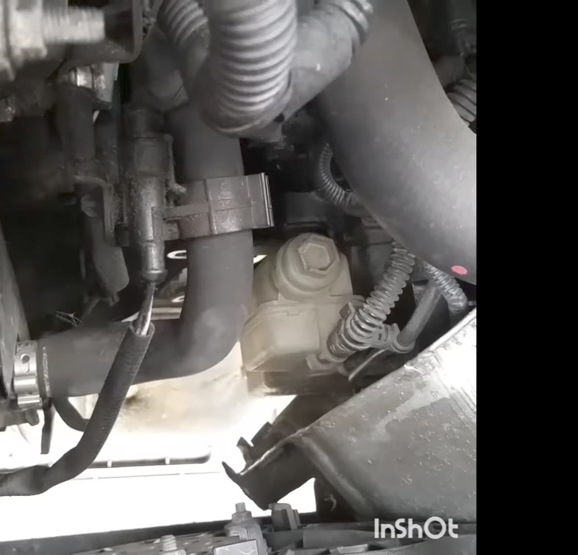

Sound like the actuators, here's a 500 going through a recalibration
Visual inspection for leaks and check the hydraulic level is a good first move

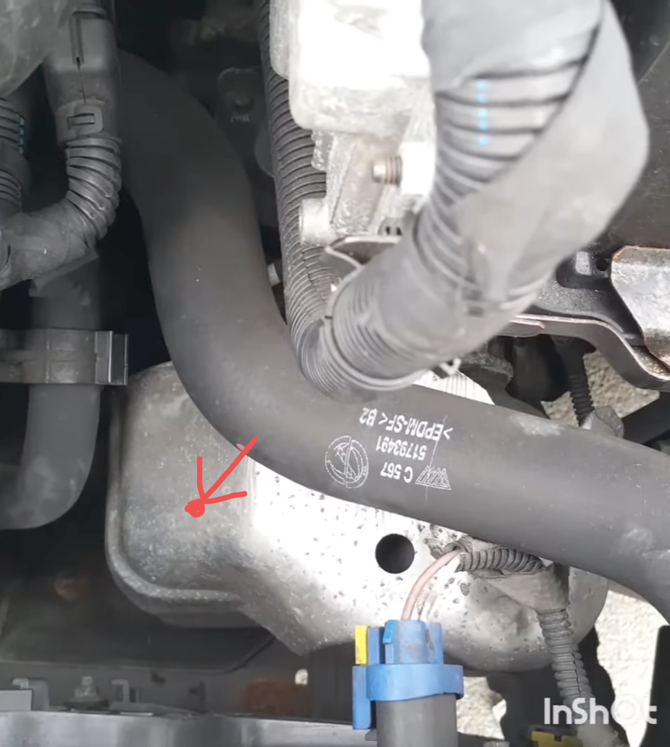

Now the bad news, unless someone has previously left the cover off, it's not straightforward to check
It should be under this cover
Which on the the 500 will need the engine undertray removing

Need to work out what to do next without any diagnostic software
View attachment 457176View attachment 457177
Hmmm, it does sound like actuator but it's quicker and doesn't have beeping alongside it. I'm guessing i need a compter to recalibrate the actuator?
Oh, that makes thing more difficult...
The video was just to show the noise the actuators are being driven via the diagnostic software
In this case the software is the full version of alfaOBD which runs on an android tablet or android phone with a cheap elm327 Bluetooth dongle
The same thing is possible with MultiECUscan and a windows tablet and the same elm327 dongle
There are other options
Both would also allow the monitoring of the hydraulic pressure which should be around 50 bar (725psi) fluctuate a bit as gears are selected then back to 50 when the motor kicks back in, only drop a few bar when the engine is switched off
