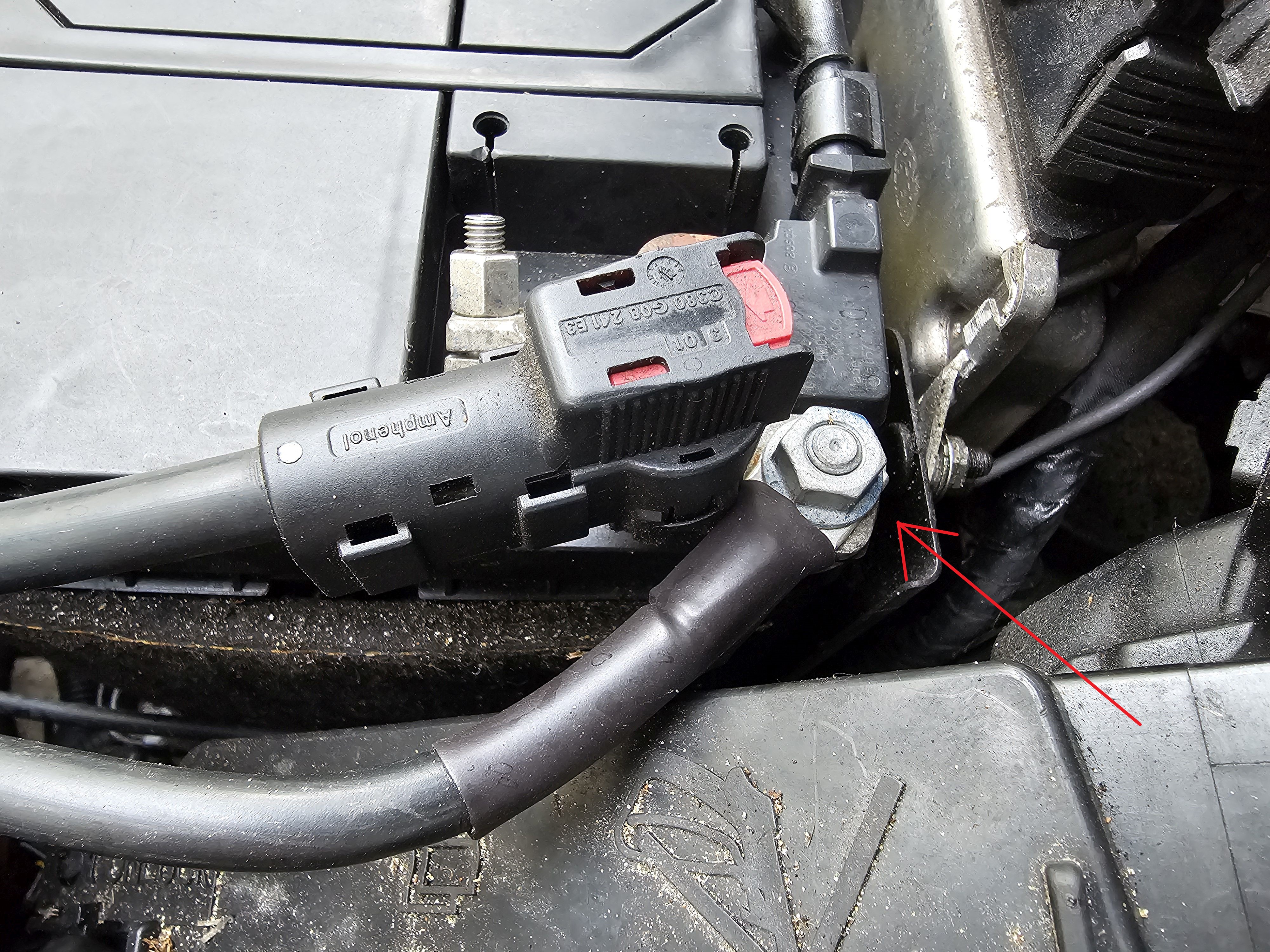

first thing to check is the main earth cable under the battery tray its a well know as a problem area! .
To give yourself an idea if this might be the problem try connecting a battery jump starter lead between the battery negative terminal and a good earthing point in the engine bay and run it like this for a few days to see if the problem is gone if so then replace the main earth lead!.

Battery then Earth cable will be my 1st moves
I had this while in europe last summer, I didn't worry because I had a compact jump starter in my toolkit, but why it started 30 seconds later baffles me.
An additional earth cable...
Could solve many of those questionable electrical problems, it has for me.
IMO, the manufacturers system is poor. The addition of another cable is a cheap, but solid fix.
