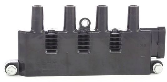

SOLVED!
Lets just go through what was done.
1.) MAF/MAP = little change. Maybe due to worn out sensor but did not solve the issue.
2.) Only checked the idle valve because of maybe restricted air flow.....worked fine.
3.) Changed sparkplugs and cables because of milage (60.000 miles). No change.
4.) O2 1 + O2 2. Both cleaned and swapped around with no change. Found a used one at the local car dump (from a Punto 1.2). little change
5.) Changed electronic distributer with on found at local dump. BIG Change but not quite there.
6.) Changed camshaft sensor with one found at the local dump.....bang on = Solved the issue entirely
So thanks to the crashed Punto at the local dump with doner parts the car is running perfectly again. I would also like to thankyou all of you guys with good input and ideas. And by the way ALL parts changed on my car are Champion and/or Hella
Have a great day :)
Ignition coil in proper english....sorry :)
see attached foto
