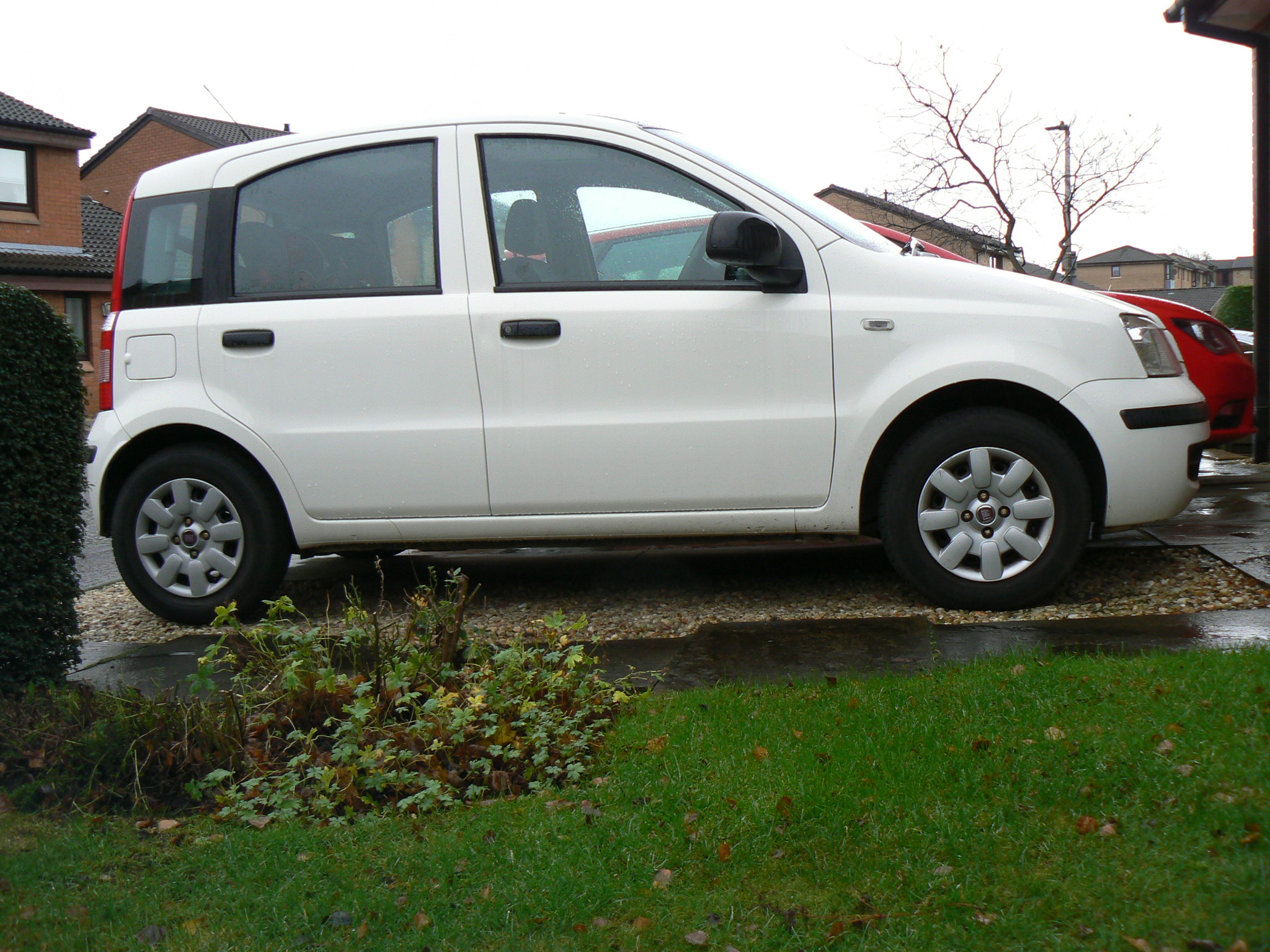

As the springs are most easily assessed I'd be looking at them first. So, first off, when you're out and about, look at a number of similar cars in the street. look at the tyre clearance with regard to the top of the wheel arches front and rear. If the car is parked at the curbside you might risk sticking your fingers in between the tyre and top of the wheel arch as a rough measurement of what the gap is. - be prepared to explain yourself if challenged. However, I've done this in the past and never been challenged. Once you've observed a number of vehicles you should have a good idea of what the typical ride height is for your vehicle so now, park your car on level ground and do the same check on yours. Springs do tend to settle. (our Becky - 2010 Panda - had this problem with her front springs when I bought her. Many of the 169 models I see are a bit down at the front. keep your eyes open when you see one and you'll see what I mean) However it's worth knowing that some manufacturer's models ride a little higher at the rear than others)
Here's a picture of Becky after the new front springs were fitted, see how the wheel arch clearances are pretty much identical front and rear.
Keep an eye out in the street and you'll see many which are definitely down at the front. If it's down then the springs have settled. If just by a little then I'd not be worrying, however if very noticeable then, for this reason alone, I'd be replacing them.
If it passes the "sagging" test then a closer examination of condition is needed. Is the spring pitted with rust - this causes stress concentrations which make the spring much more likely to snap on something like speed bumps and potholes etc. Lastly check to ends of the spring very carefully. every now and then you may find a spring where only a small piece of the end of a coil has snapped off. this may not cause any great difference in ride height so is difficult to see by just checking wheel arch clearances - you need to jack it up and have a good look.
So, if the ride height looks acceptable and the springs are not heavily rusted or otherwise damaged, I'd be happy to continue with them. - inspect for rust very carefully as springs can look good on a casual inspection but have just one small area heavily rusted - perhaps where a stone etc has damaged the protective paint coating and allowed a very small area to become heavily pitted.
That's an excellent test, i'd never have thought about that. And I'm going to be on the lookout for that.

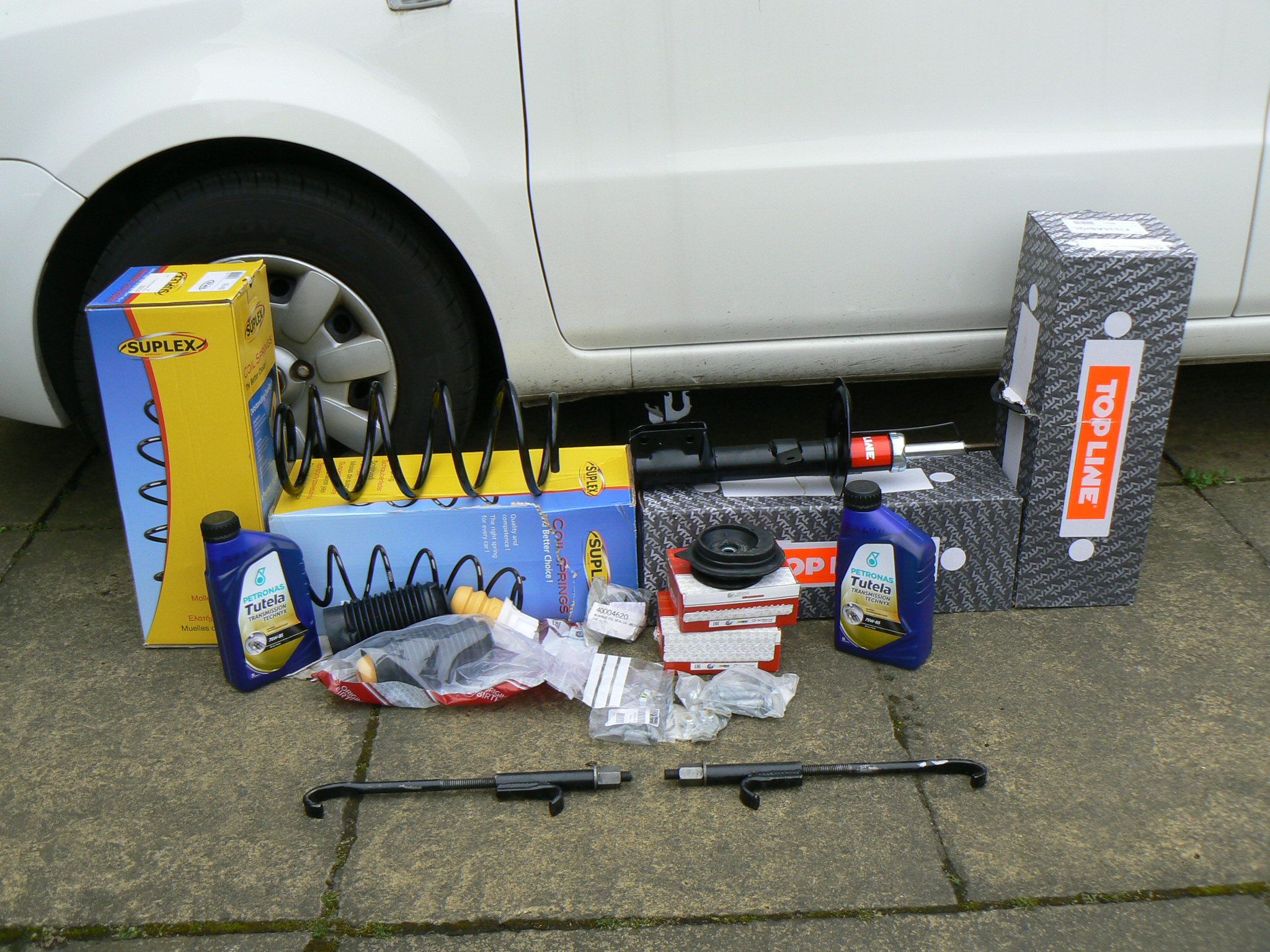

Oh, and there you can see the shockers were "Topline" 2019 that was and they're still going absolutely fine without any sign of leaks etc.
