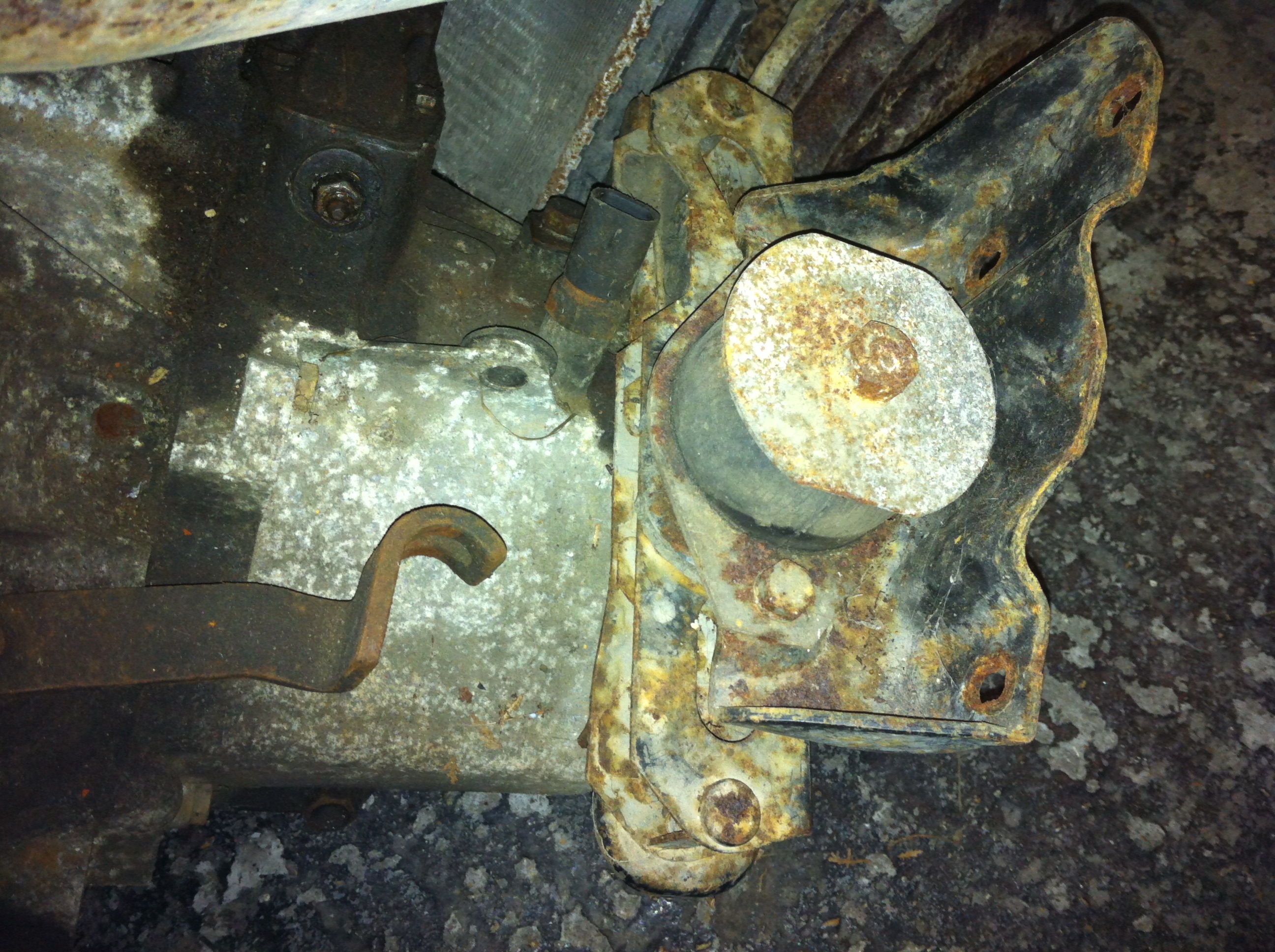

Ever had one of those days when you feel like you are trying to push water uphill.?
As a treat I had planned to fit the engine & gearbox today.
This is an engine, gearbox and car that have never been as one before.
The bits necessary to constuct this jigsaw are in various ice cream tubs and boxes. And I don't know what they look like........
It began as trying to fit the eng and box seperately from above and quickly became fitting the eng/gearbox as a unit from below.
At which point I realised that I had two starter motors, neither of which seemed to be suitable.
As I pressed on regardless nothing got easier.
Evetually I did get the unit installed but I have eithe got the gearbox to body mount upside down or it is the wrong one.
Ditto the lower gearbox mount.......... And the 4x4 output shaft doesn't look like it is pointing in the right direction.
The whole unit seems to want to go 30mm toward the nearside.
Will I end up making my own mounts or will this sort itself out.
