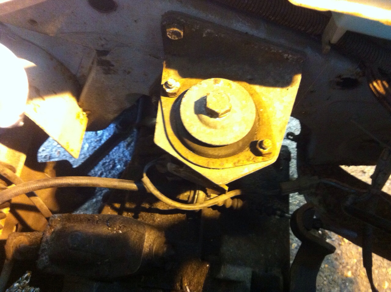

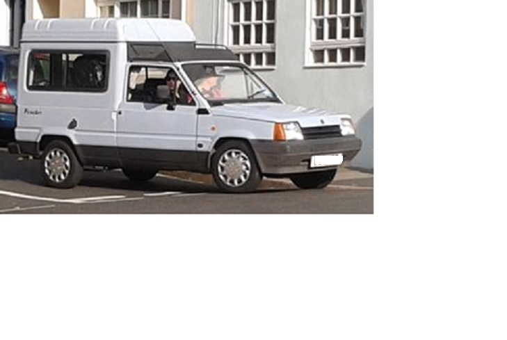

Hi,
I have a Seat "Panda" Terra 1989 in beautiful sky blue and now I am having a bit of a panic that I have taken a bit too much on :eek:!
I am REALLY struggling to find the correct fitting gear mounting (I have bought two) and always struggle to find parts. :bang:
The first was for a a Panda 750 but the holes were two big. the second was for a fiat 127 (FEBI 12345) but the actual size was too big.
I loved seeing you so competently do up your little red soft top. Could you give me some pointers i.e. engine numbers or part numbers to look for or people to ring for help?!
Weirdly I found an engine manifold and starter quite easily, but this has me flummoxed!
Next on my to do list is get the door sorted before it falls off because of rust :D
Much appreciated in advance,
PHIL.

if it uses the 903cc petrol engine most of the stuff from a 899cc fiat cinquecento would fit (so long as it was mechanical like a starter, alternator or water pump) it is the same engine with a different cylinder head fitted.
you can look for parts for a Seat Marbella, though the gearbox mounts looked identical to the ones found on a Fiat panda dance.. or any other car panda shaped with the over head valve engine fitted.
i'd be on the look out for a seat marbella gearbox mount or a cinquecento one. to see if the look the same as the one fitted to your seat.
does this look like the original one?
http://www.ebay.co.uk/itm/FIAT-Cinq...arts_Vehicles_CarParts_SM&hash=item418929042f
Hi,
Thanks for the reply, that's really useful. :worship:Yes it is a 903 petrol, alt. I've posted a pic of the current one in situ (not great) but it's in desperate need of replacement! Right on the hunt I go . . .
Thanks!! :D
