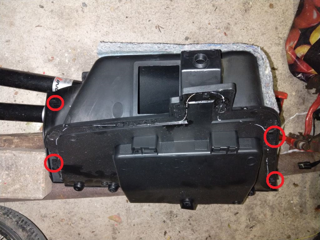

Next carefully pull the parcel try outwards to disengage the plastic clips marked below:
