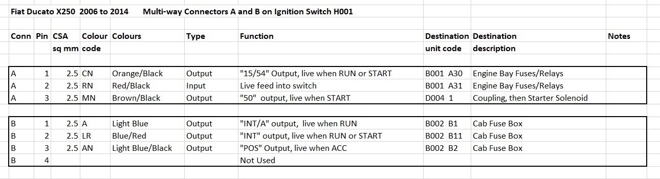

On my 2006 x244, the wiring plugs directly into the ignition switch. The switch has two connectors, a 3 way and a 4 way. On the three way connector, the centre pin is the 12V supply with the other two connectors being used for the starter motor, and ignition. On my vehicle the ignition wire is the orange wire. Removing just this connector would normally stop the engine. However I am wondering whether the problem may be in the engine bay fusebox, which is a known source of problems. Hence my comments in post #5.

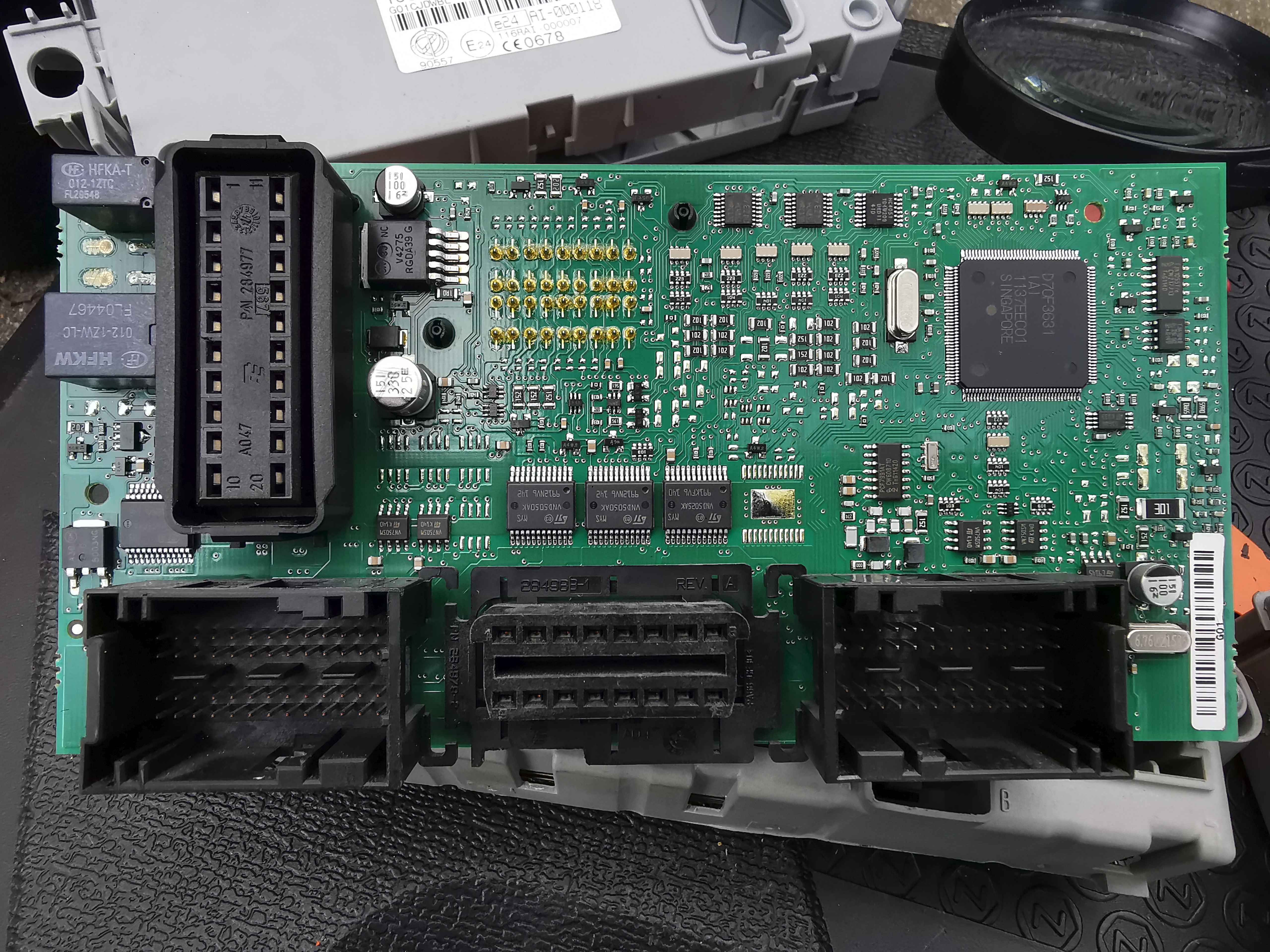

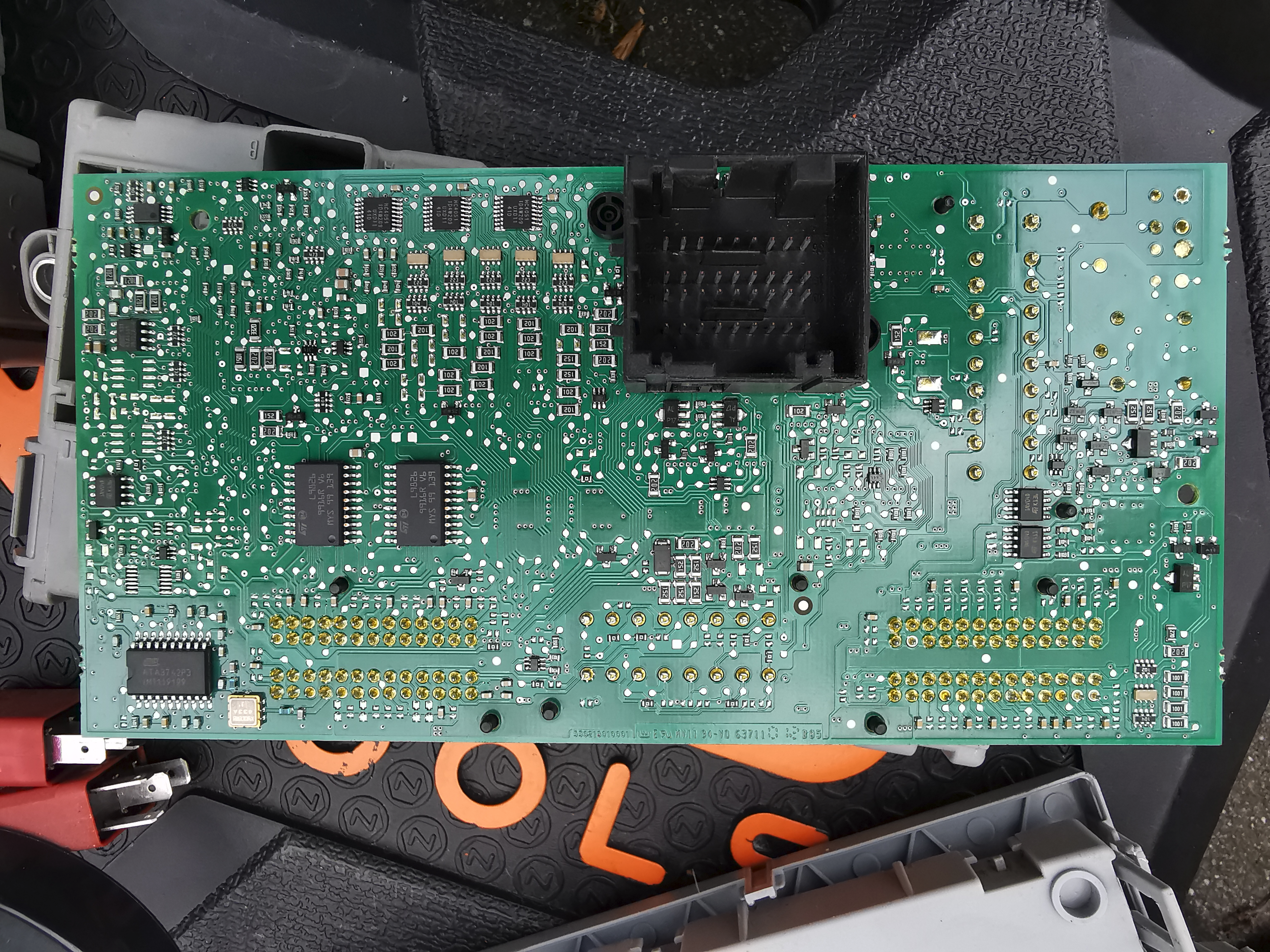

FYI, that's how the BCM module (the one by the driver's knee) looks like in the inside (I have not dismantled the ECU though, so I have no idea if it looks similar, or not at all, but it should more or less be the same type of PCB to deal with):
