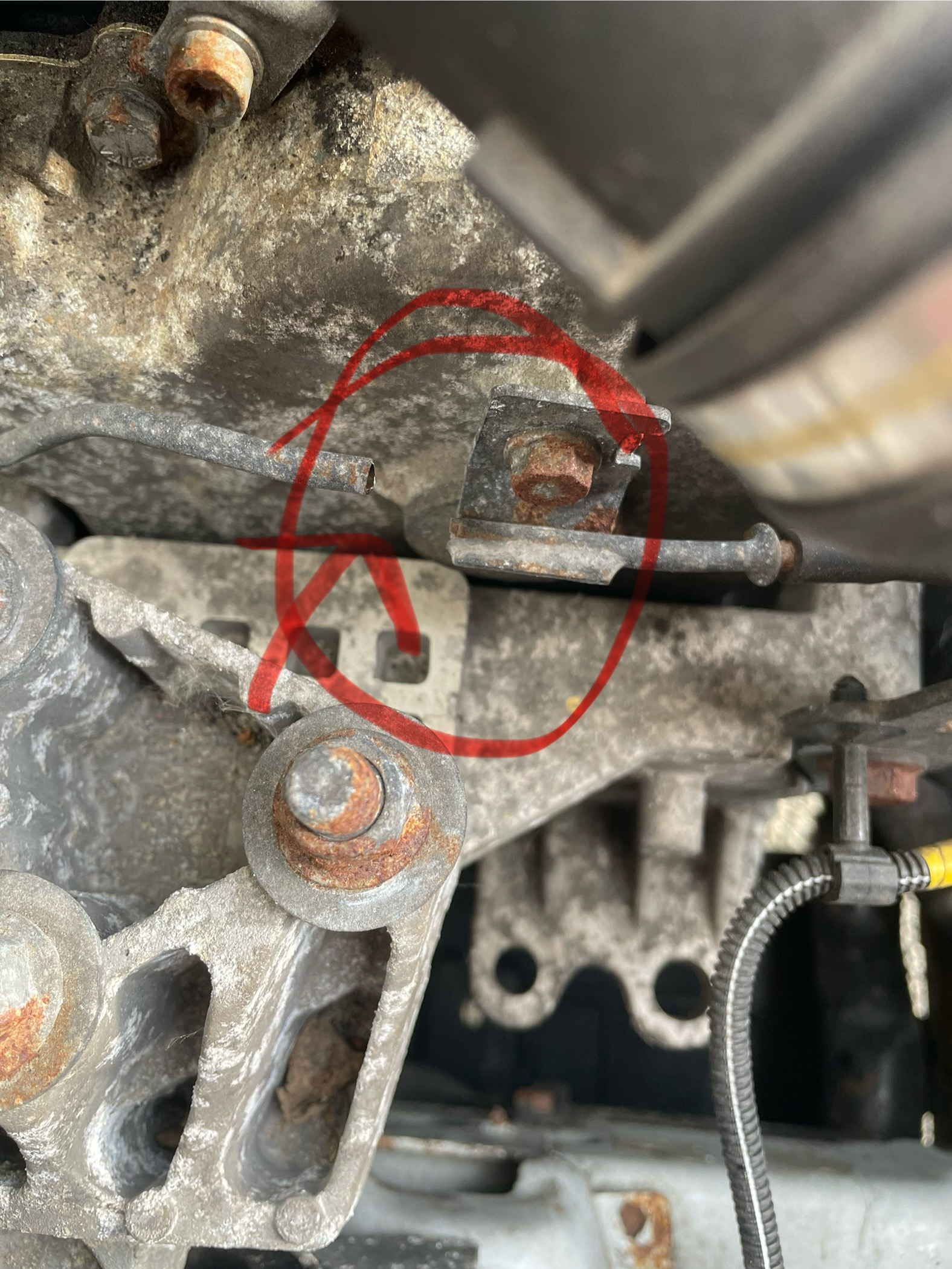

I ended up leaving the van for a couple of days on the drive. I couldn't be bothered to look at it. However, for some reason today the sun was shining on the bonnet area so I just opened it up and had an inspection of the small hoses that connect to the turbo and loop around the the engine.
Lo and behold I found a broken/disconnected pipe. I've attached a picture - it blends in well with the rest of the engine so I didn't notice it at first glance, it was only by following and feeling the hoses/pipes that it became apparent.
