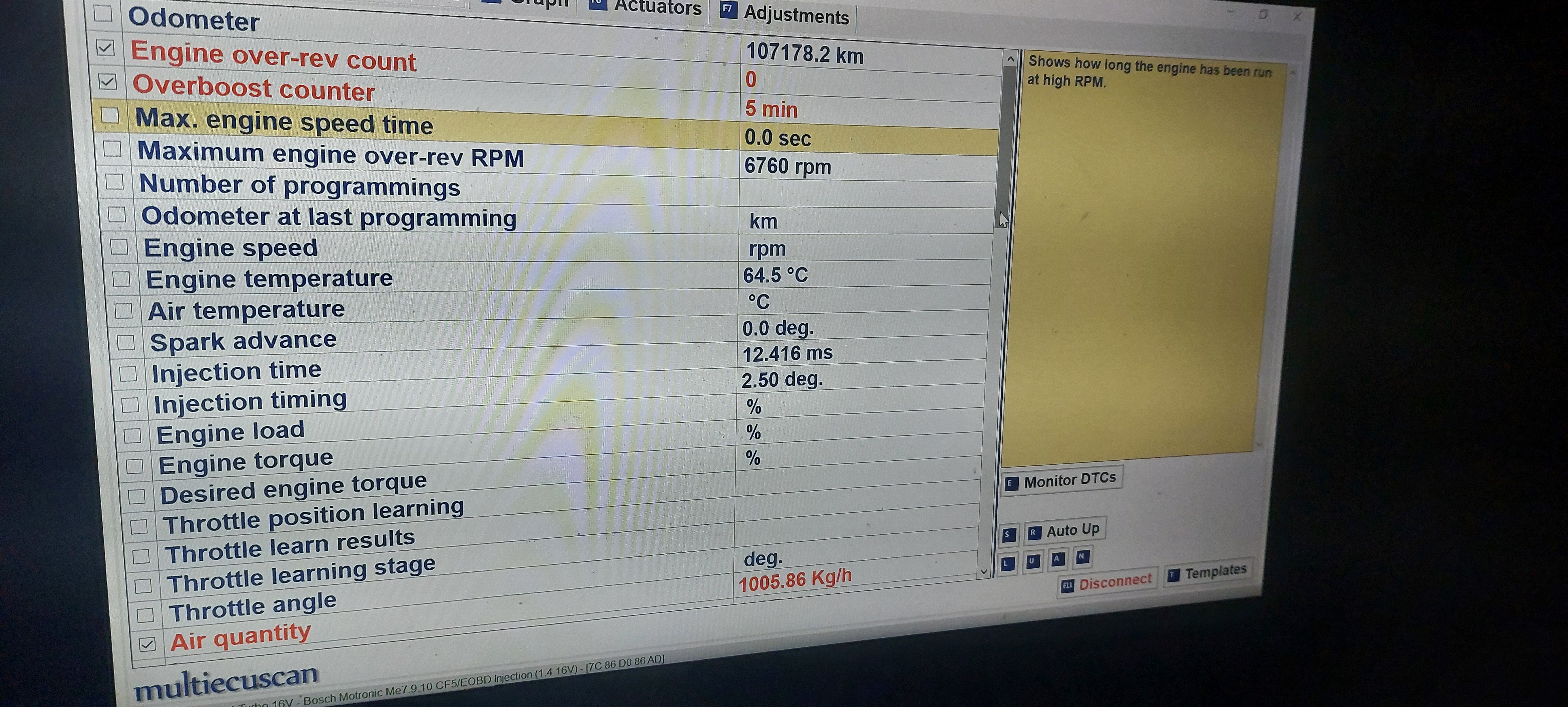

Few datas, some may be old, as I've never revved the car over 4k rmp:
View attachment 456082View attachment 456083

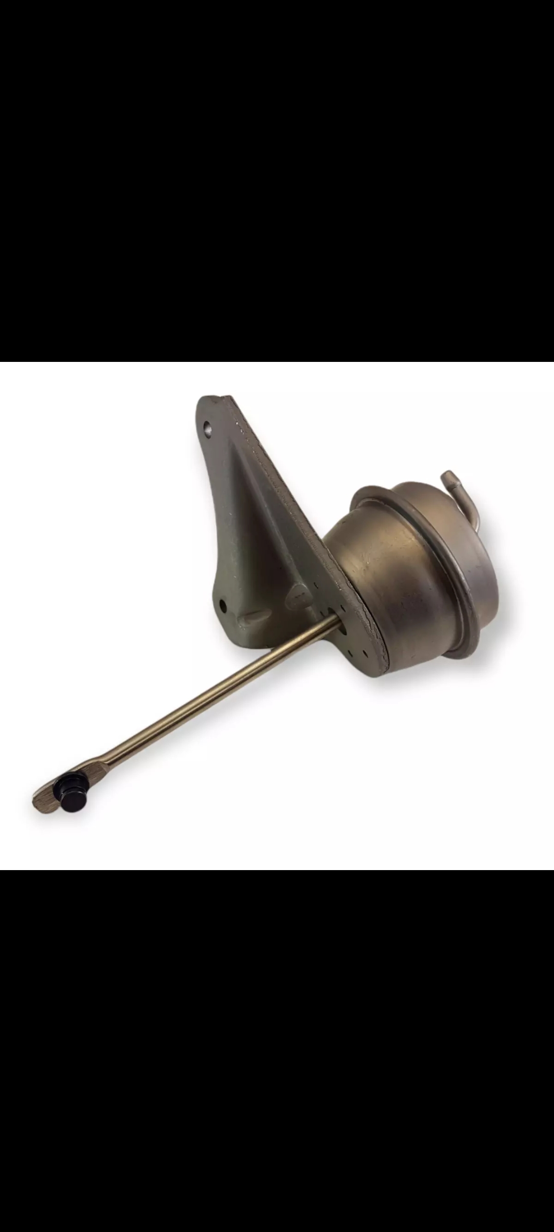

And this is the wastegate on top of Turbo:
Can these turbo issues shut the engine off so suddenly? I've just read, the chip-tuning can cause this too, as pressure is too high.

The turbo getting hot as you say might not be a problem. Isn't the part getting hot that part that exhaust gas goes through?! If it is, it's normal for turbo to be hot, the exhaust gas being very very very hot.
The turbo issues can suddenly shut the engine off, yes. So you should investigate that lead.

That side of turbo supposed to be the fresh air intake, not the exhaust side, so it shouldn't get too-hot to touch when the car just idling.
Signs show pressure is blocked around the turbo, so I'll be busy today with that.

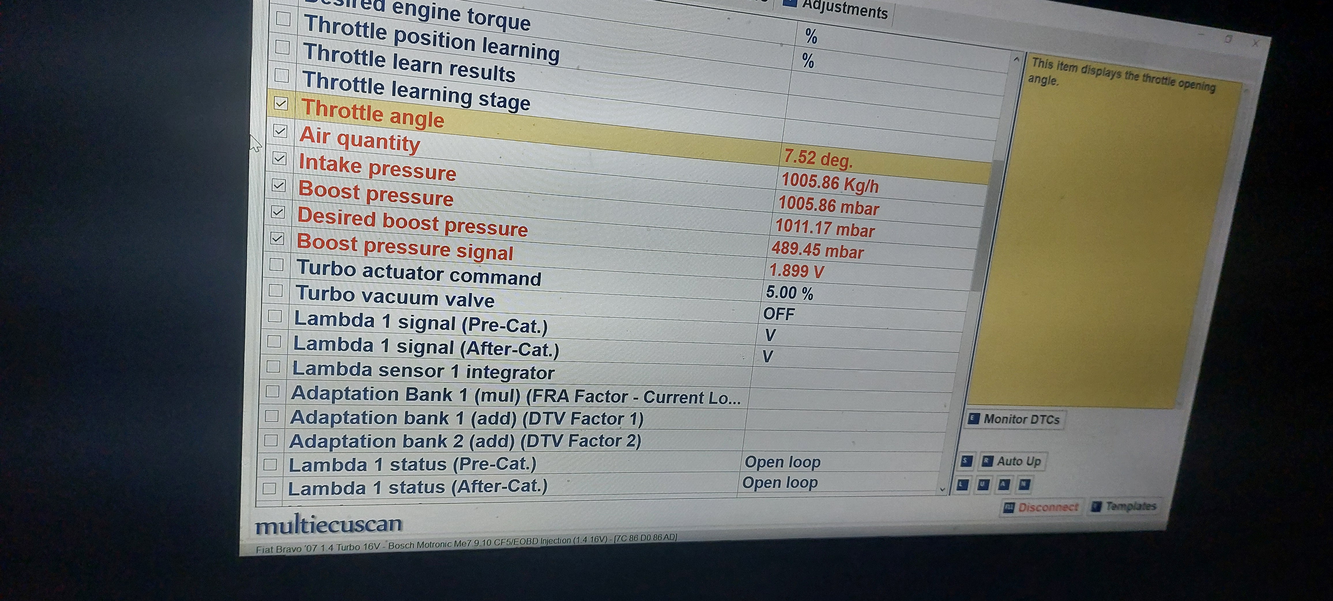

I've been notified by a forum member, the MES shows double the normal turbo pressure.
Desires Boost pressure shows around 490, the actual Boost Pressure is over 1000.
How normal is that?
MES shows these high values slightly fluctuating, even without engine running.
I've noticed that, too. I don't know how good or bad that is, I've also noticed you earlier mentioning the chip tuning, that changes things.
Normal pressure for standard turbo is between 400 - 1000 mbar.
What was the engine RPM when that data was recorded, do you remember? Was is on idle? If it was, the pressure is high. "Turbo actuator command" 5% also indicates the pressure being too high, as in reality it is about the max (~1000 mbar), 100%. So how come the actuator is only 5%?
The car was idling when I took that picture.
Not sure how the chip tuning has affected anything.
That's interesting, the issue things like that don't get flagged up unfortunately, so even on engine idle, it'd be 100% ? It may have something to do with the Bypass valve, it used to have "P0039 Bypass valve performance" fault code, it's a new one now, I'll test it tomorrow and see how the values change. Cheers
