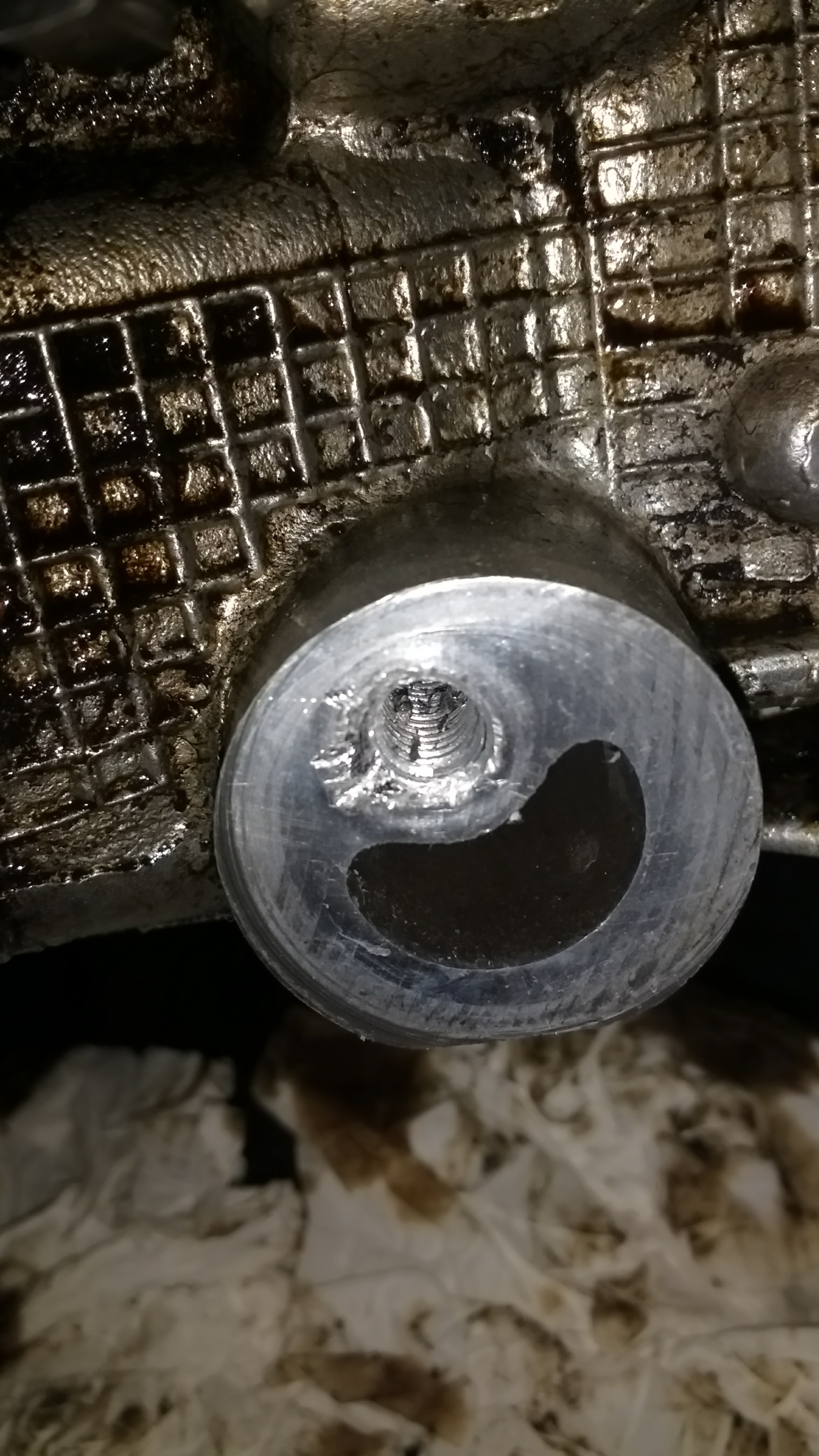

Quick tinker under the bonnet yesterday over lunch time, to swap timing belt tensioners back to the new one after realising that I'd probably buggered the old one (currently installed) by spraying it with brake cleaner before reinstalling it a few weeks ago (wasn't thinking) which I was hoping would be the cause of my rattling/grinding noise.
Anyway, was putting the new tensioner on, tightening up the nut whilst holding the tensioner taught with a spanner, and in my haste/enthusiasm I sheared the tensioner stud clean off in the cylinder head. :bang:
Completely flush with the head with no exposed threads to help extract it. Fun.
After the nauseating panic wore off I realised the cylinder head would have to be removed to get enough access to extract the stud, and I'd be getting the train to work for the rest of the week.
As I'd only just pulled up outside the house in the middle of the road/culdesac (was meant to be a 2 minute swap), I had to basically parallel park the punto ON FOOT whilst dealing with the camber and slope of the road. More fun.
So then spent around 2/3 hours yesterday getting down to the cylinder head bolts and got the head off, also managing to line up a garage locally who would consider having a look. 5 minute walk and dropped the cylinder head into them in an Asda bag-for-life with some cardboard in the bottom,was told they probably wouldn't be able to look at it til late Monday/early Tuesday but guy seemed confident he could deal with it.
Don't have a drill with me here in Maidstone, and even back at my parents I don't have any thread extraction tools etc. other than the M8 helicoil kit I used for the thermostat bolt holes.
It's probably within my limited skillset to do myself, and the garage will probably shaft me 2 hours labour for a 15 minute job, but need it done quick and was fed up at that stage.
Have been endlessly Googling to find a replacement part for the broken/sheared stud, closest I got was through this thread which gives the part number through ePer (46548456) but no length:

Only photo I got at the time, just showing the sheared stud.

That stud should come out easy enough, good vice grip if you have room. If not something like this, As for the belt, there are different types of teeth, square section and rounded ones, are you sure the belt matches the teeth in the cam, crank and waterpump?

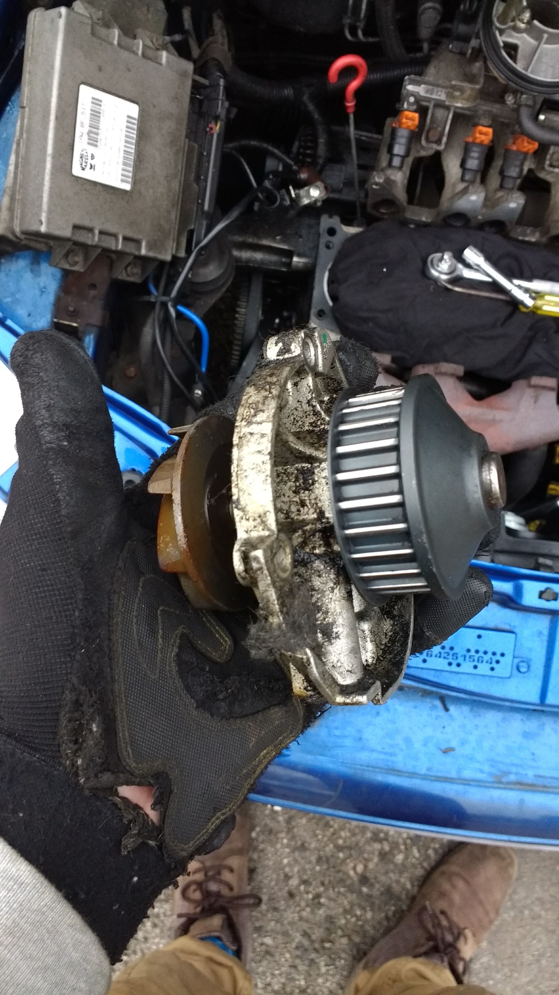

As diggers says, there is 2 different belts for the P75, its pre and post a certain engine number but can't remember what those numbers are off top of my head - I'll look 2moro as just heading to bed now. What you describe, wearing of the teeth rather than the edges of belt sounds like there is a mis-match in parts somewhere.. Not sure if you had the wrong belt that it would stay timed and looking at that pic (hard to tell for certain of course from a pic) it looks like the water pump peaks are narrower than the troughs on the belt (there is more than one water pump as well). My feeling is that the water pump maybe the wrong type but the belt is correct.
Without reading back this is pretty much exactly what happened to the last belt, and if you replaced parts with like for like then it will just be happening again if that was the problem all along. I'll do some looking at part numbers and stuff on the morrow if i find a half hour to search ;)

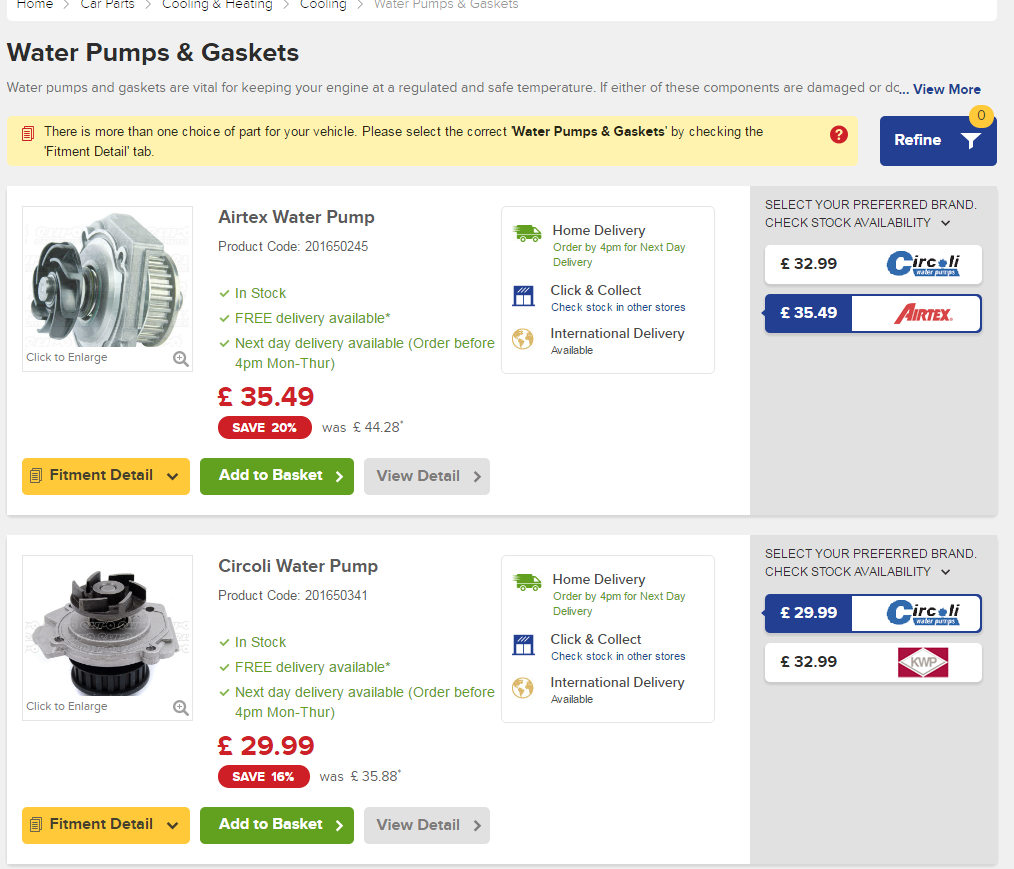

Yeah having a look on ECP at the 2 different water pumps for my reg number, that's got to be the problem. Just by looking at the pictures side by side I can tell that the pulley on the other pump (not the one I have) better matches the teeth on the camshaft pulley.
There's also 24 teeth on my pump, and 20 on the one I need
Will probably go with the KWP unit rather than Circolli, just as it has bigger/more impeller fins
Thinking of it, I have always had trouble getting the belt to 'grab' the water pump pulley properly....
Will have to order a new timing belt as well, might as well get a new tensioner too. Luckily they've still got the JanSale on!
No exposed threads for vice grips unfortunately, it's with the garage now but looked like an extractor tool/drill out job, hopefully will hear from them later today.
They are dear enough, Look here...http://www.mister-auto.ie/en/water-pump/fiat-punto-176-75-1-2-73hp_v3797_g1260.html
The tool is a stud extractor.

That said, in this circumstance Shop4Parts are cheaper, just had a look. Cheapest Mister-Auto is on UK site is £34.70 delivered for the pump and belt (bolk and dayco respectively)
S4P is £28.92, same belt but bugatti branded pump which I've used before, very nice quality. Also that price is not including the forum discount - think you have to donate to get access to the forum discount codes but can be any small number, literally anything and you get that donated member under your name like below my avatar. But S4P is 10% off everything.
S4P part numbers I have got are S4P546 for the timing belt and S4P673 for the pump.

No luck finding a replacement tensioner stud but I've ordered a 45mm long M8 stainless steel stud off eBay which should do the trick

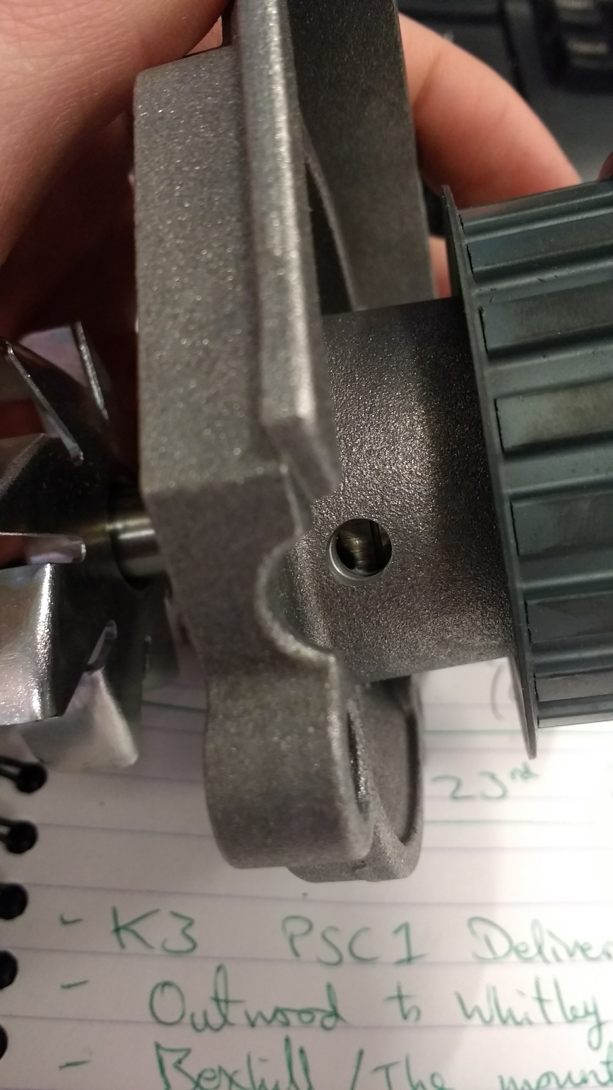

This hole in the new pump isn't on the other one, puzzled as to what it's for but oh well, hope it's not important!

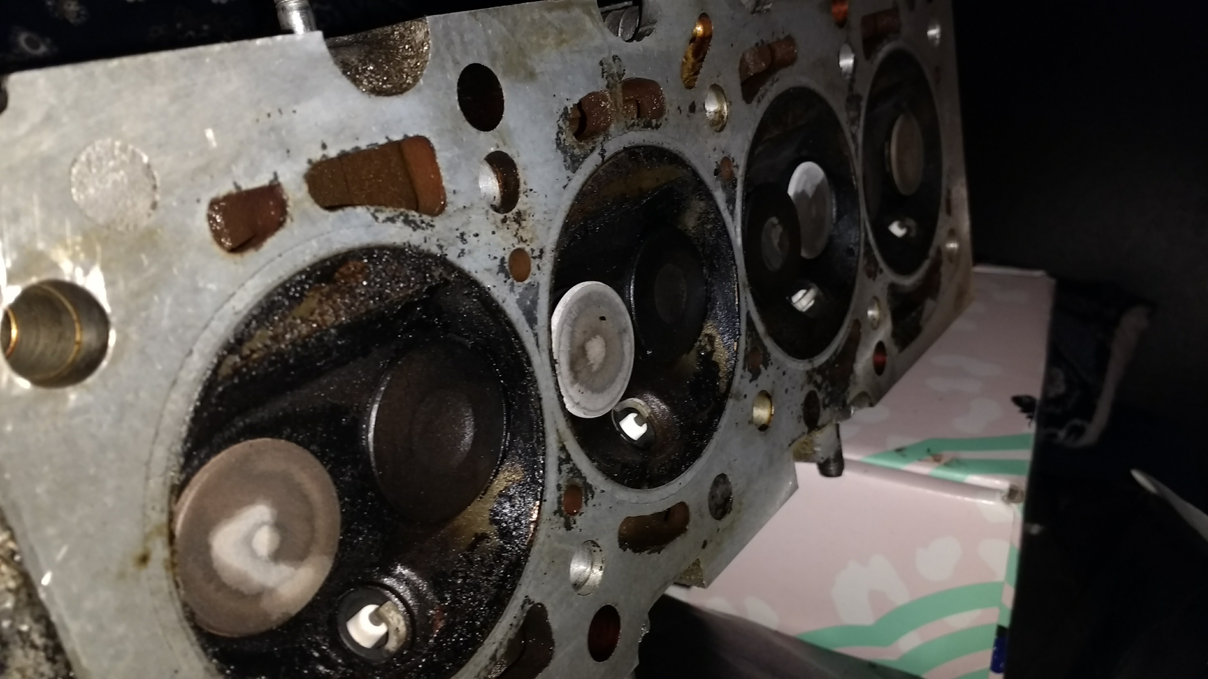

So got the cylinder head back from the garage on Wednesday after work, £108 for 1.5 hrs work plus VAT (I always forget the VAT...) so an expensive lesson learnt. Could have done it myself for less than £20 with a drill and some kit of eBay no doubt, but it is what it is!
Got some photos of their work once home, not the tidiest job in the world but the threads are all fine. Cleaned out the hole with brake cleaner and tissue, and a handy little screwdriver with a magnetic tip which pulled out all the swarf/shavings.
IMG_20170125_175510659.jpg IMG_20170125_175520453.jpg IMG_20170125_180947856.jpg

Old water pump removed (wrong teeth size/shape as you can see compared to the new one)

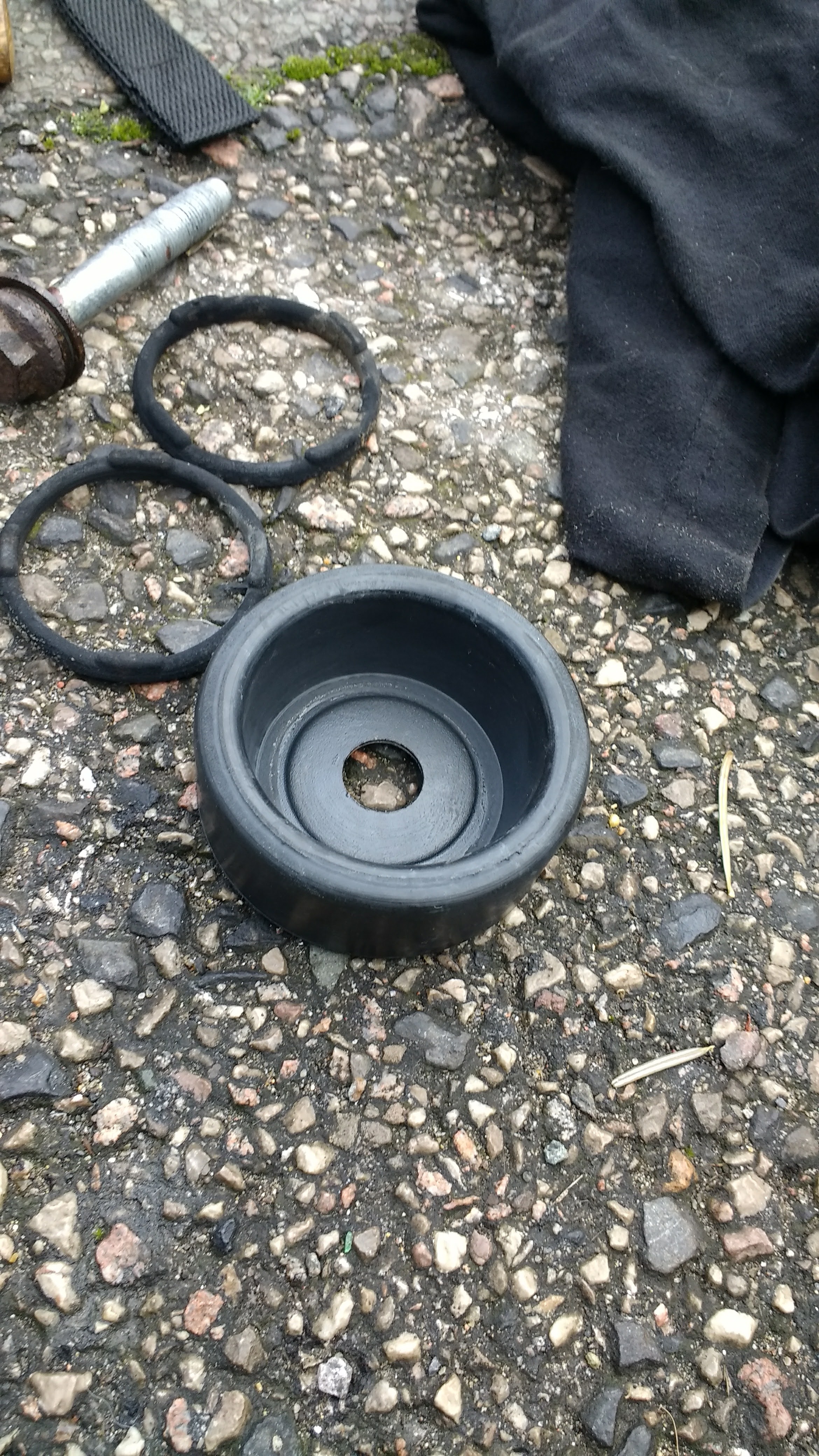

old rubber 'things' that were between the plates of the subframe bushes, plucked out with a screwdriver and clearly not doing anything, and comparison with repair bushes:
Repair bushes pushed/hammered on top of the existing bushes and bolted down, really easy job in the end!

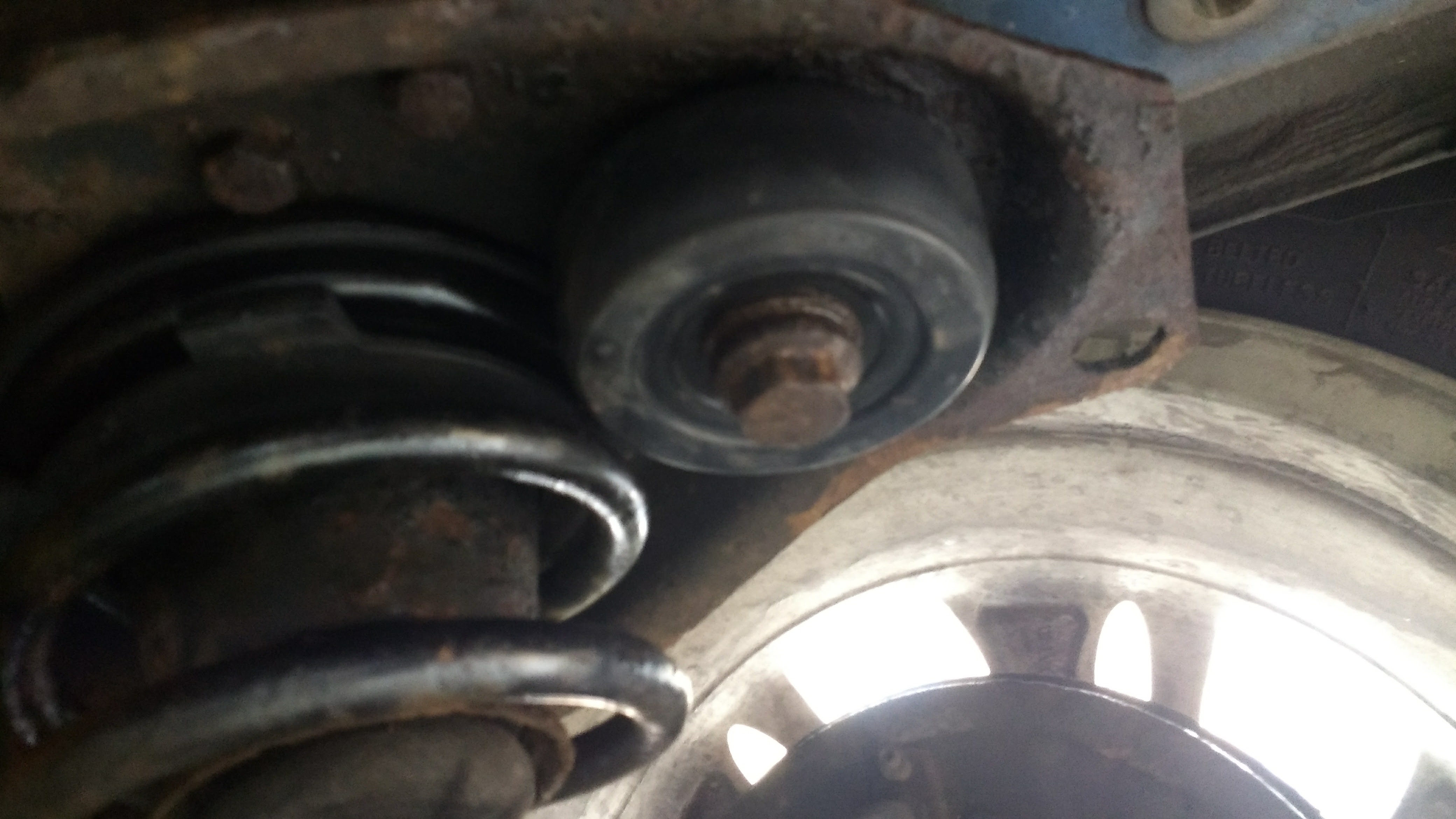

Also should add - after installing the rear subframe repair bushes, they have seemed to firm/tighten up the feeling I get from the rear of the car, but could tell as soon as I first headed off down the street that the rear right knocking/banging noise is still present.
Looks like it's got to be the rear radius arm bearings, which is a job I've heard is not the easiest even though the kits are cheap:
