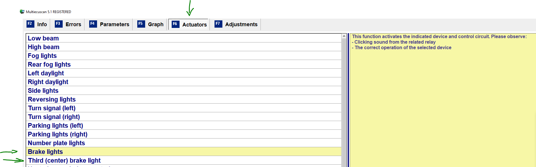

Haha, yes simply using the foot stepping on the pedal works, too (if they light up) - if they don't, you don't know if it's the lights or the switch. I use AlfaOBD and the brake light tests is one of the available tests (I think it was via the body computer ECU). Kind of cool to remotely trigger the brake lights using a bluetooth OBD dongle.
Cables: the brake light switch cable crosses over from the brake light switch in the foot well to the engine bay. So I presume it's rather unlikely to have rodents in the passenger cabin, but some people actually keep rats as pets ;-) Otherwise, check the cable harness which connects to the ECU and (for other causes) the cable of the wheel speed sensor in the wheel arch. I actually had both at the same time: a wheel speed sensor cable partially eaten by the tyre and an intermittently faulty brake light switch, the combination of the two faults gave me quite some headaches.
In the body computer:
And the Actuators tab:
Brake switch has 2 separate circuits. One for the lights, one for the bodycomputer => ABS computer. For the cost of it I'd install a new one. Make sure to calibrate it. Lift the pedal, pull out the pin on the switch and let the pedal slowly return to the normal position (pushing in the pin to the right length).
