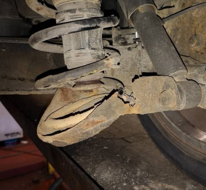

I would have a look under the rear of the car to make sure the spring pans aren't too rusty. There will be some rust, one is OK, the other isn't:
Also look under the front to make sure the engine oil sump pan isn't leaking (they go porous as they rust).
