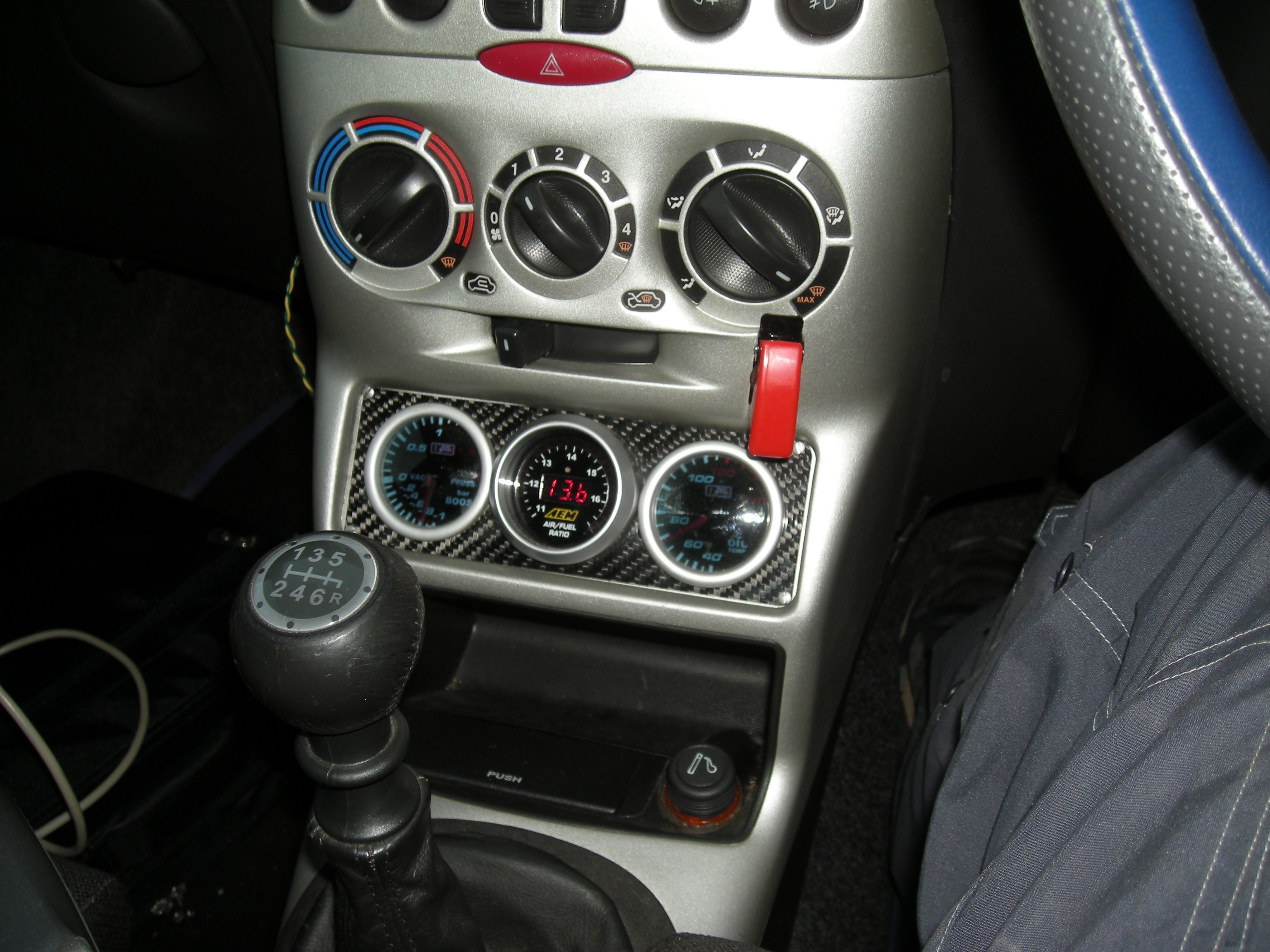

- AEM wideband AFR gauge
- Autogauge boost and oil temp gauges
- Carbon surround

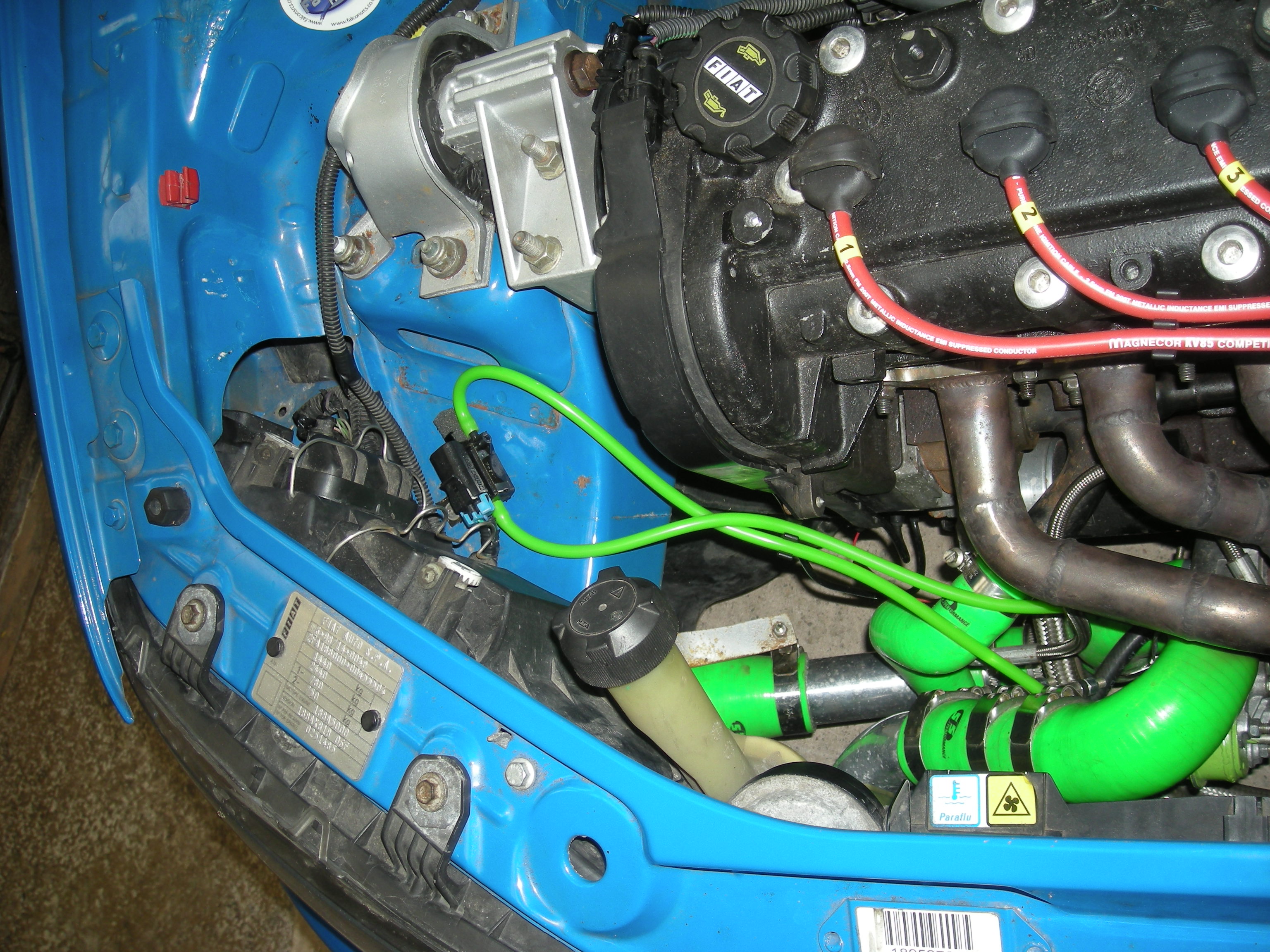

I ran without a BOV for a few months, tried a couple of HKS SSQVs one which was fake and broke, the other which just didnt seem to work, even with a light spring. I ran it with the BOV on but not working for ages, in those videos it was installed but not opening at all, all chatter from the inlet.
until 3 weeks ago when it started working of its own accord, for some strange reason!
Now it has the normal psssshhh at low rpm and a high pitched choo! at high rpm lol
Thinking about taking it off again though cos im bored of the noise and it offers no spool-up difference anyways. Sod compressor surge it doesnt wreck turbos like everyone seems to think.

Your DV was probably a bit jammed up, oil vapour on the inlet might have freed it up so it started working, just a thought
aye but they are all on PB and custard will hurt me if i put any more up :eek:
My build thread is in my sig mate, i have a few more pictures there :)
Blu - it could have been jammed but we tested it on a corsa LET and it worked fine... ah well.

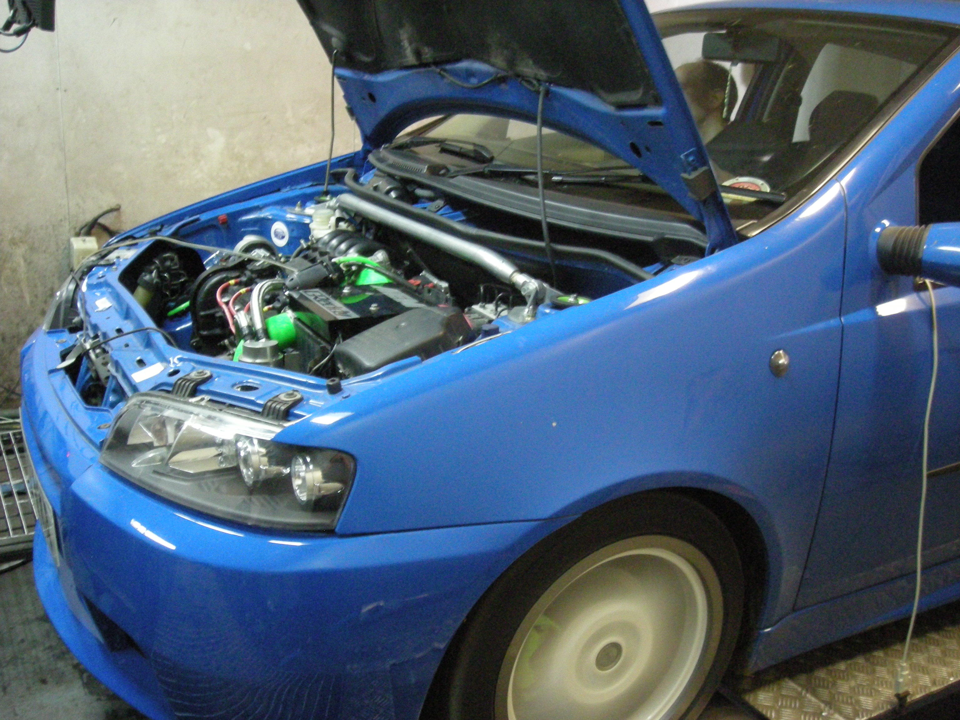

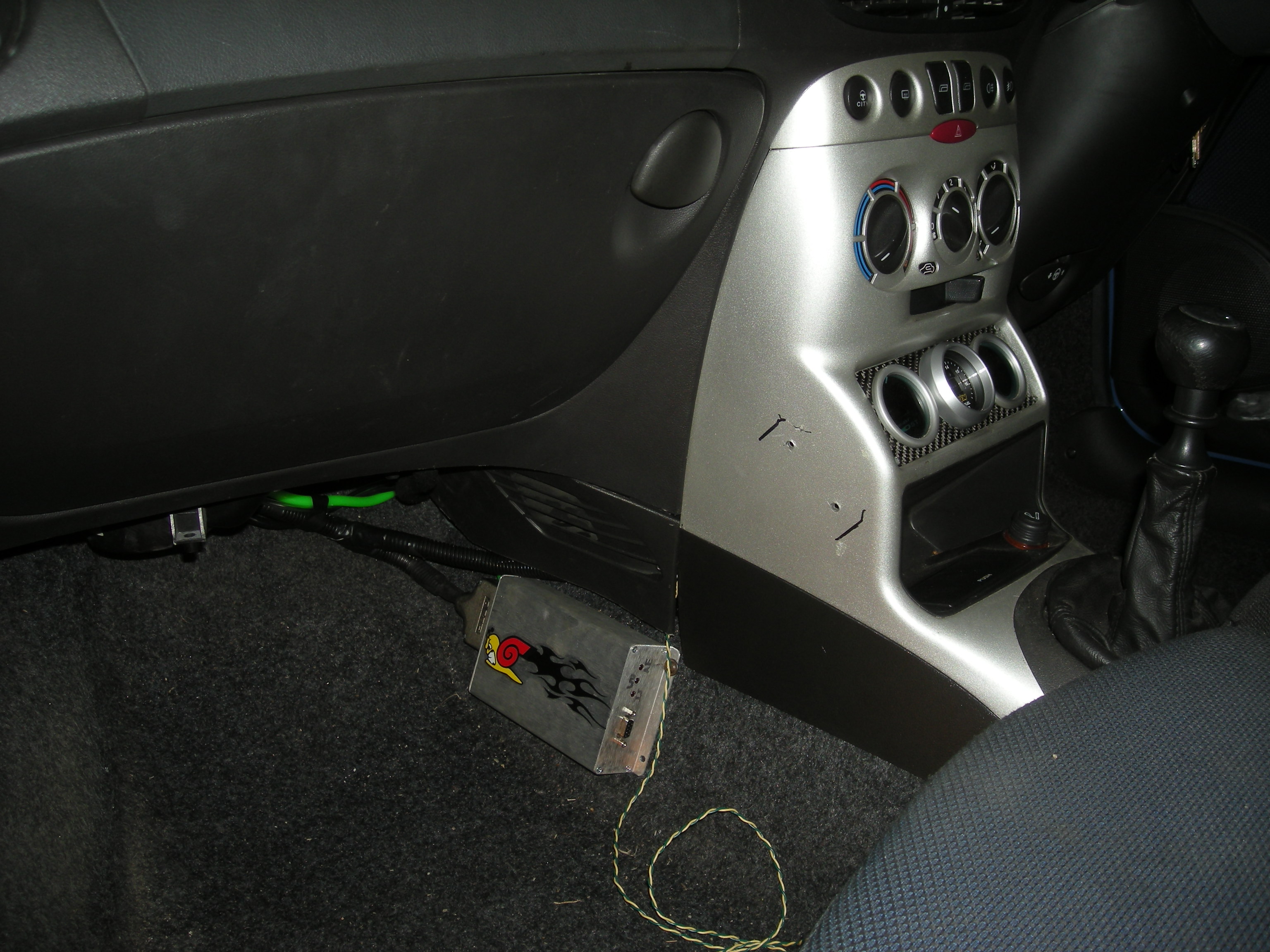

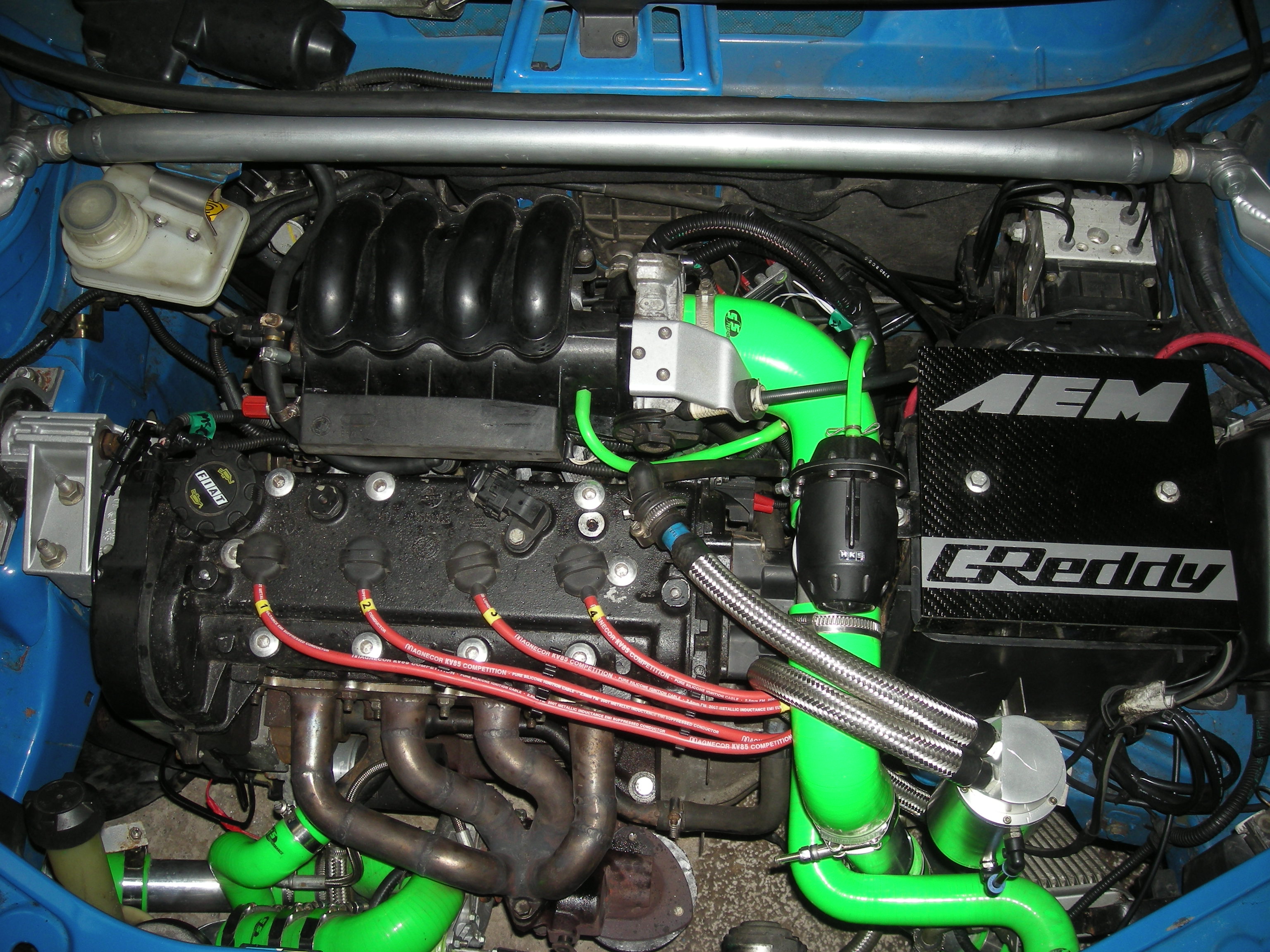

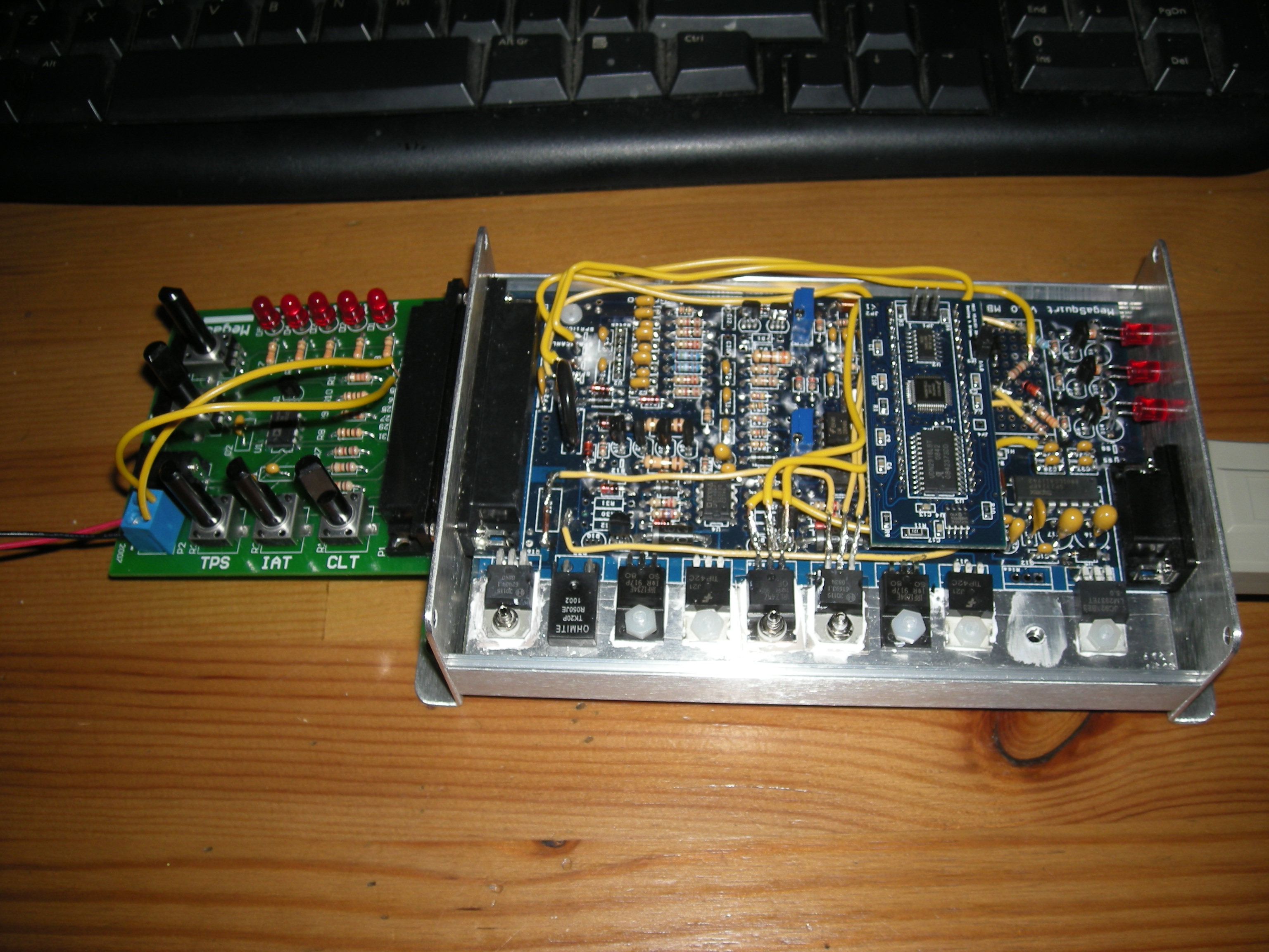

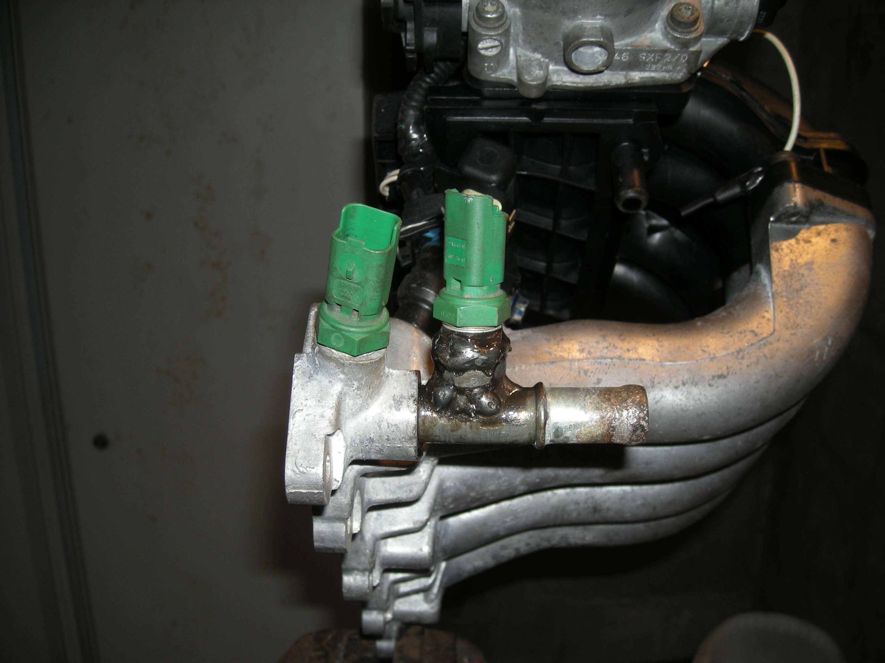

Full megasquirt MS-2 Extra setup built with launch control, flatshift. boost control, knock control, amongst other things. Then custom wiring loom built up - had to keep the stock ecu in place to run the dashboard and fuel pump, which meant i needed to double up on some sensors - so an extra water temp sensor and crank sensor were added.

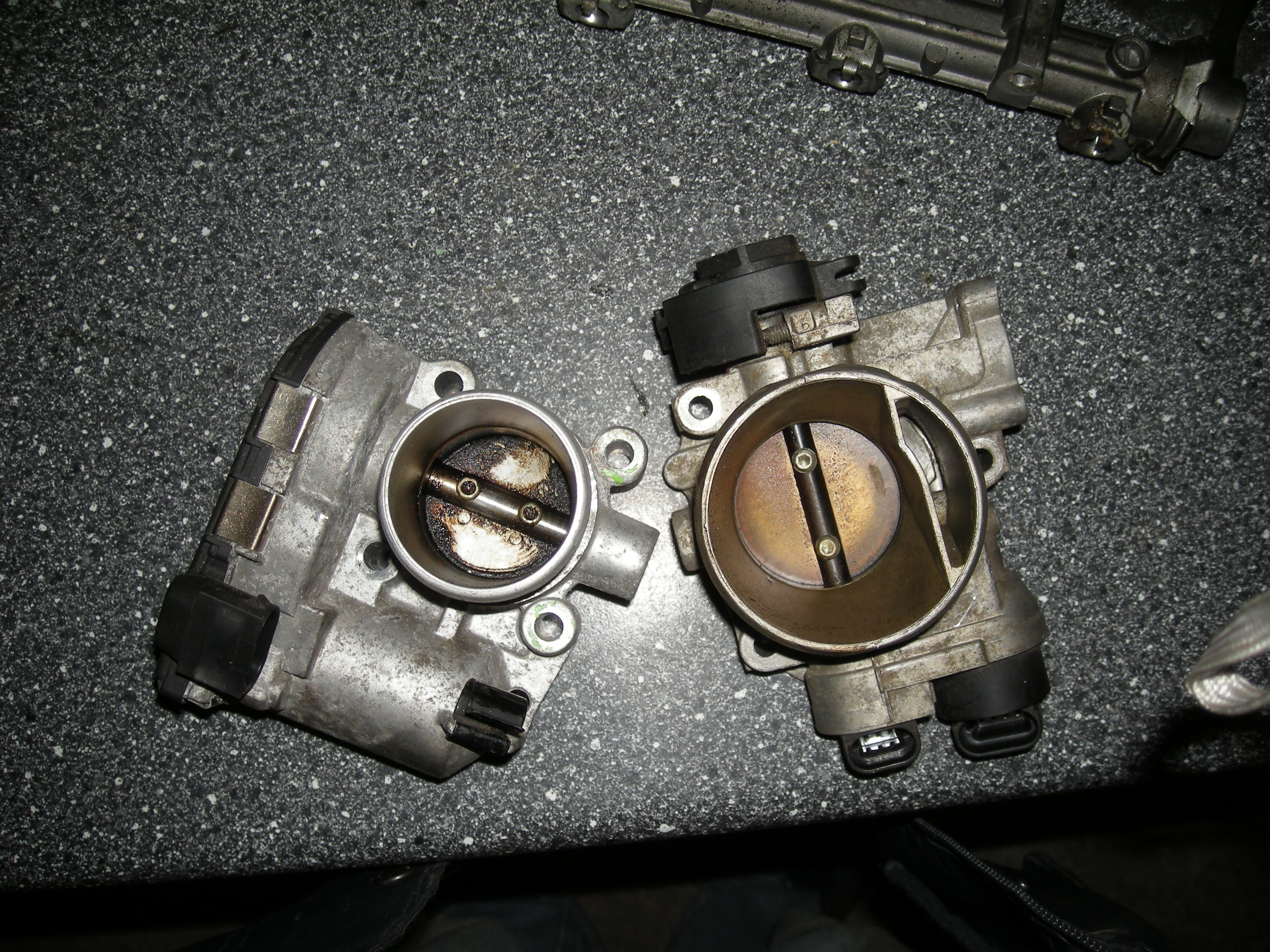

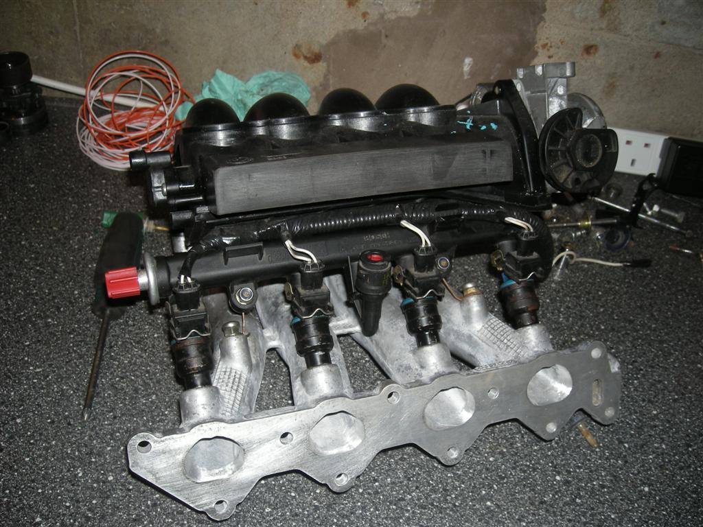

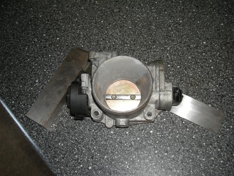

I converted the throttle mechanism from fly-by-wire to cable (HORRIBLE job) used a mk1 punto inlet manifold, and a marea 1.6 throttle body (comparison shown). I removed the idle control valve and smoothed out the taper with fibreglass/metalset for smoother flow. Also port-matched the manifold to the cylinder head.
I used a single set of 240cc bosch injectors from a vauxhall redtop, with stock injector rail and fuel pump, left at standard 3.5bar fuel pressure.
Now putting out 160bhp and 150lb-ft at 0.9bar. Double standard power on standard bottom end, who said fiat engines were soft :) this car gets driven hard nearly every time it's out as well :spin:

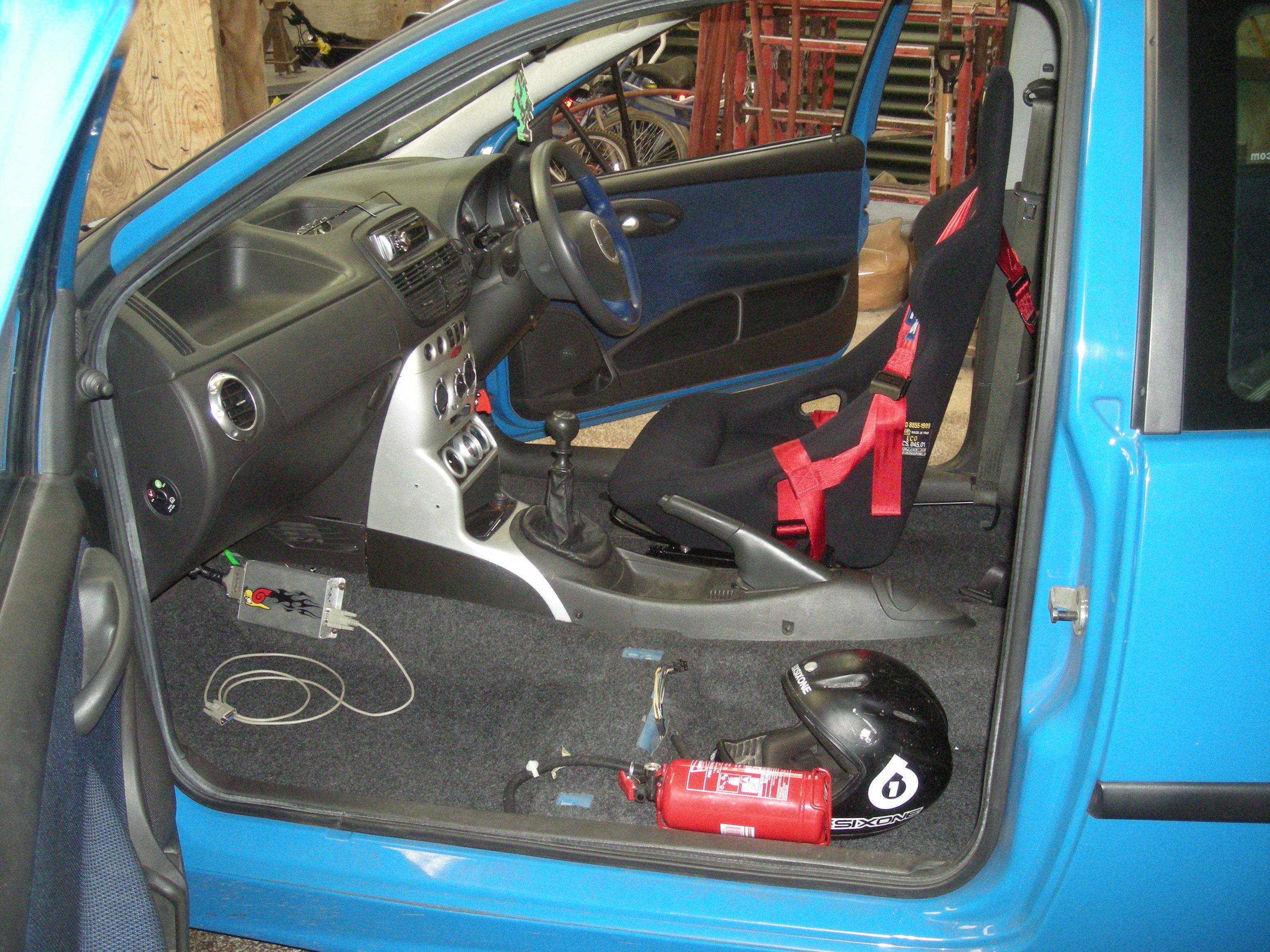

(took the seats out just for drag racing, back in now though)
15.01 second best time, crap surface for launching though

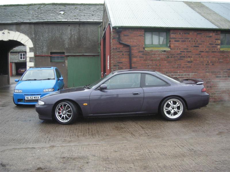

Yeah i dropped the other punto project, i just didnt have the time or patience for a massive life-consuming project that i wouldnt get to drive for years... plus nissans go sideways much easier :eek:
The S14 has had quite a bit of work done to it since i got it, mostly suspension and under the bonnet, but its easy stuff, all bolt-ons, no fab work or anything special at all really.
November Crail DWYB day
And new colour of rear wheels, i have another pair of the same design to go white on the front
