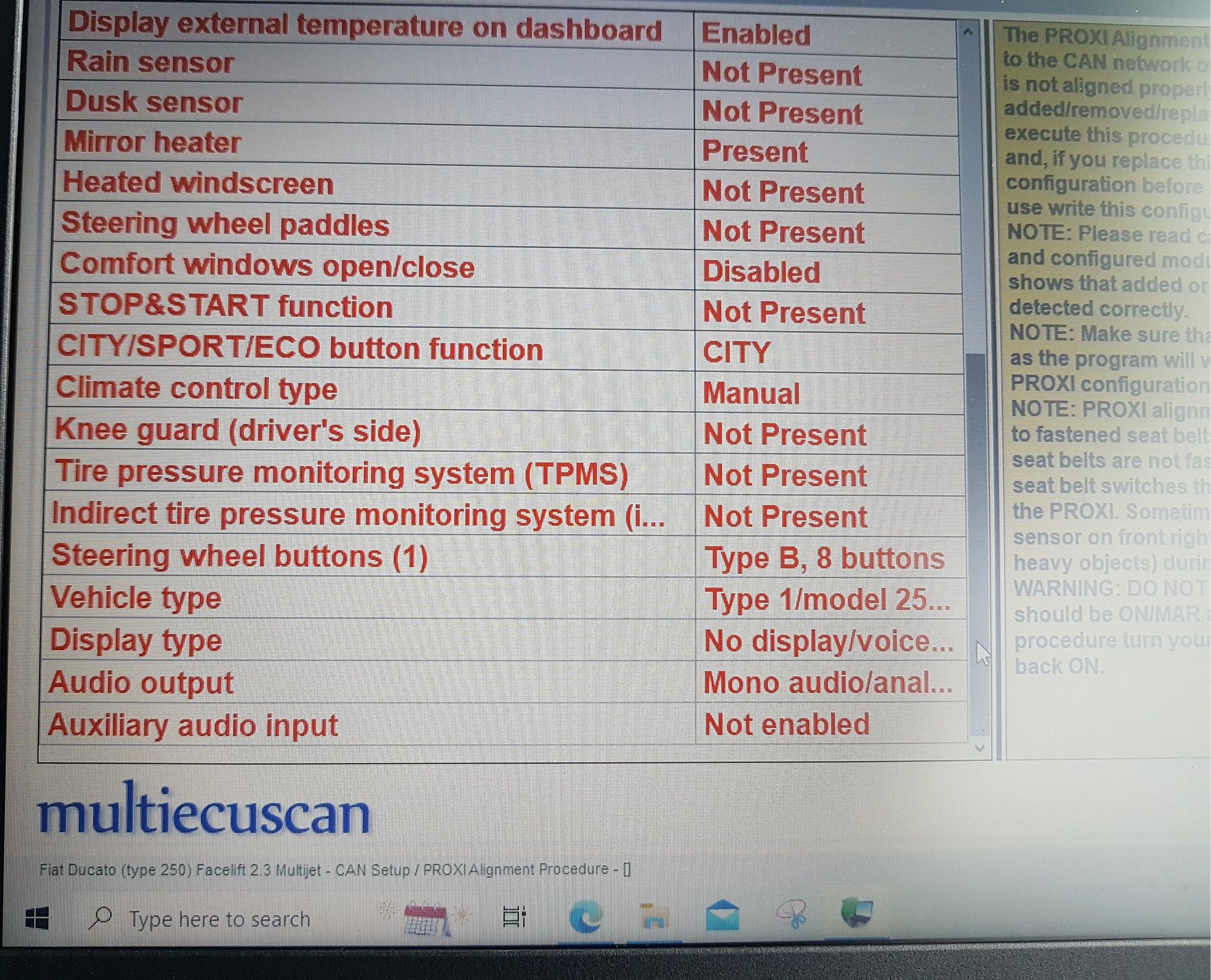

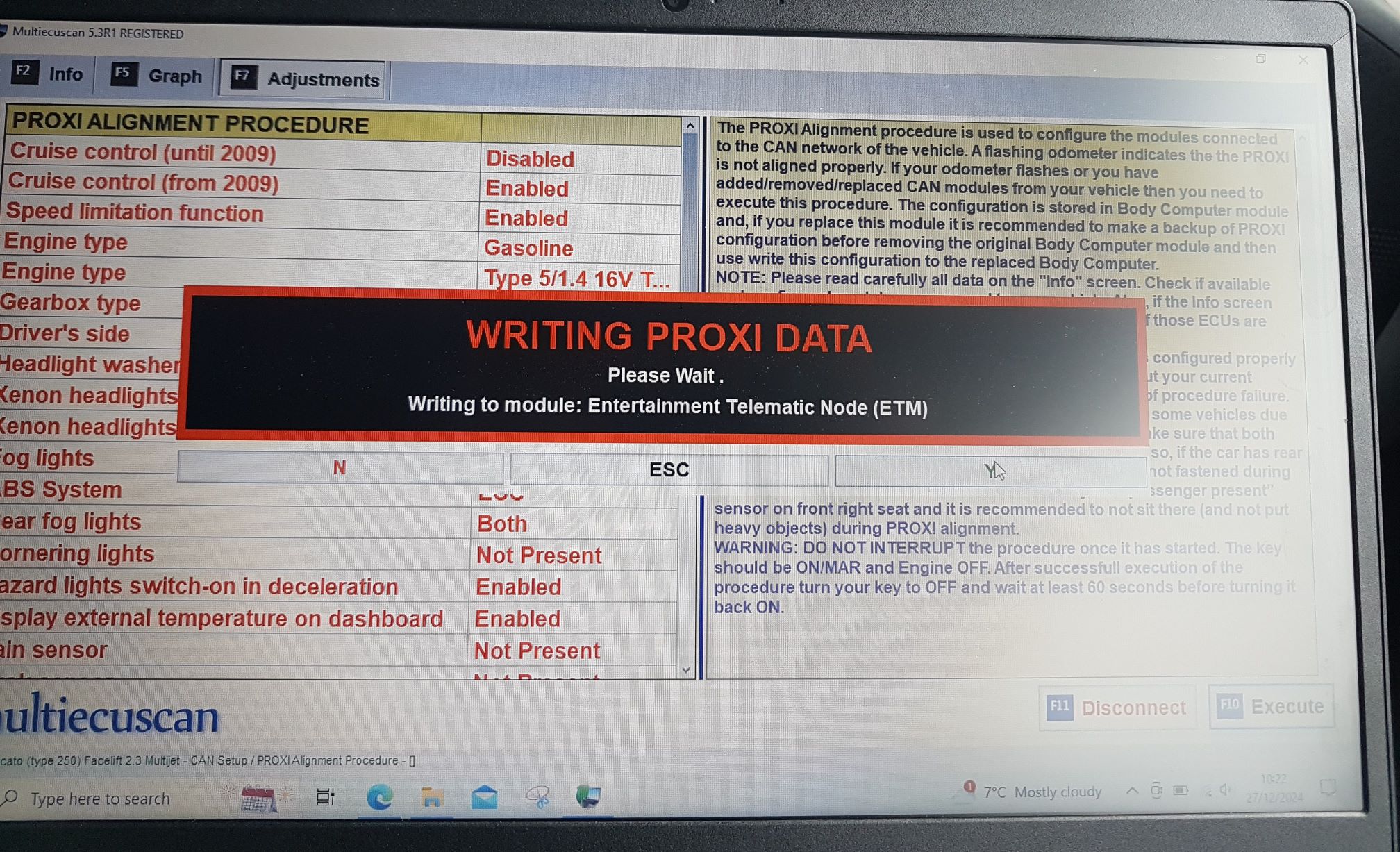

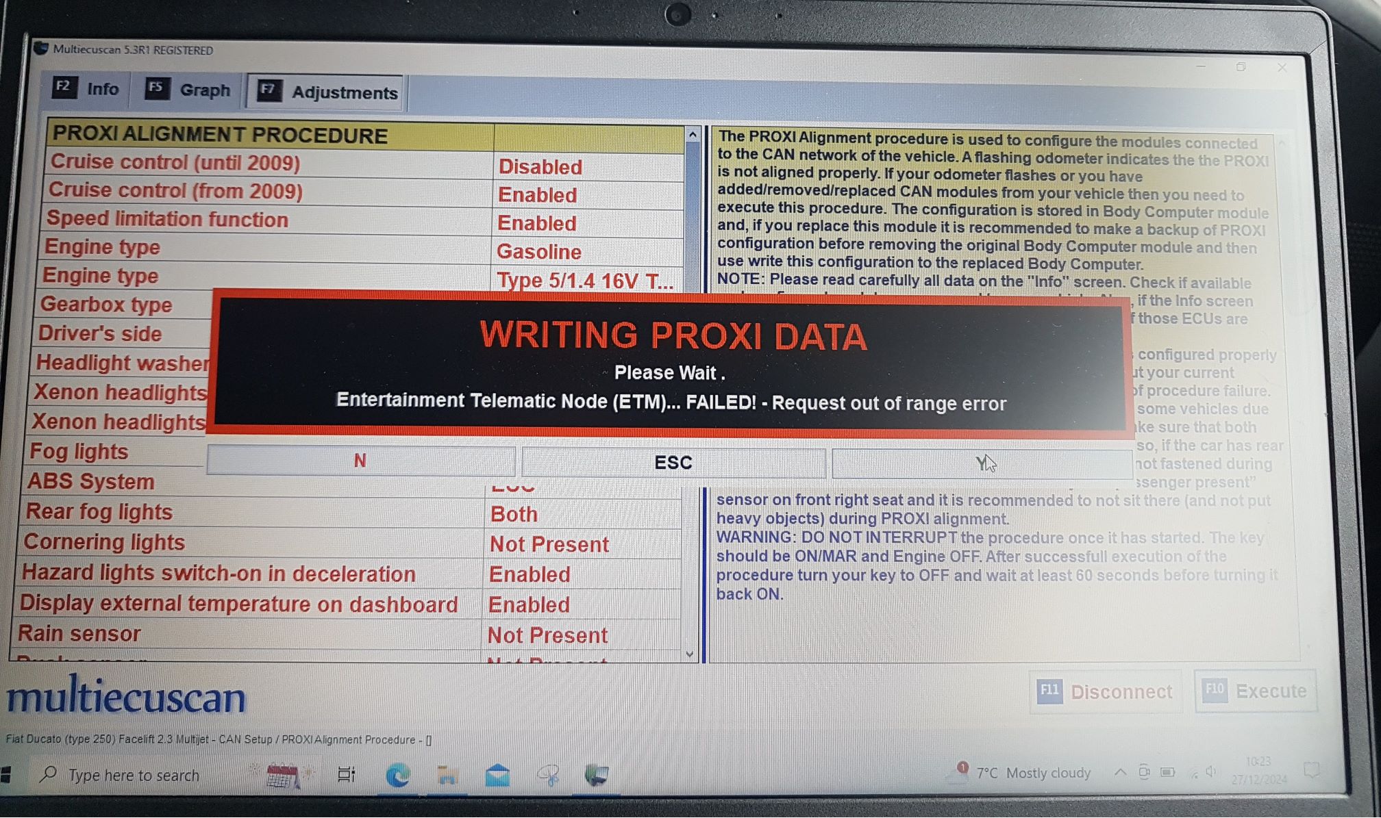

However, adding the new unit still threw up an error when trying to PA - see photos......
Any ideas welcome
Someone mentioned a custom Proxi-alignment (that seems scary!!) anyone done one before?

Proxi Alignment failed on Entertainment Telematic Node (ETM) Failed - Request out of range error
PA Log suggested a BTYE change........ this worked for me but user beware if you start playing with coding!!
Just to confirm, radio unit was switched on during the modified PA, powered itself down after applying the modified PA - and now seems to be working ok.
