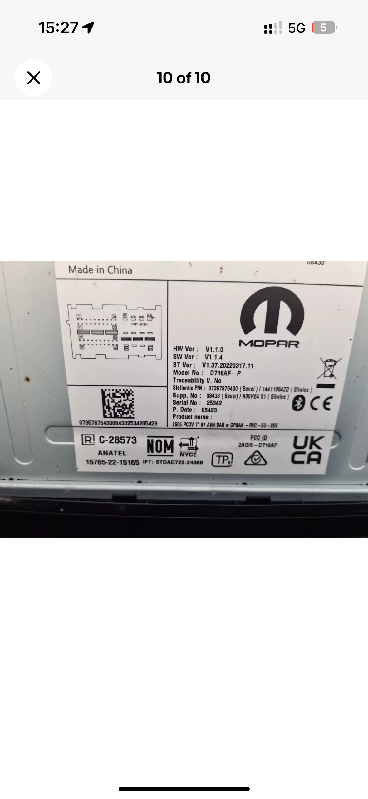

basically i’ve got a deposit down on a fiat ducato 2020 with the new 7 inch u connect Daichi head unit. standard unit, no navigation. my understanding was car play was standard on this model, however after discussing with Ciao fiat, supplying the VIN number, it’s not standard for some reason!! so that’s annoying.
my question - is it possible to use multiecuscan software, similar to fiat 500, to add car play function, or update software, without visiting a dealer?
alternatively i’ve been looking at second hand daiichi units which on the stick label say they have CP&AA on the back, removed from a newer relay or boxer (can’t find a ducato but sure they’re the same)… will this be a straight swap? any need to change any codes etc? if so, any pointers as to what needs changing?
FYI My vehicle has reversing camera fitted too… not sure if this will be an issue, although all units i’ve seen have “RVC” on the back too.
should i be getting multiecuscan or alfaobd for this (and also general future use)
attached photo is my head unit screen showing camera (without built in nav button). second pic is a used one on ebay.
