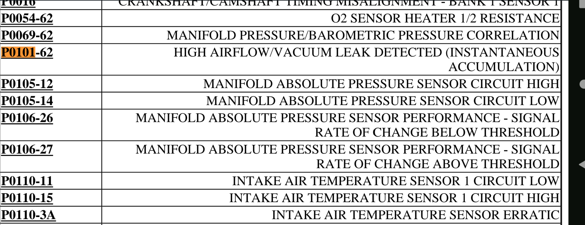

p0101 and p0106 both a mismatch in pressure reading at the MAP sensor
There's quite a few possibilities, brake servo hose, inlet manifold distortion
