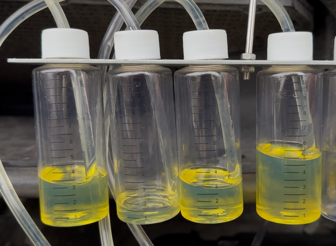

Replaced injector #2 and programmed it using MES. Did the test again on cold engine.
Injectors 1 and 3 returned ~35ml
Injector 2 (new) returned ~15ml
Injector 4 returned ~50ml
Does the new injector (2) return correct amount? Shouldn’t it return around the same amount as 1 and 3 injectors?
Still getting white smoke and knocking. Thinking of replacing injector 4, but the injectors 0445110418 are now out of stock and discontinued. It appears it was replaced by part number 0445110520 but I read on forum that it cannot be programmed using MES?
I think the replacement No.2 is running efficiently where as the others are worn to varying degrees.
