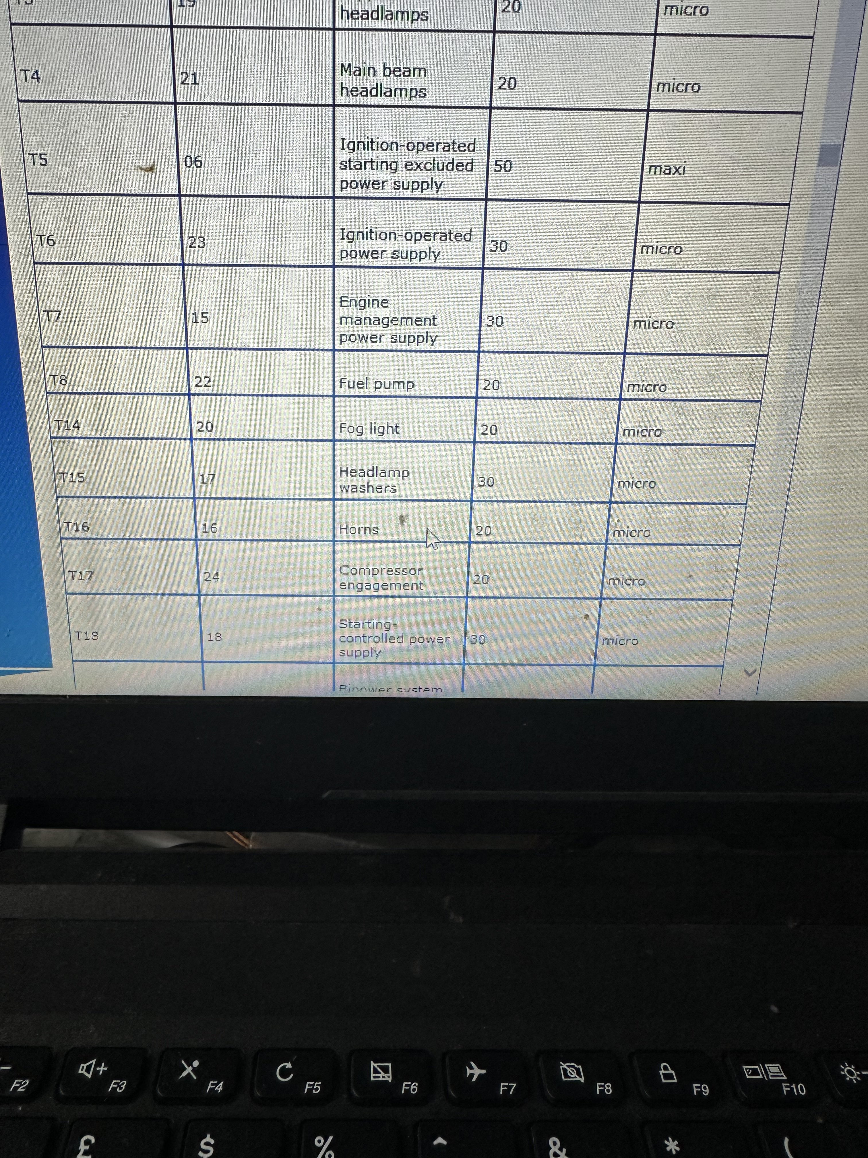

That’s what I’m looking into mate, if I remember right when I heard the squeaky noise the drivebelt didn’t even turn all I heard was the noise coming from the starter area, I’m checking the relay next, they said it’s fine but I will check it and check the wiring on the starter
From this thread it appears the relay is number 13.
Take the lid off the fusebox
Look at the inside of the lid where there should be a fusebox diagram
Identify number 13
Stand to the side of the car, not in front
Put your fingers on number 13 and have someone else start the car in neutral
If the relay is working it'll click and you may feel movement inside the relay
Alternatively swap the relay with another one currently on the car, or buy one off ebay and test
Check this picture as it says T18, I presume that’s the one
