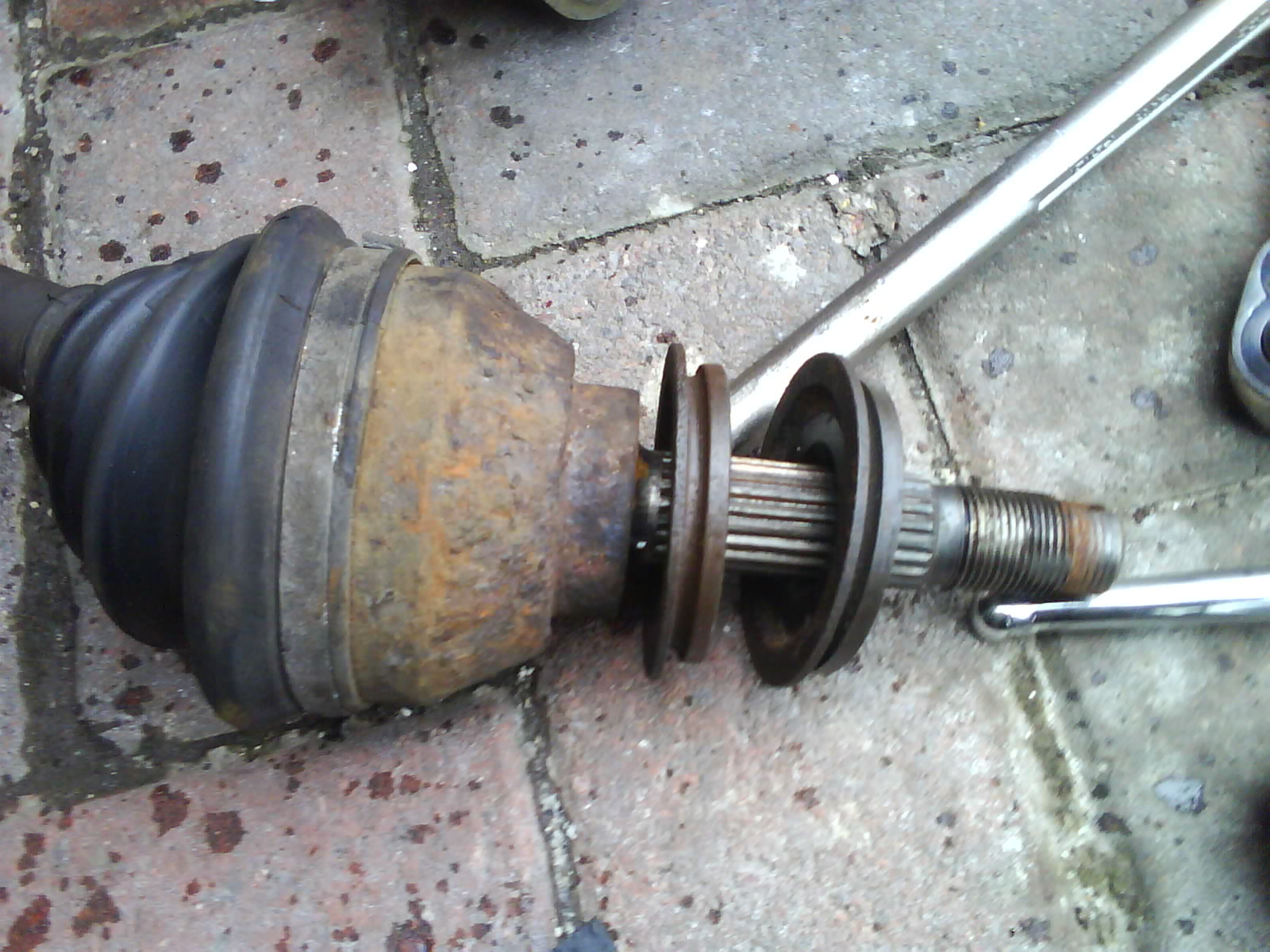

RIGHT THEN, can all the knowledgeable types dust off their best thinking caps. Been looking at the older gearbox I've got and the newer gearbox off Scruffbag and the linkages look significantly different. Changing the linkages looks iffy. Father in law has consulted his ex fiat dealer mate and he reckons the gearboxes changed quite a bit when the internal linkages came in including a change to a bigger spider on the driveshafts meaning that a)changing the gearboxes might present problems b) fixing the internals by swapping parts out of my good one probably won't work and more intriguingly c) the driveshaft spider which I've put in may just have been wrong to start with and the gearbox may actually be OK...
any thoughts, or better still hard pertinent facts anybody?

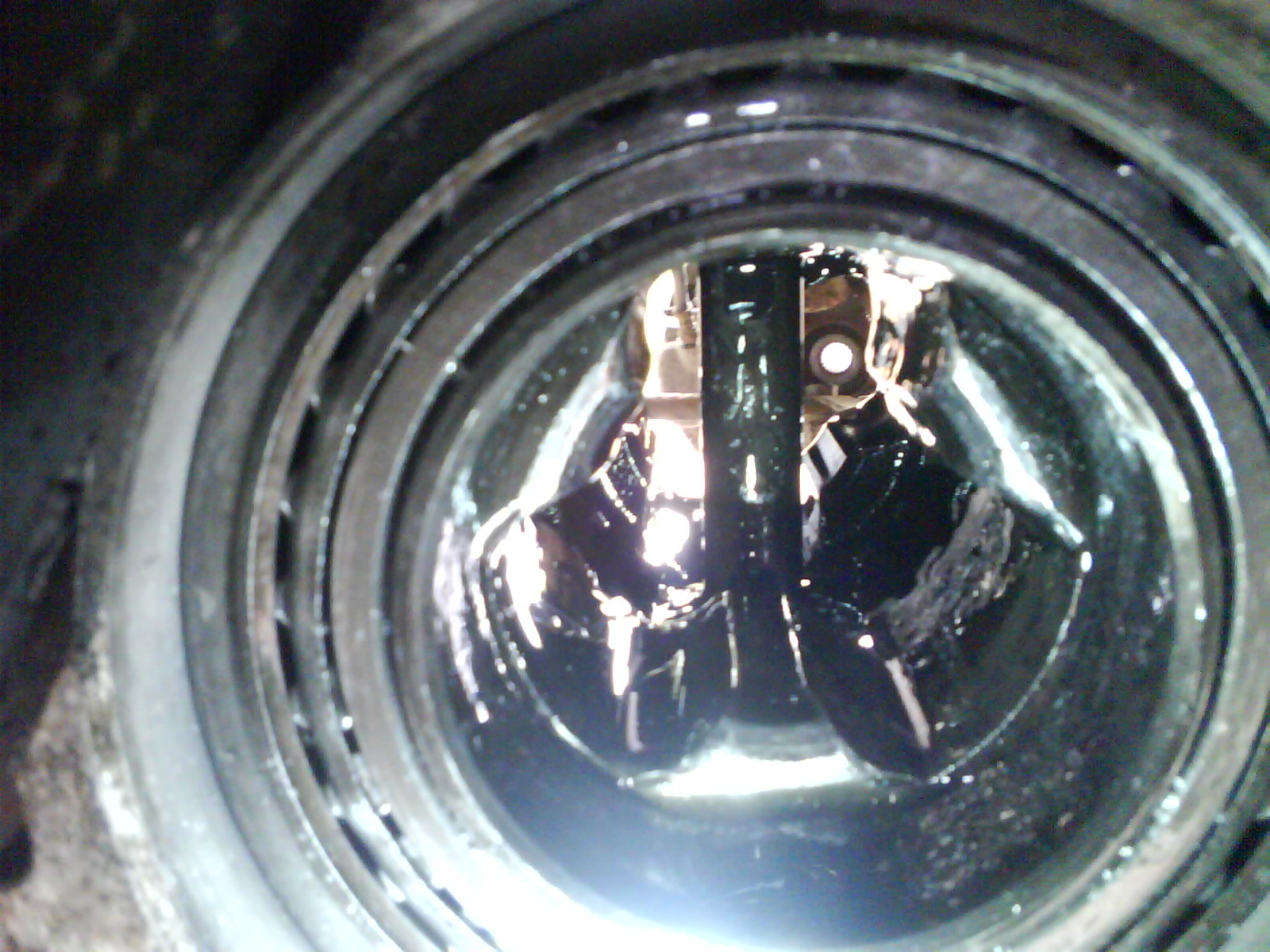

looks like the spider collapsing gouged out the drive in the diff so when the new driveshaft went in it just slipped in it's housing:
can't see that well in the photo but if you look you can see the outer end kind of tapers off there. So, not really fancying a gearbox change we went for...
doubled up on the big end washers on the driveshaft thus moving the spider further into the housing and off the damaged section. So with some trepidation Scruffbag was prepped for my maiden drive:

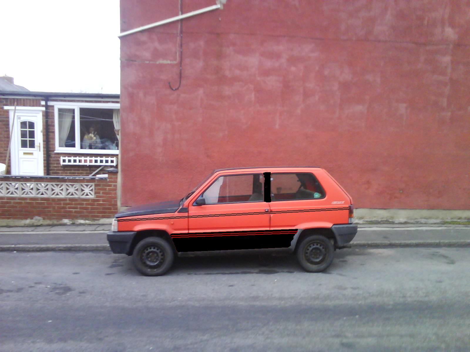

been messing with paint, since another day has slipped by without actually touching the car:(
so rough plan is..
I know the black bottom half is a cop out for rusty doors but I really like it. Did it on my uno years ago and that didn't even have rusty doors!

Black lowers ftw!
Pandas really suit this two tone colour scheme, I've done it to my old fizz and current 750 (no rusty doors), Fiat did it to my very first MK 1, and Seat did it to my Terra, so it's gotta be the right thing to do. ;) :p
Blacking out the 'C' pillar is also very effective, looks good with smoked windows (y).
How about making the black bonnet look like carbon fibre. You can do this by spraying silver through tool box drawer liner.
don't want to do much to the bonnet, needs replacing anyway, paint's crazed, it's bent, and badly rusted on the underside. Maybe a real carbon fibre one...or not.
