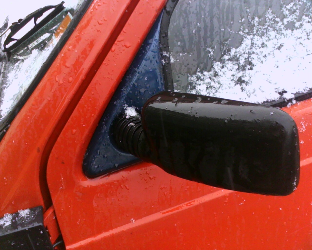

another unexpected bonus I hadn't noticed too. It's had a replacement N/S mirror with a colour coded base:
now does that shade of blue look familiar at all? and Grumbleweed has a colour coded base on th O/S mirror but not the N/S:D ...yet

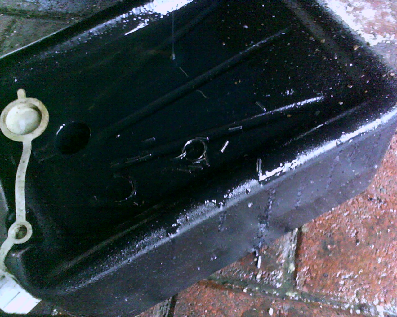

the not so good, does seem to have been the spider on the inner end of the N/S driveshaft which has disintegrated. Here's what came out with the oil:
sorry not a great photo but there was quite a pile of little needles and bits. The driveshaft came out sans most of the spider assembly.

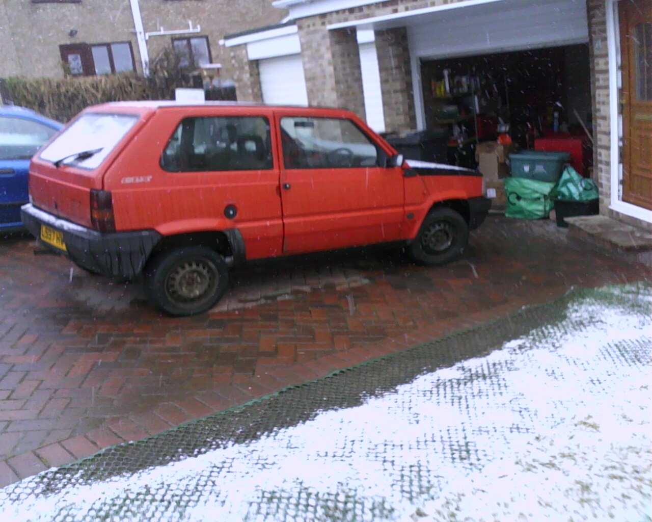

not be much progress today, can hardly tell the 2 Pandas apart there's so much snow and if I can get anything done it's gotta be the exhaust on grumbleweed since I now have a manifold to put on. Maybe try and clean up inside if anything, out of the snow!!
Yep, the snow prompted me to have a day off from Panda work yesterday, too cold and too covered :)

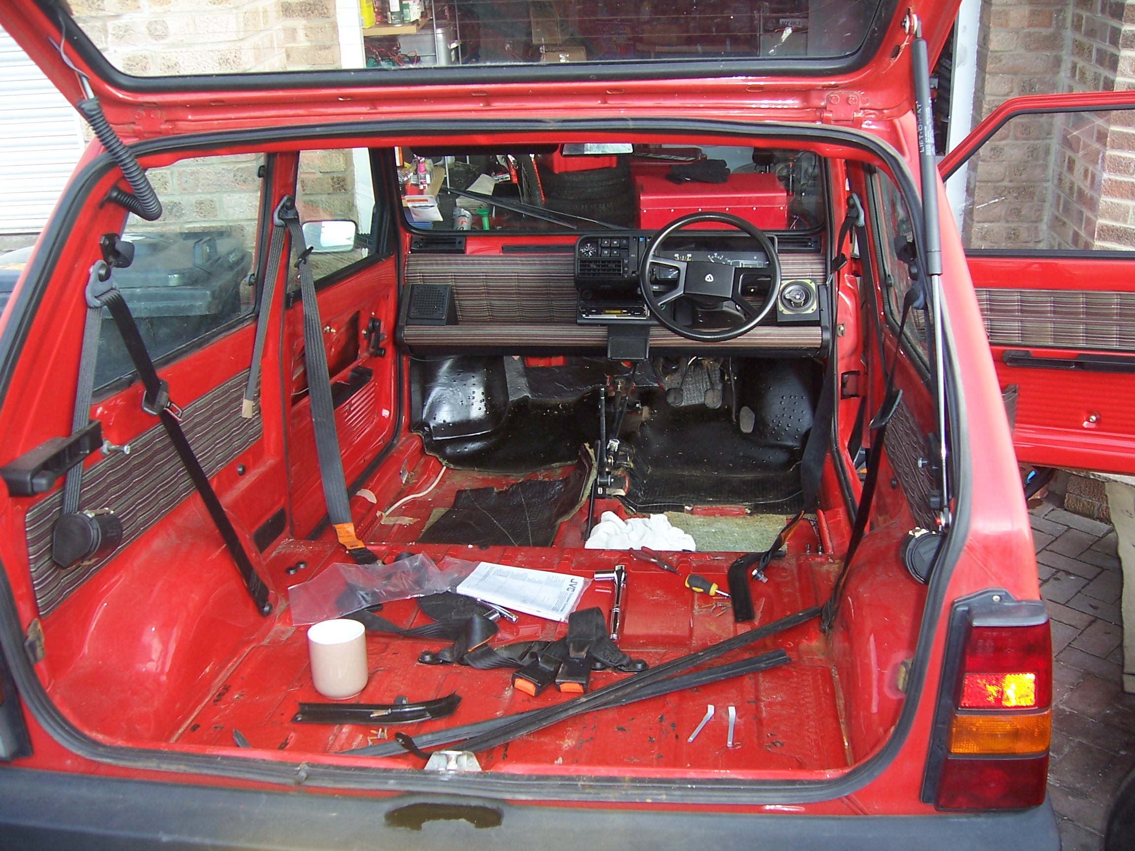

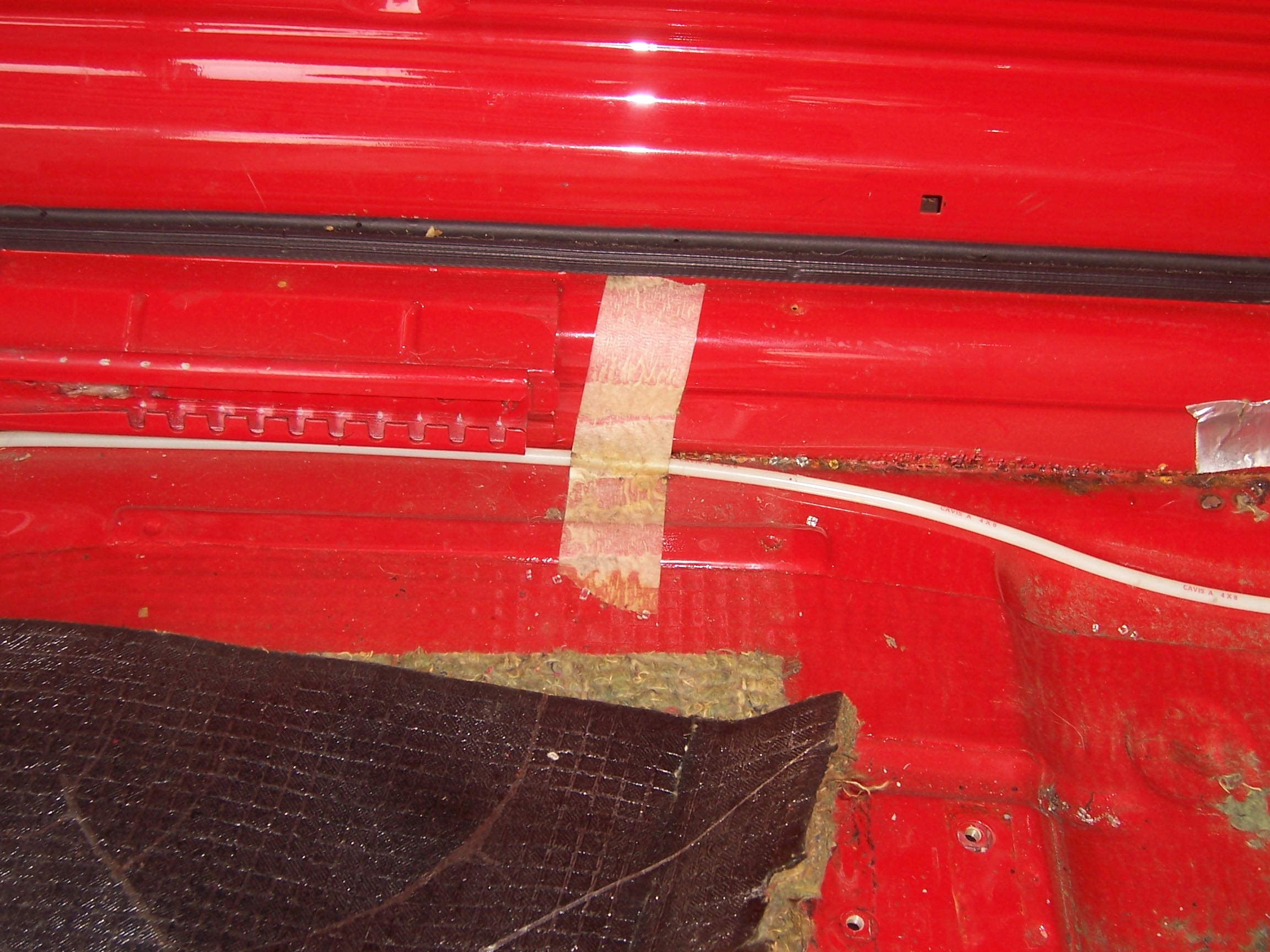

OK another days run at stripping out Scruffbag. Pulled all the interior out so I can see wot rot got.

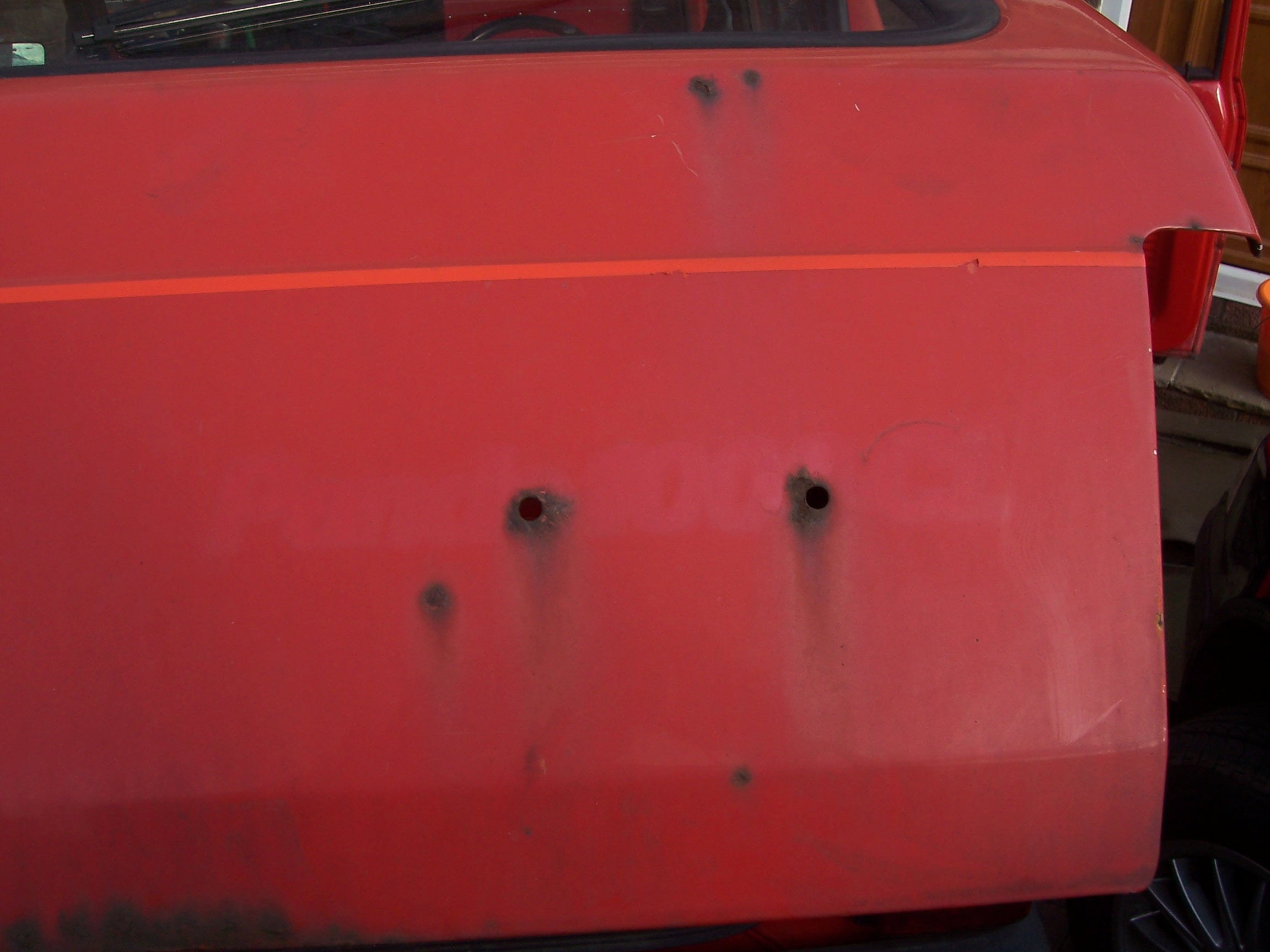

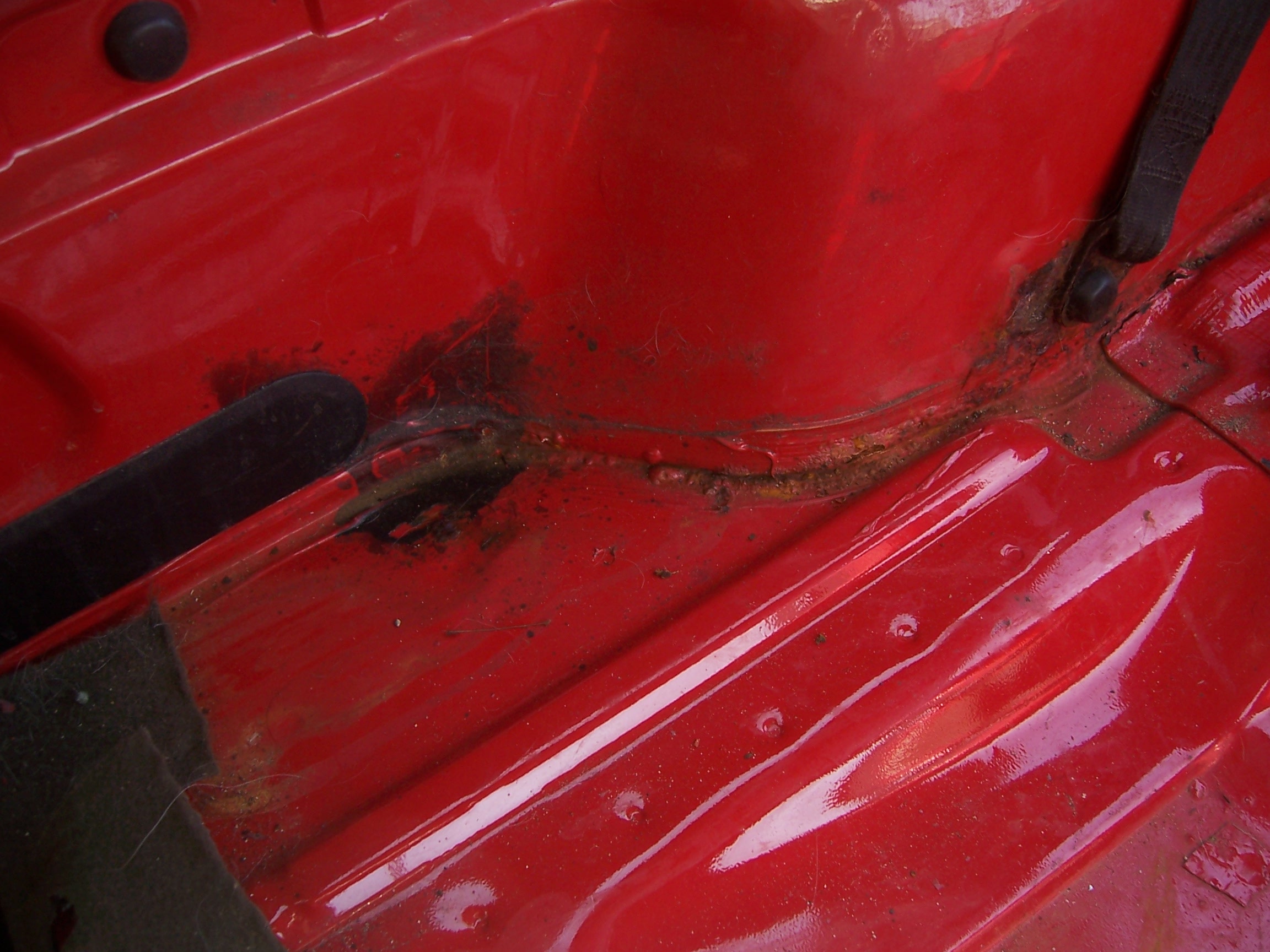

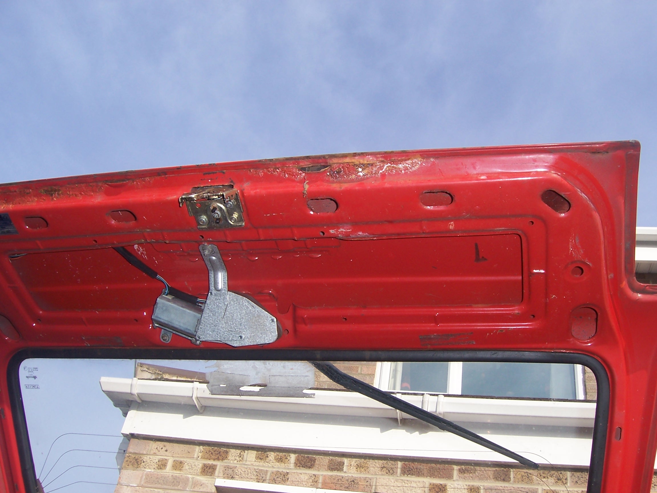

Shell doesn't look bad: some blistering starting round the drivers side rear arch seam, rot round the seat belt mount although it still seems pretty solid, Passenger side seam clean as a whistle, little bit going on at the inner edge of the sill down by the passenger seat and the tailgate looks completely shot:(

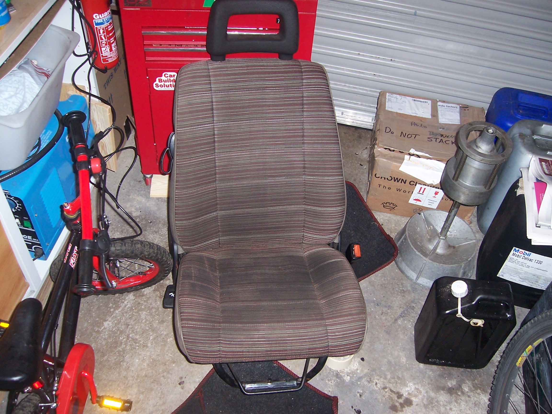

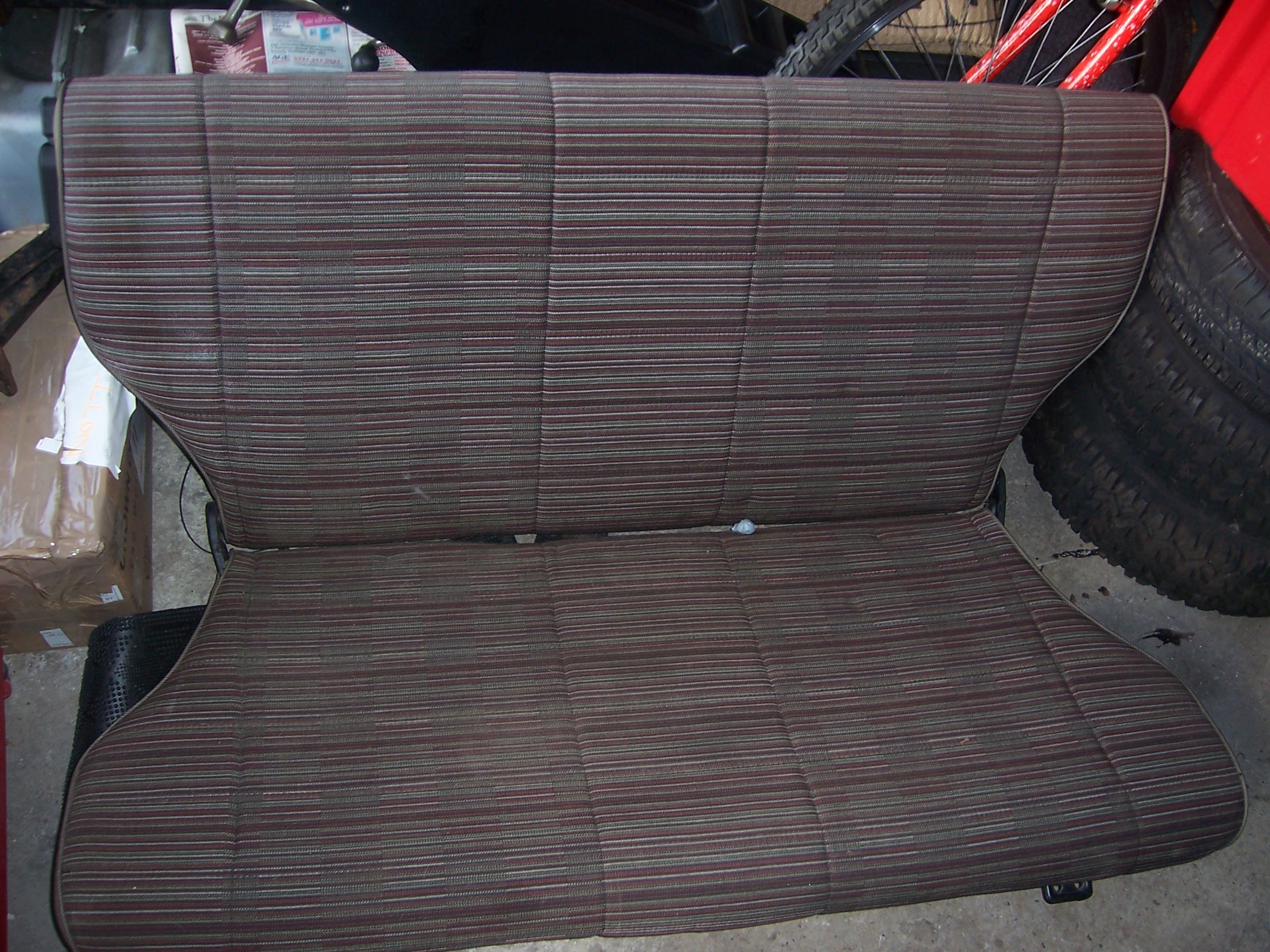

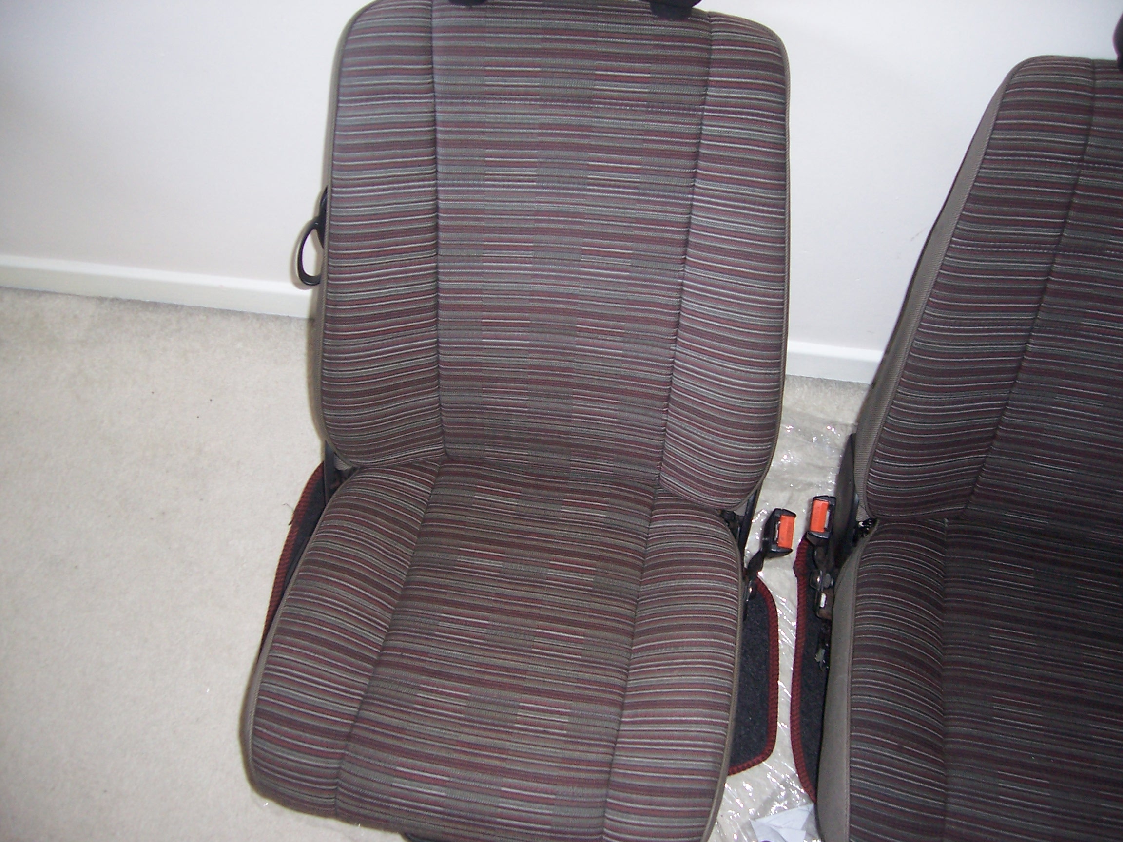

Interior cleaning up OK: Drivers seat before and after. Rear bench 'before', cleaning that is next job.
Andrew.
Go on that lad!!
You wont know how bad the rot has set in until you get that blistering away and a good spiked hammer hit into it. But if thats all you have to worry about, excellent!!! That wouldn't take much to plate at all (y)
Good job on the seats. I remember ARG was a hell of a job to clean up :(
