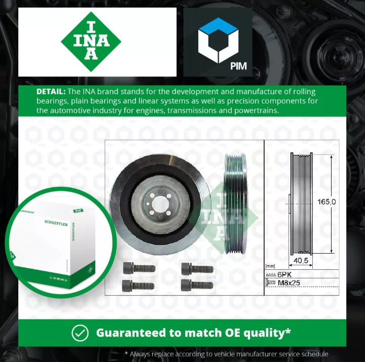

They got the pulley to me within a couple of days and they have a good returns policy if the part is not what you needed or didn't fit etc.
