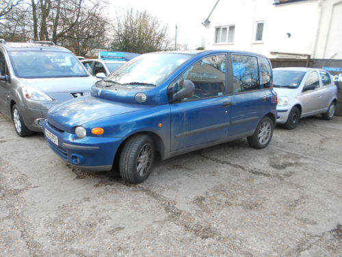

Here's my new Multi,pictured on the day I picked her up, resplendent in what looks like a years worth of road grime :rolleyes:
I've serviced her, fixed numerous electrical issues including getting the remote CL working again and got her through an MOT a few days ago.
Next up is a drive belt tensioner change, as mine makes a real racket, bleed the clutch to see if I can get a better pedal, change the gearbox oil and then try and find a pair of roof bars before our holiday in May :)

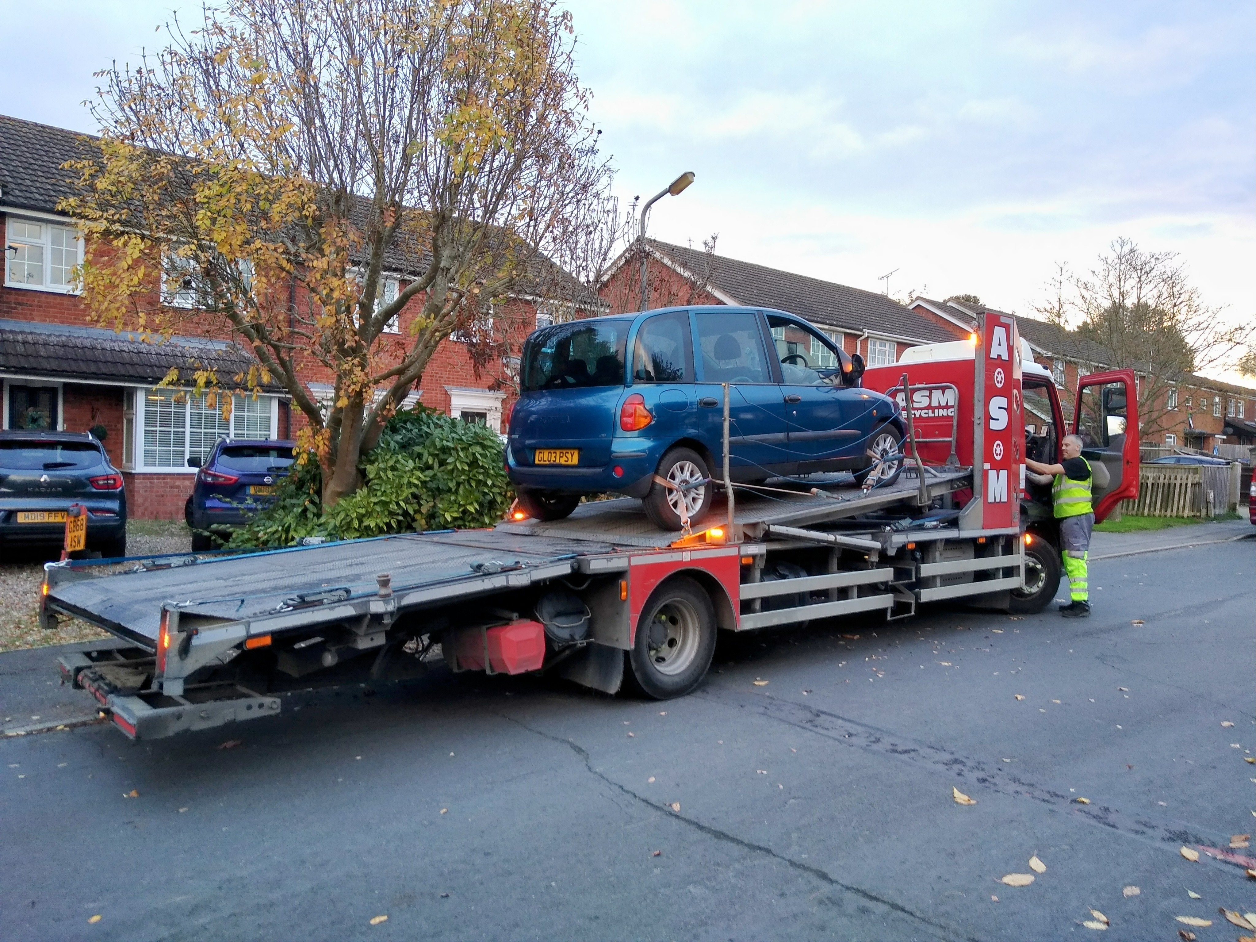

A truly sad day. I had absolutely no interest from anyone wanting her, so off to be turned into bean cans.
I took off quite a few parts- working spare wheel winch, space saver,front indicators,towbar, rear fitted mat, parcel shelf,rear central seat belt mech, sunroof switches, bits of plastic trim, radio, gearstick and handbrake covers, rear wiper arm, rear boot side covers, wheel centre caps,roof bars, aerial,jack, bonnet struts and every bulb in the car!

Very sad. A real shame. I know how you feel as personal circumstances meant I had to do the same with two of my other cars that were on SORN's. They went off on a breaker's truck last year, just like in your photo. It's heartbreaking, especially when you've owned them for a long time. I felt like I'd let them down, in some way.
