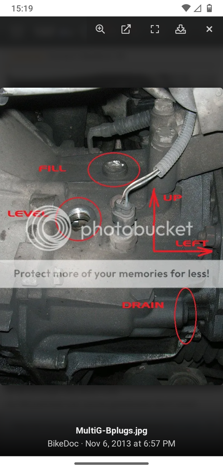

Yes it is 12mm hex at bottom of box next to front mounting point of wish bone.
Not the hidden one on gearbox end face
Thank God you didn't chisel at it like my first incorrect suggestion-i thought engine drain plug- apologies again

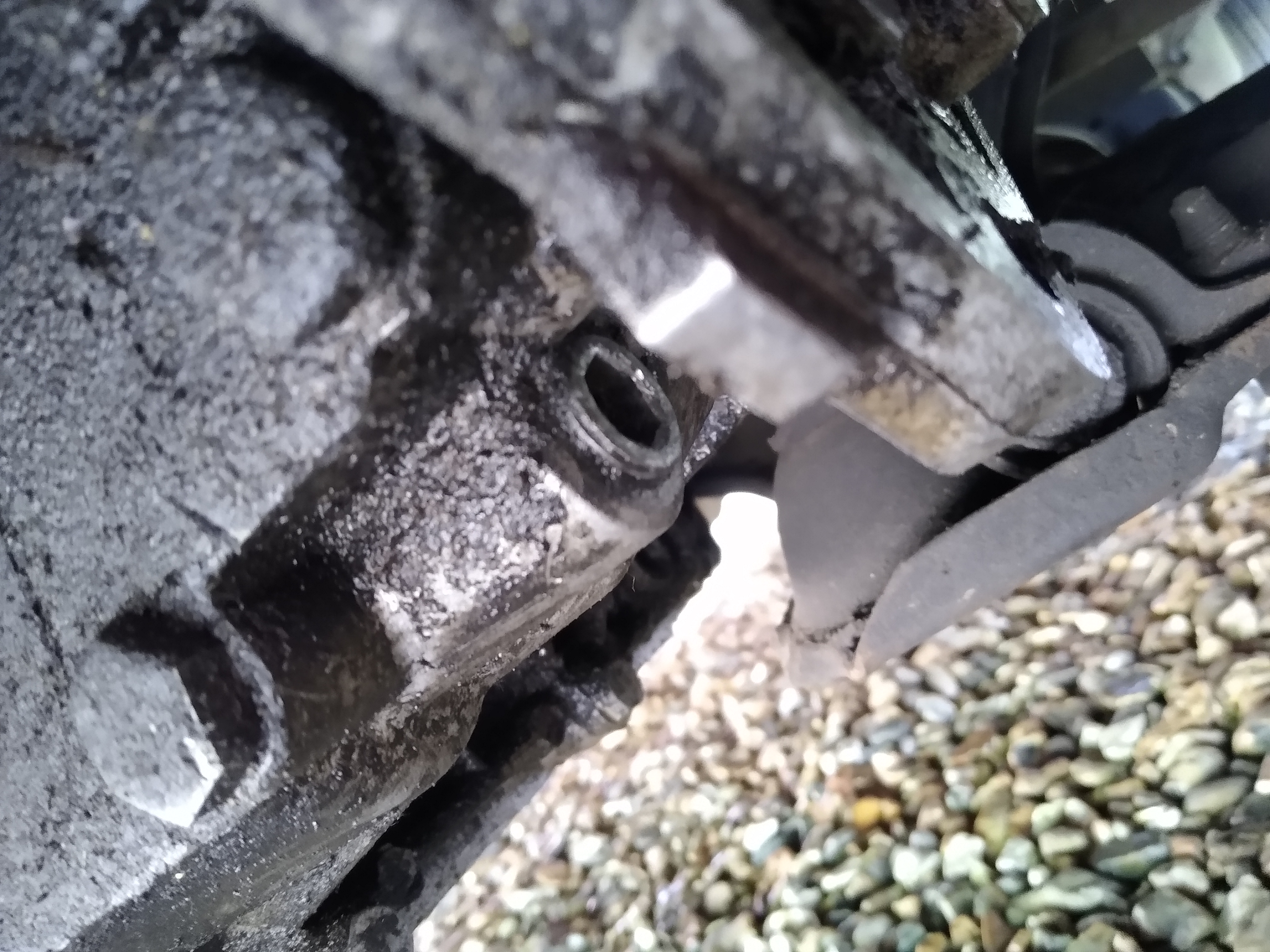

This is where my drain plug is on mine, and I can't get a socket in there.
I recognise that one near gearbox end plate ....but there should be
another one as in my photo at very bottom adjacent front of subframe where wishbone front bolt fits.
The one in your photo isn't used during gearbox drain /refill and as you say is not 12mm
Yellow arrow pointing to where bolt retaining front of wishbone is just out of shot

I can now see it in your photo ha ha ha
It's a good job you didn't get the one you were trying to remove undone as it would have been a very unsatisfactory transmission oil change.
Yep that's just wrong.
Ignor the "fill" labelled point .
Fill through the level point.
To fill I use a length of hose and a funnel from above ,pour slowly , take time, much easier.

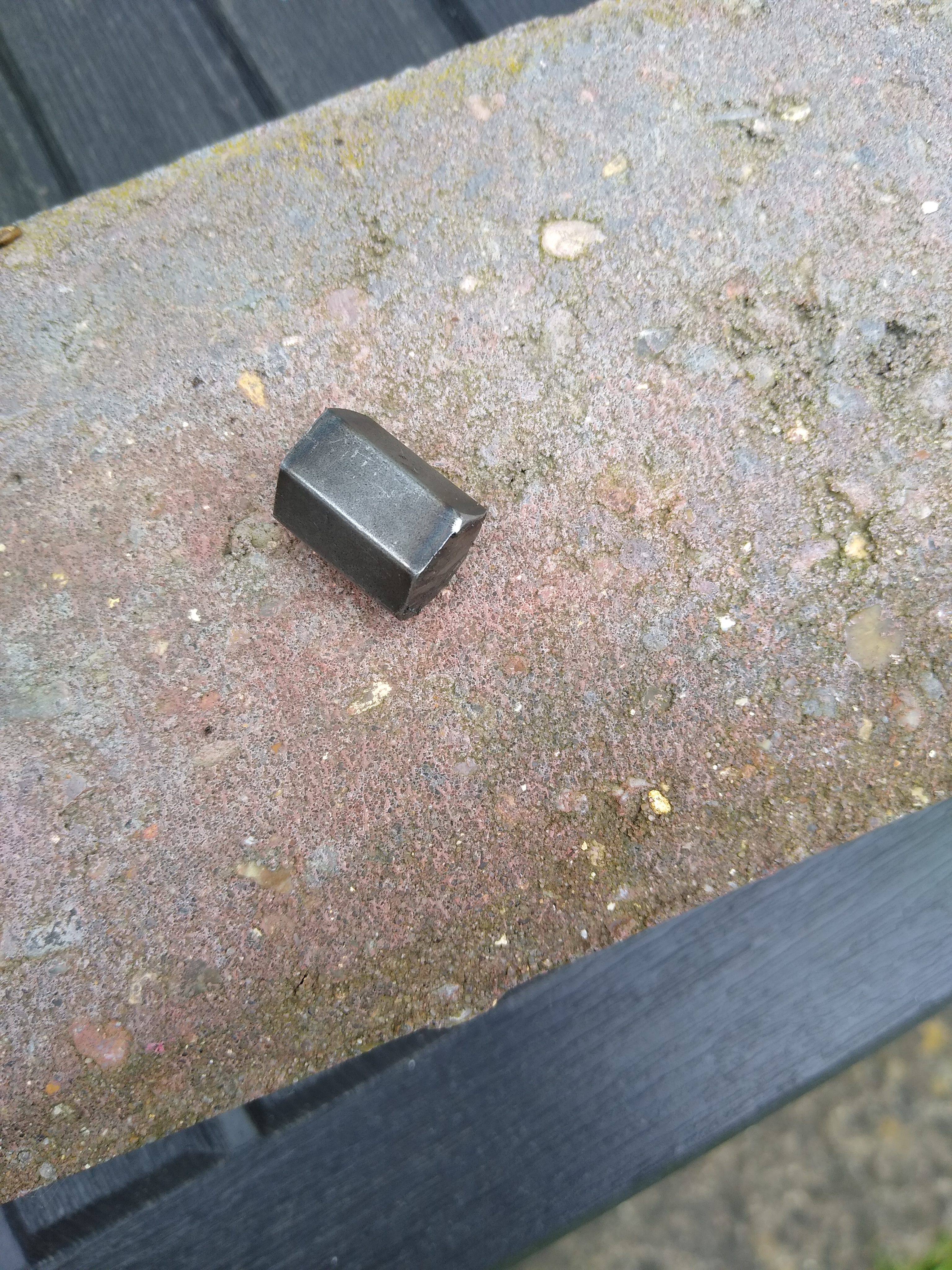

I recall on my 1st JTD motor {105}
The plug was so chewed (DESPITE FIAT FSH.. )
that I had to grind 2 x flats and wind it out with an adjustable ( @21mm flats)
New plug felt VERY Nice and was only @£7 back then from FIAT
Finally got an hour to change the gearbox oil ( now I've been shown the correct drain plug!!).
The drain plug was absolutely in tight and put up a fight before undoing, but I got there in the end and it had a bit of metal swarf on the end of it. The oil that came out looked ok, albeit a tad murky, and I got just under 2 litres out and I managed to squeeze 2 litres back in.
A quick test drive resulted in absolutely no discernable difference, but new oil has got to be a good thing?
