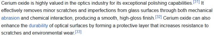

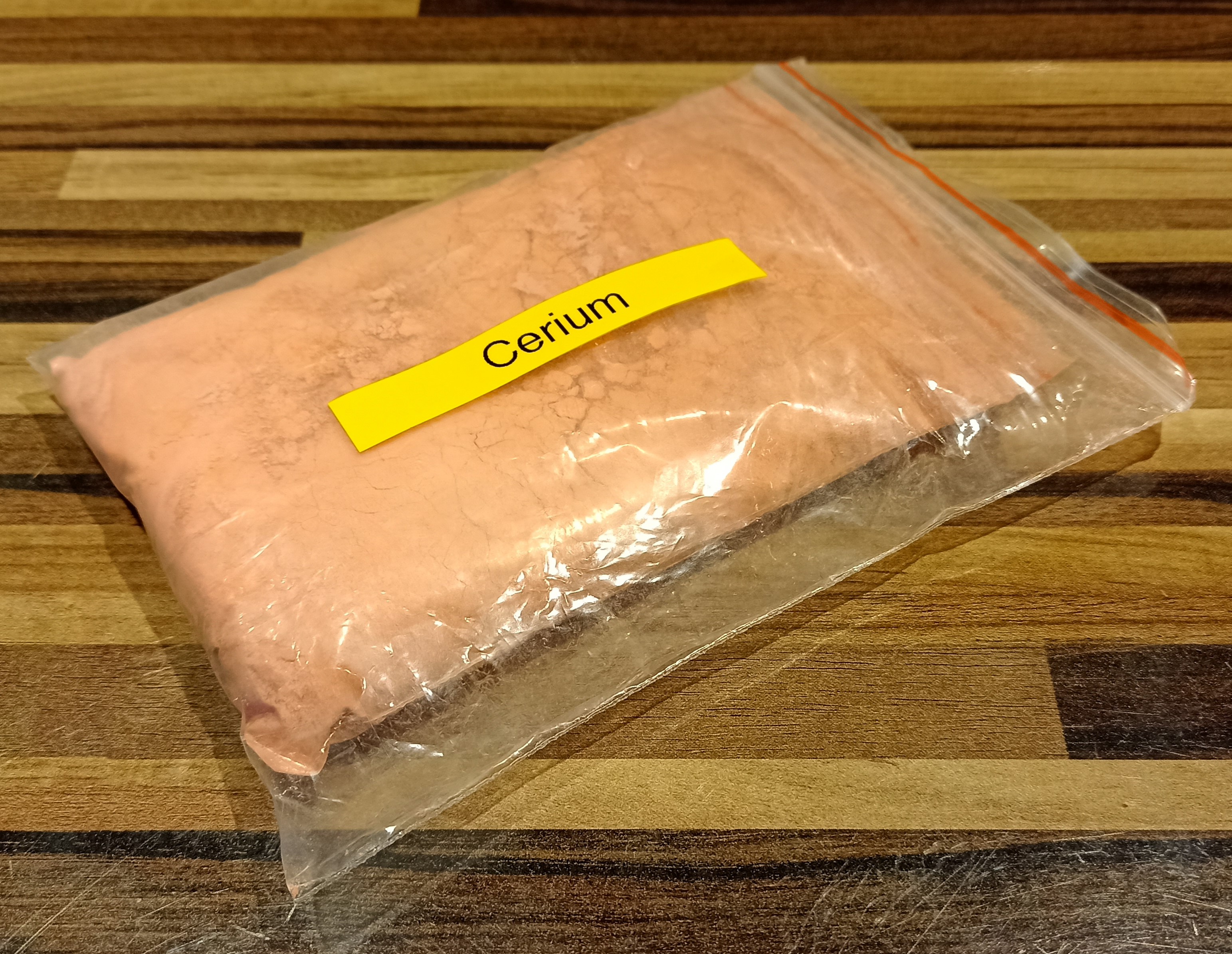

Cerium Oxide is used by jewelers for polishing precious stones. But at 5Euros/100g there's little stopping us from applying it to glass as well. Wikipedia has this to say on the material:
Warning: Cerium Oxide is a highly abrasive and very fine powder that will find its way everywhere if not handled with some care.
AFAIK it's not poisonous as such or harmful to your skin. But it will stain anything it gets onto, simply by clinging onto it.
Stains can be removed with water aplenty, but do try to contain it on or near the glass area. And, for obvious reasons, don't try rubbing off spills ...

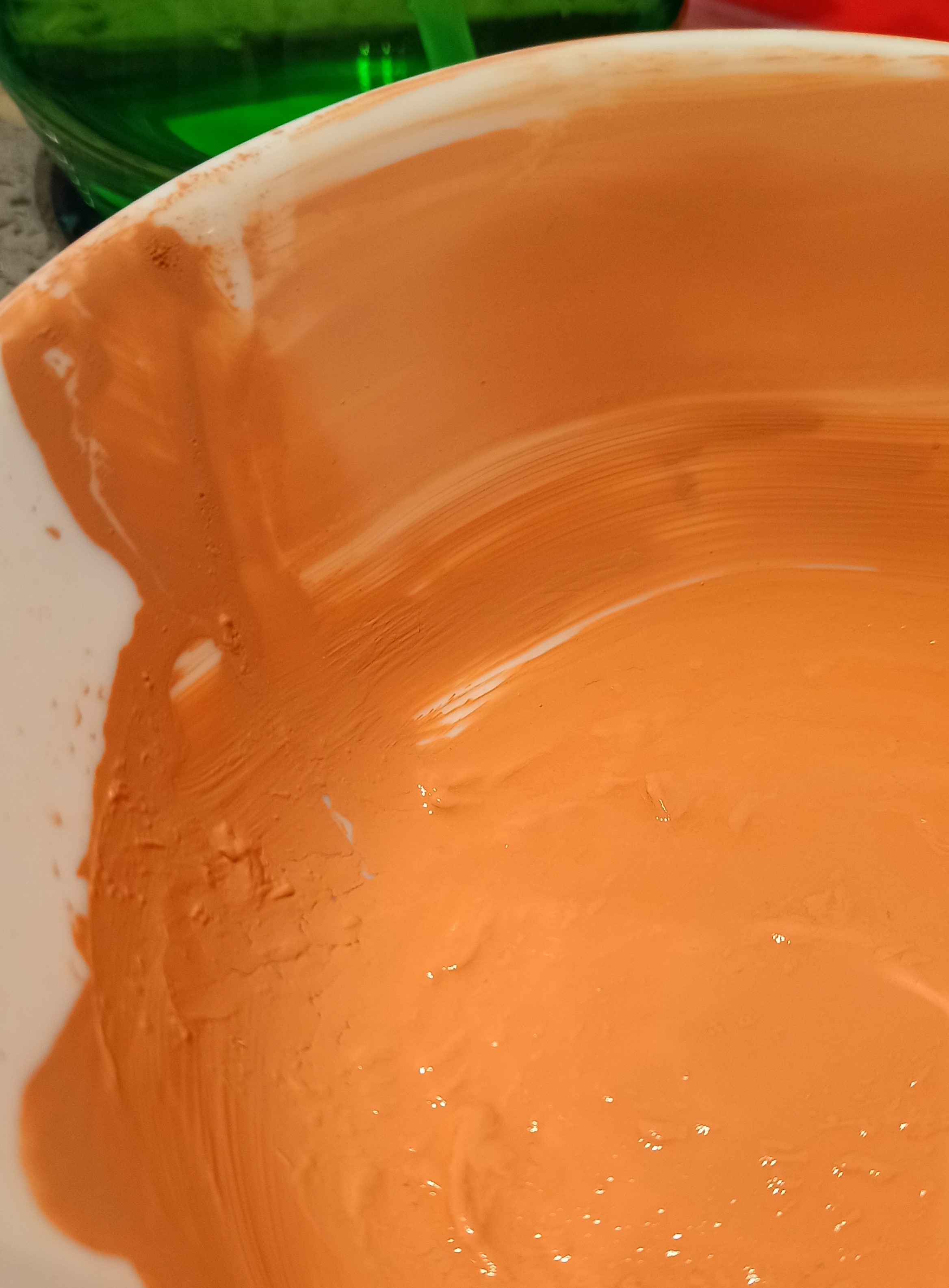

Put a teaspoon-ful of Cerium Oxide into your container. Add a very small amount of water; like when mixing cement, you have to go slow, adding only very little liquid as you stir.
Aim for a cream/yoghurt-like consistency; this will allow for easy distribution onto the polishing sponge.

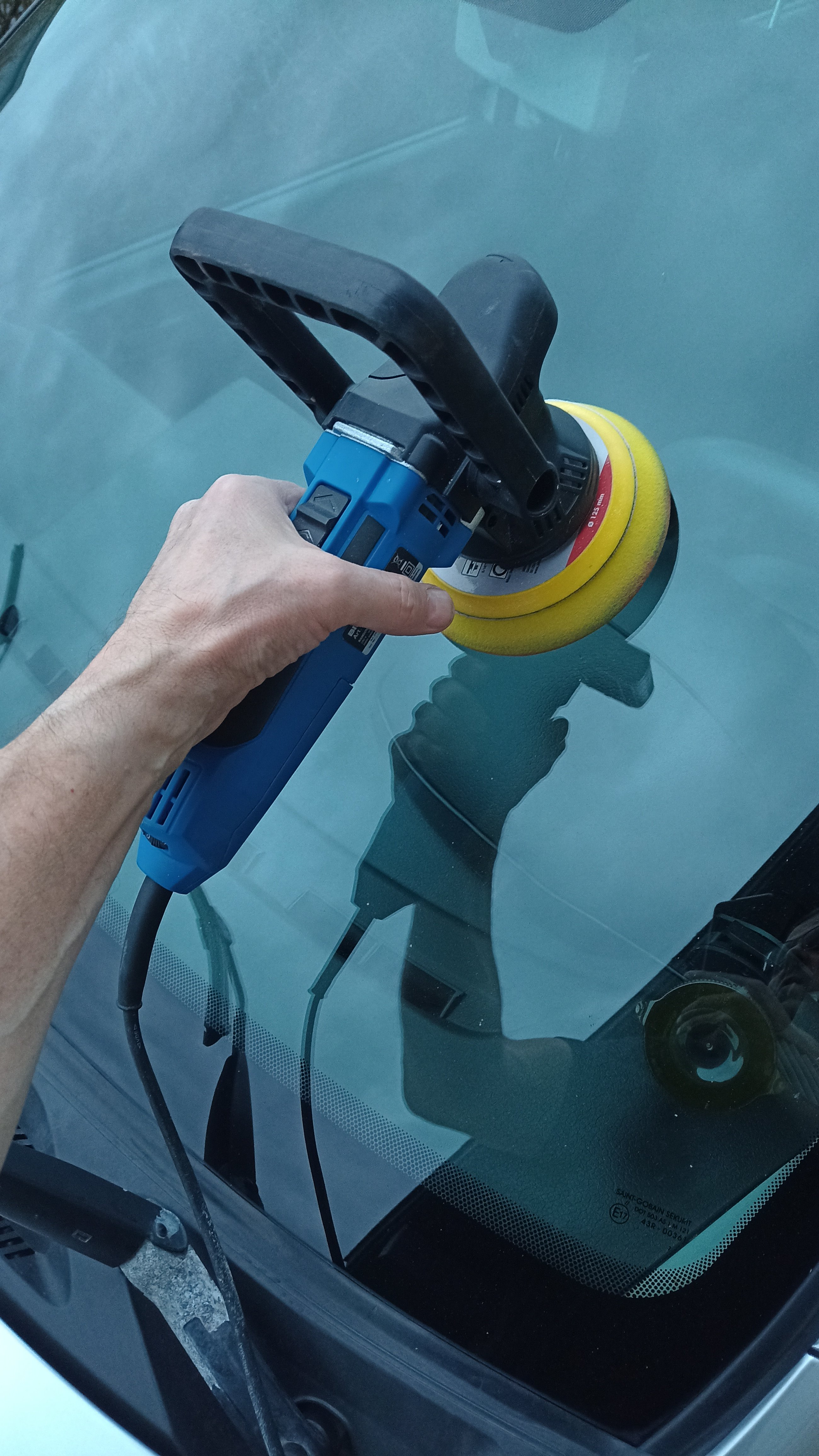

Next, place the polishing sponge onto your polisher. The DA is meant for paintwork maintenance and will be gentler/less effective than the angle-grinder-like rotary polisher - you will have to try and see what works best for you.
Apply a bit of water to the polishing sponge with the spray bottle, then dab a few blobs of cerium mix onto the sponge and quickly slap the machine onto the windshield to avoid spills. Then start polishing; slowly at first to get a feel for things.
Aim for a moist/wet-in-wet process, adjust with the spraybottle and work your way over the glass in sections, criss-crossing and adding a little blob of Cerium now and then.
Take your time. Avoid getting the glass to heat up from friction. Depending on the state of your windshield, I'd say 10 minutes for a light touch-up, up to in excess of half an hour for properly worn glass. More if you have regular scoremarks/stripes from wiperblade metal-to-metal contact.

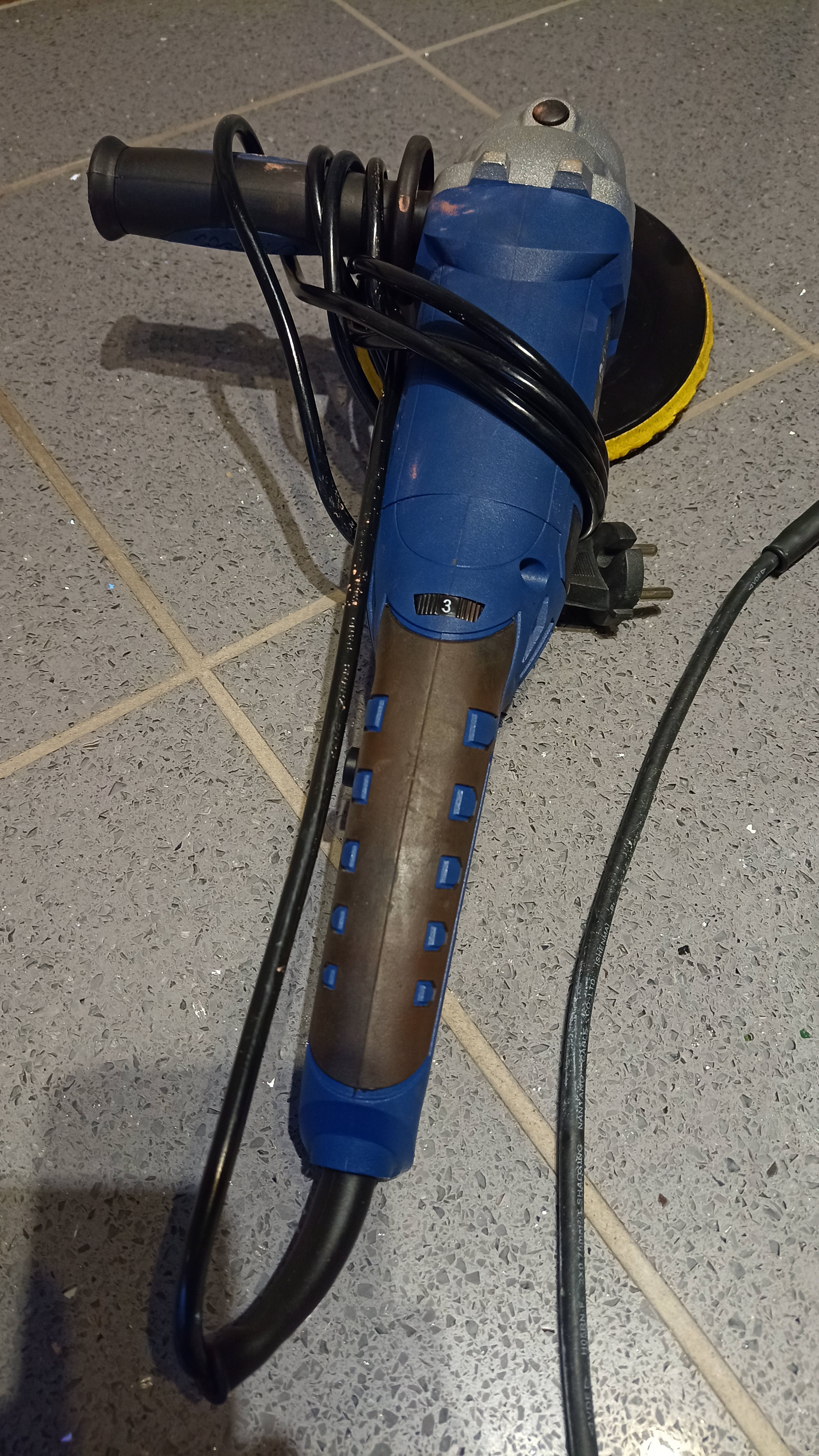

- A polisher with variable rpm (look for the adjuster in below picture; it's NOT an angle grinder!)
- or a DA (Dual Action)-polisher
- A suitable polishing pad. I've used fairly hard sponge pads with nice results.

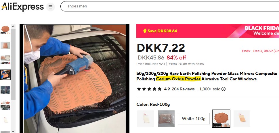

- Cerium Oxide. Get it on eg AliExpress, where a 100g sachet of powder will set you back 5 Euros or so (2024-price):
