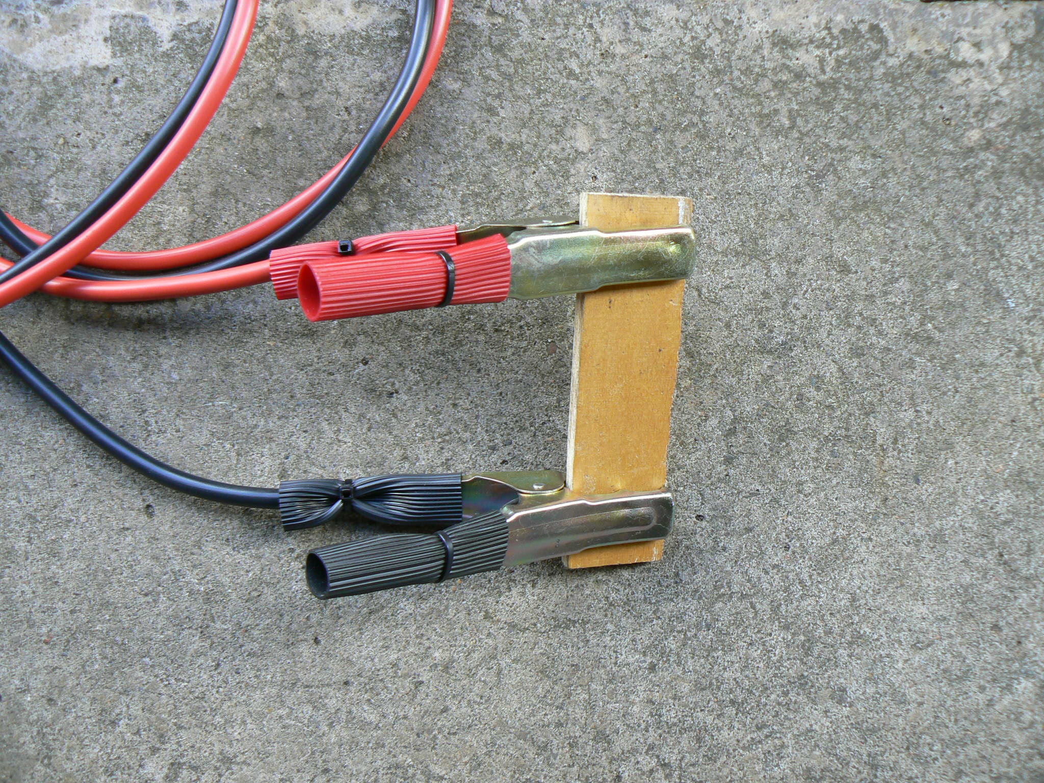

On the subject of avoiding short circuits, one of the "novice's" traps many fall into is forgetting to ensure the cable clamps on the "other" end of the cables can't touch each other. For that reason I've always had the clamps on one end of the cables attached to a wee piece of wood until I actually need to attach them:
Now, even if I connect both clamps on the other end to the battery, I won't get an accidental short.
