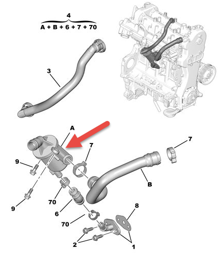

At the beginning when you mentioned taking the intake pipe off, I suggested, "When you say it is leaking oil from the intake pipe, do you mean the side where the air cleaner is or the side nearest to the inter cooler?" This would have told you if it was a turbo fault or an engine fault where oil is forced out of the breather before the turbo and then sucked in through the "good" turbo.
Re the white smoke, I have had a 1.6 MJ that had a faulty turbo where the bearings had gone and you could feel excessive movement, this allowed the oil lubrication to go past the worn bearing and burn in the engine. Even with the new turbo it took a long time to get all the oil out of the intercooler and pipework so that it would stop smoking.
hey again, been busy last few days just got home,looking at the turbo i took of the side thats not conected to the exhaust, the side thats connected to the airbox, and after what you said the turbo may be ok if oil is being sucked up to the turbo , i will investigate tomorrow as when i said i think the tubo is leaking because i saw the oil in it from that side so i may take off the intercooler too and see if oil got into it, also want to check the pcv valve like cybor mentioned, as its not a sensored part the scan wouldnt have shown any errors with it so be good to see
