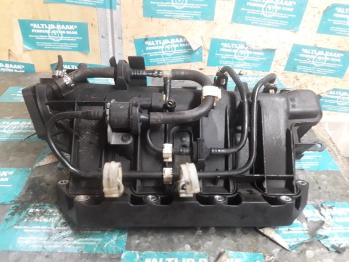

After a lot of tests, most common solution here is fresh fuel because evap system is very "thought" for this engine. My car started perfectly while the fuel was fresh. Then, for a period of 1 month it worsen and was almost impossible to start it. No any errors in the modules. Check how many pipes are on intake manifold. Because of the constant breathing, the fuel got worst. Compare to the concurrent's manifolds of Ford focus, Peugeot 307, honda civic, where such piping does not exist
