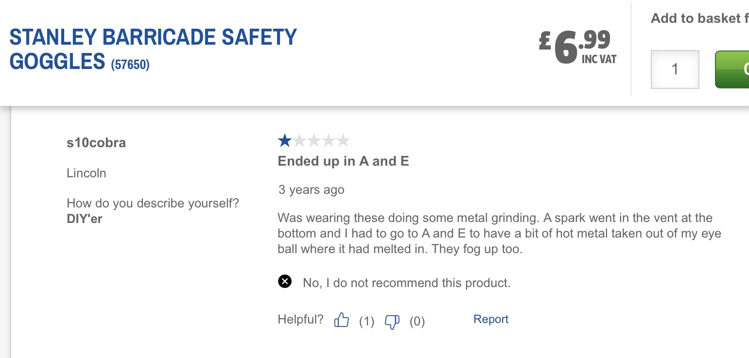

cool, so new fear unlocked after looking at safety goggles. 😭😭😭
I used to get a lot of rust in my eyes, buy some safety glasses, they only cost a few pounds.
You won't be doing any grinding for this task, you'll want to avoid oil and rust getting into your eyes, nothing fatal, just uncomfortable.
thankyou. I really should use some while cutting the connifers and stuff, as that wrecks my eyes, so getting some for this might make me wear em for hedge trimming.
narrator: it wont.
