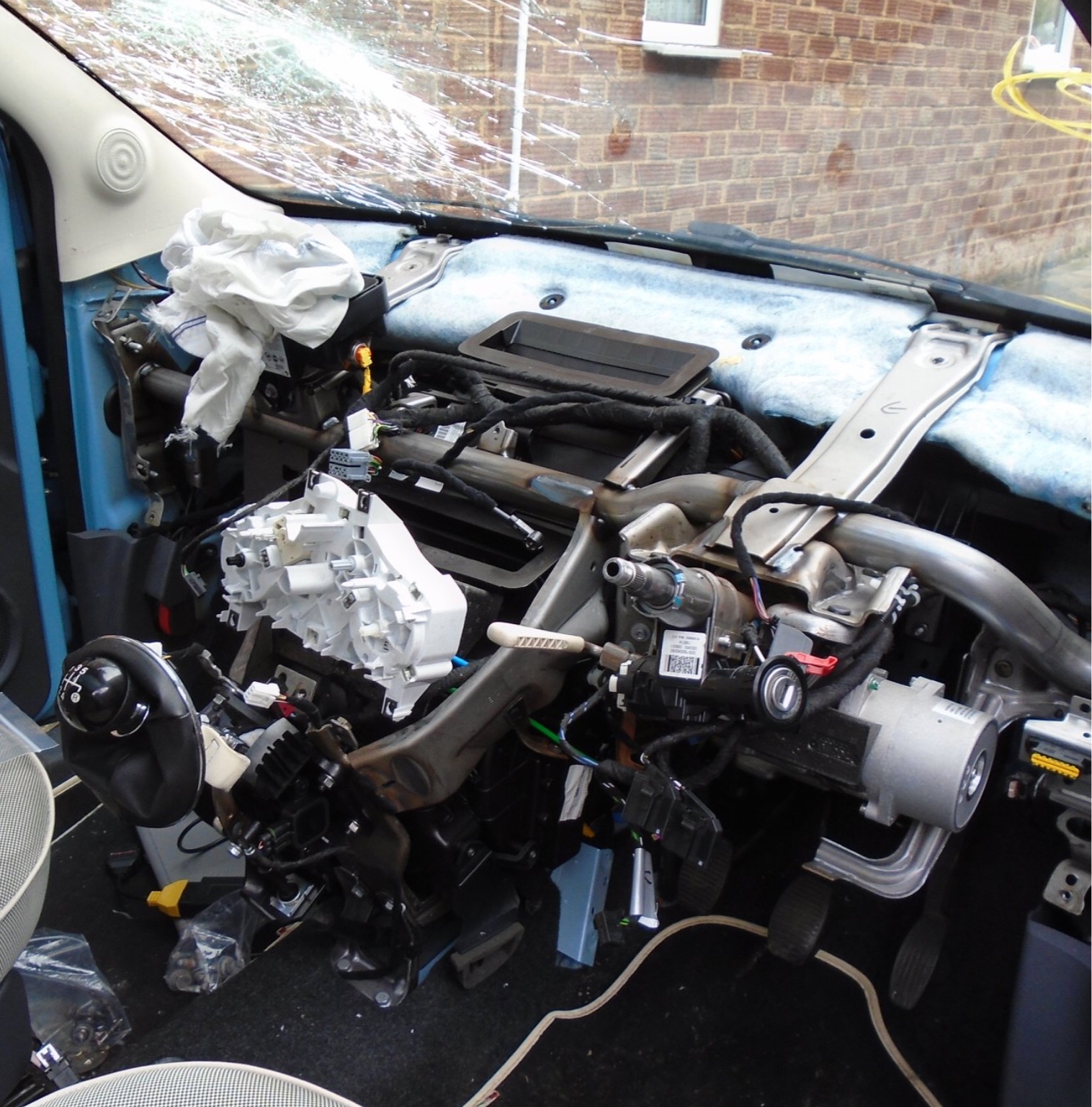

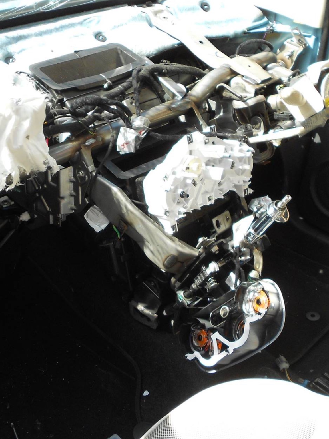

IMG_3204.JPGIMG_3205.JPGi don’t know why you would need to remove the doors unless some of that metalwork you can see in these pictures needs to be removed meaning that the door hinges need to be removed. Maybe these photos will help.
My next car which is coming Tuesday will be needing dash and airbags so I’ll look in more detail when I take the dash out if you’ve not figured it out by then.

View attachment 189491View attachment 189492i don’t know why you would need to remove the doors unless some of that metalwork you can see in these pictures needs to be removed meaning that the door hinges need to be removed. Maybe these photos will help.
Wicked thanks, specifically interested in whether I need to drain the AC, as that'll be the only thing to cost money.
Any close ups of the flap/Mechanism would appreciated too.
I’ll most likely be taking the old dash out on Friday which I intend to video anyway, but I’ll do a separate video of the heater and try and take some detailed photos.

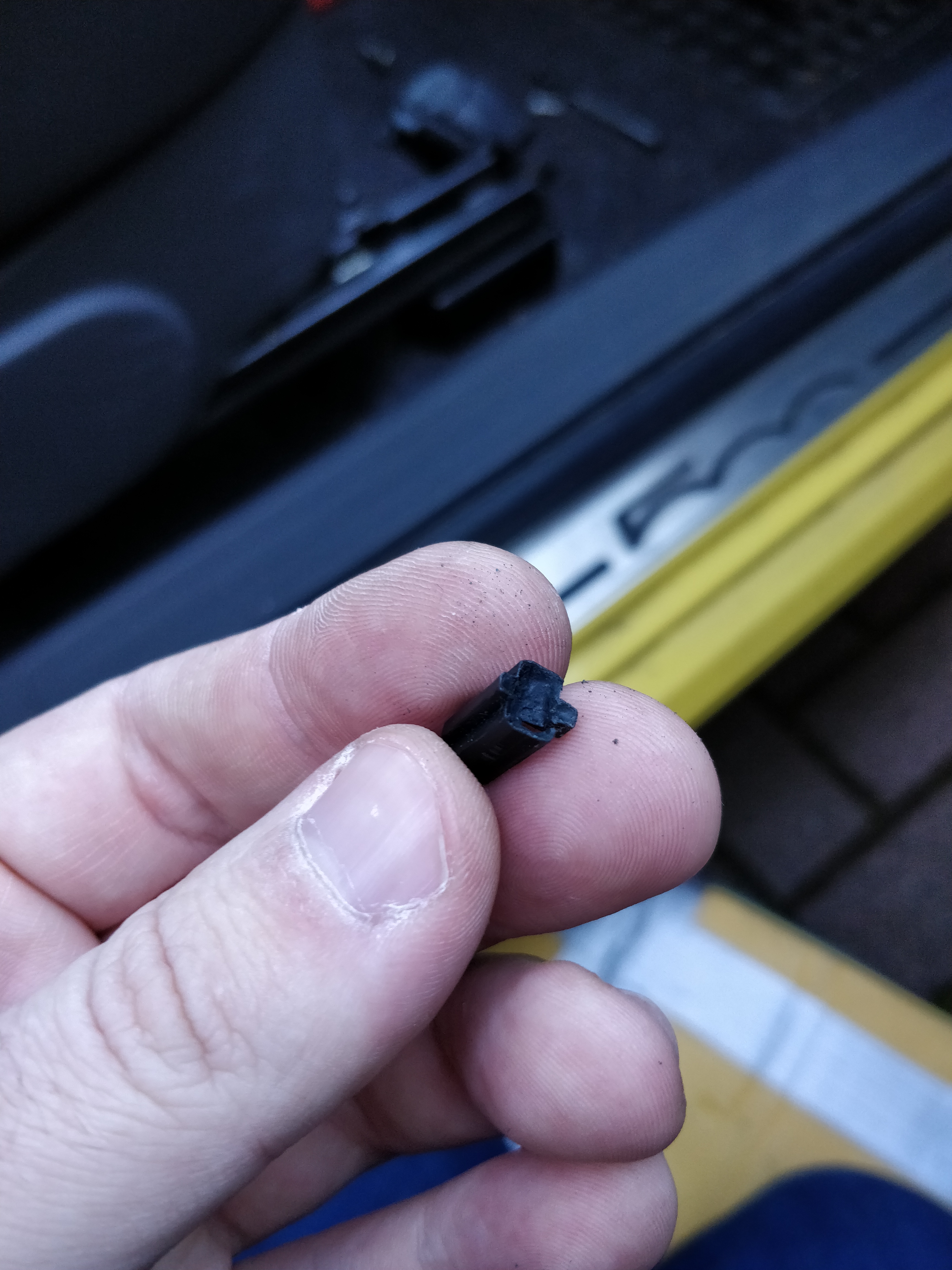

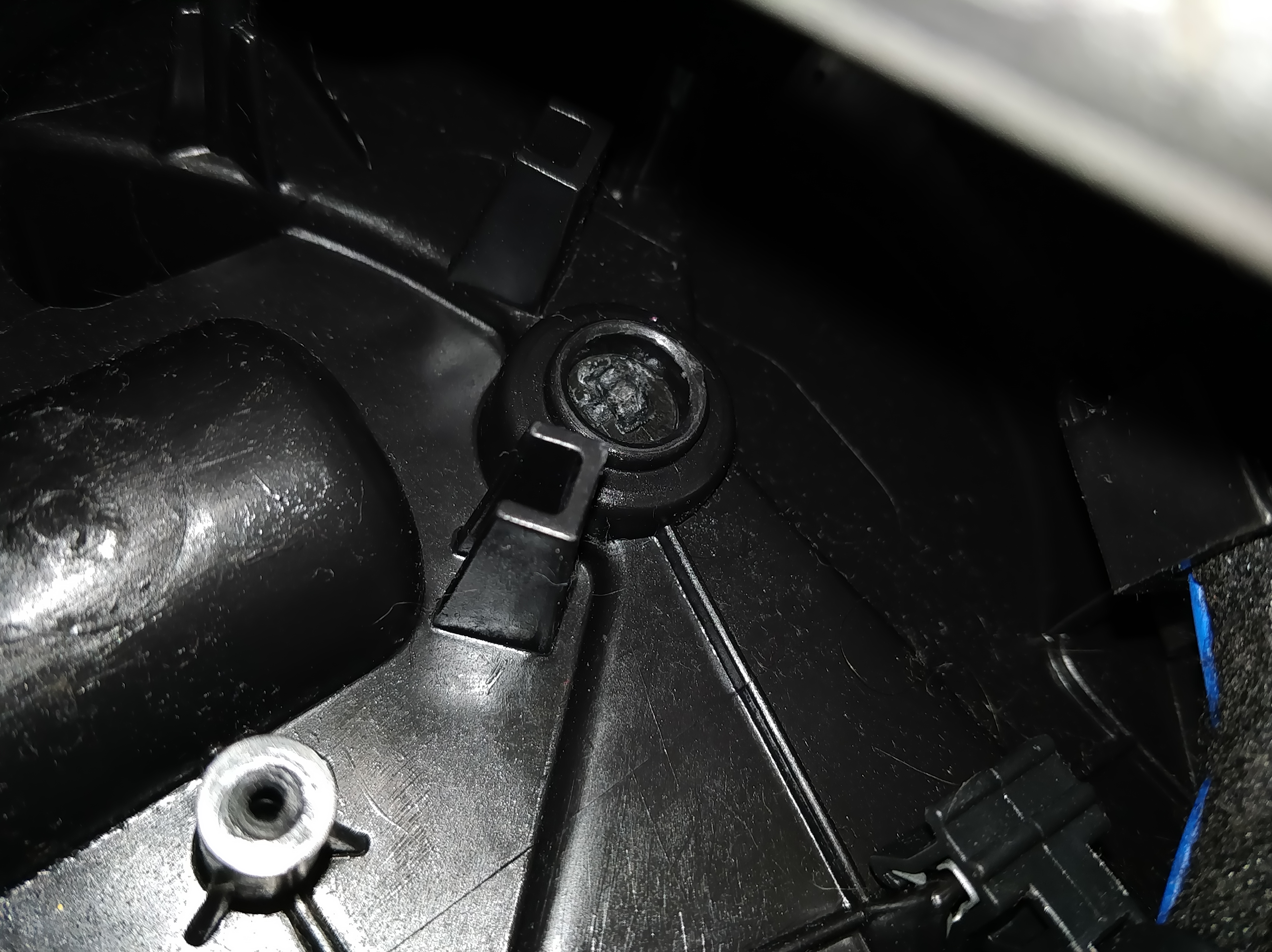

So I never bothered sorting this. I asked a mate who is a mobile mechanic to have a look when he did a service if he could do anything, he pulled off the heater controller motor which you can access from the drivers footwell. The motor engages on the flap pivot with a keyway shape mine had sheered off.
I'm gonna have I think but I am trying to glue/screw something in to replace it and interface with the motor.
Long story short this could be a 20 minute fix. When I have a go I'll post pictures hopefully it will help some others out and they will not need to rip out the whole dash.
Here's the problem...
The metal bar is too close to get a drill/screw in but I'm wondering if I can remove it without ripping the whole lot apart. I don't think it is the main bar it appears to hang off of it. Can the lower dash trim be removed easily?
Currently I've fiddled the flap to hot and jammed a drawing pin in it so at least it is warm at the moment. If I can remove the bar I think I could get a couple of self tappers in and possibly have it locate with the heater control unit and have it "fixed".

Would "pipe weld" type glue fix it used on poly pipe? Or heat a small flat bar say 5mm x 1mm and if possible melt it into the end in the hopes it doesn't swell and jamb it in the process such it won't turn then cut a key way in the broken off bit? Just a thought?
The problem with glue is I'm worried it will glue the moving parts together.
I had an idea of using a spline bit like this.
drilling a hole then heating the spline and melting it into the plastic. A flat bit of metal might be better.
Or trying to build something to screw into the side.
Currently it is wedged to hot with a drawing pin.:D At least my missus is warm now!
Big issue is type of plastic used for mouldings. A common plastic for this stuff is polypropylene for which there is no effective glue. It's a waxy plastic so it sheds the grip of glues. But looking at the broken component on this thread and others it might be possible to drill through the axis of the broken bit of plastic with a tiny drill bit , doing the same to the component on the flap which its sheared off of and inserting a very small screw of maybe 1.5/2.0 mm to hold the broken spline back onto the flap end. I have this problem on my 2011 Abarth 500....and it may be this fault . But I'm going to check cabin temp sensor first!
