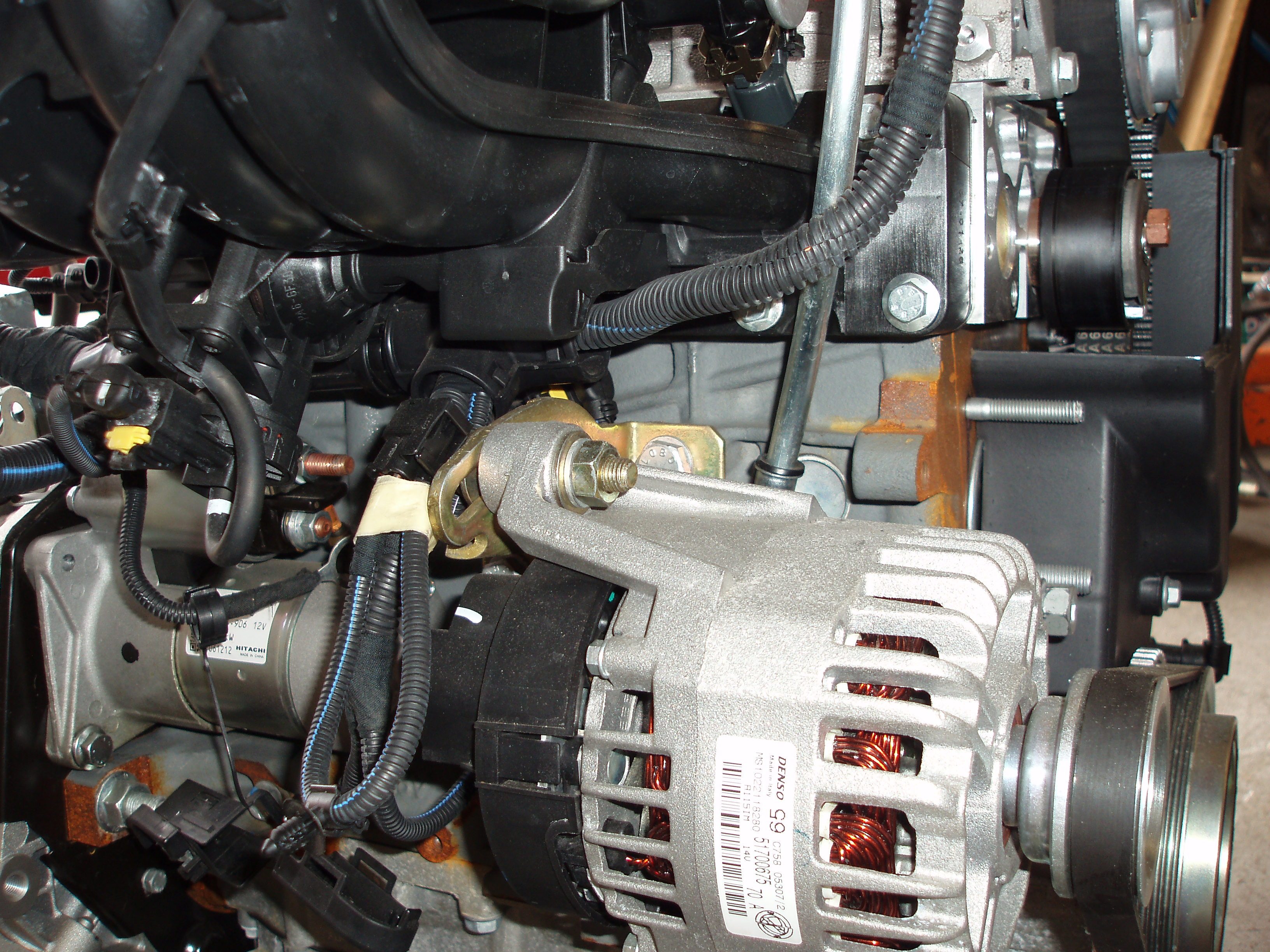

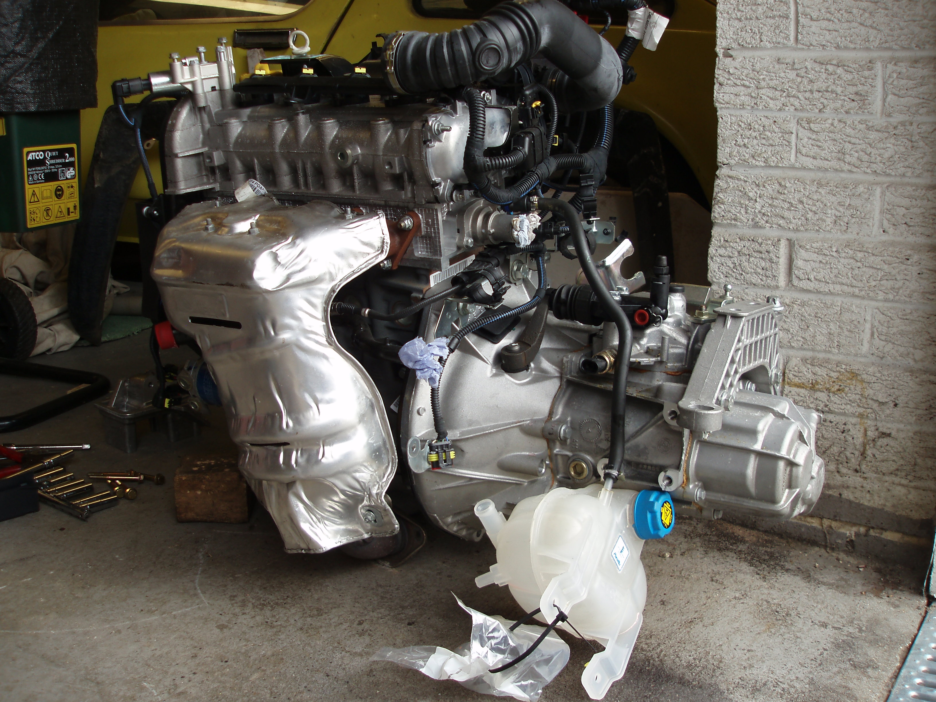

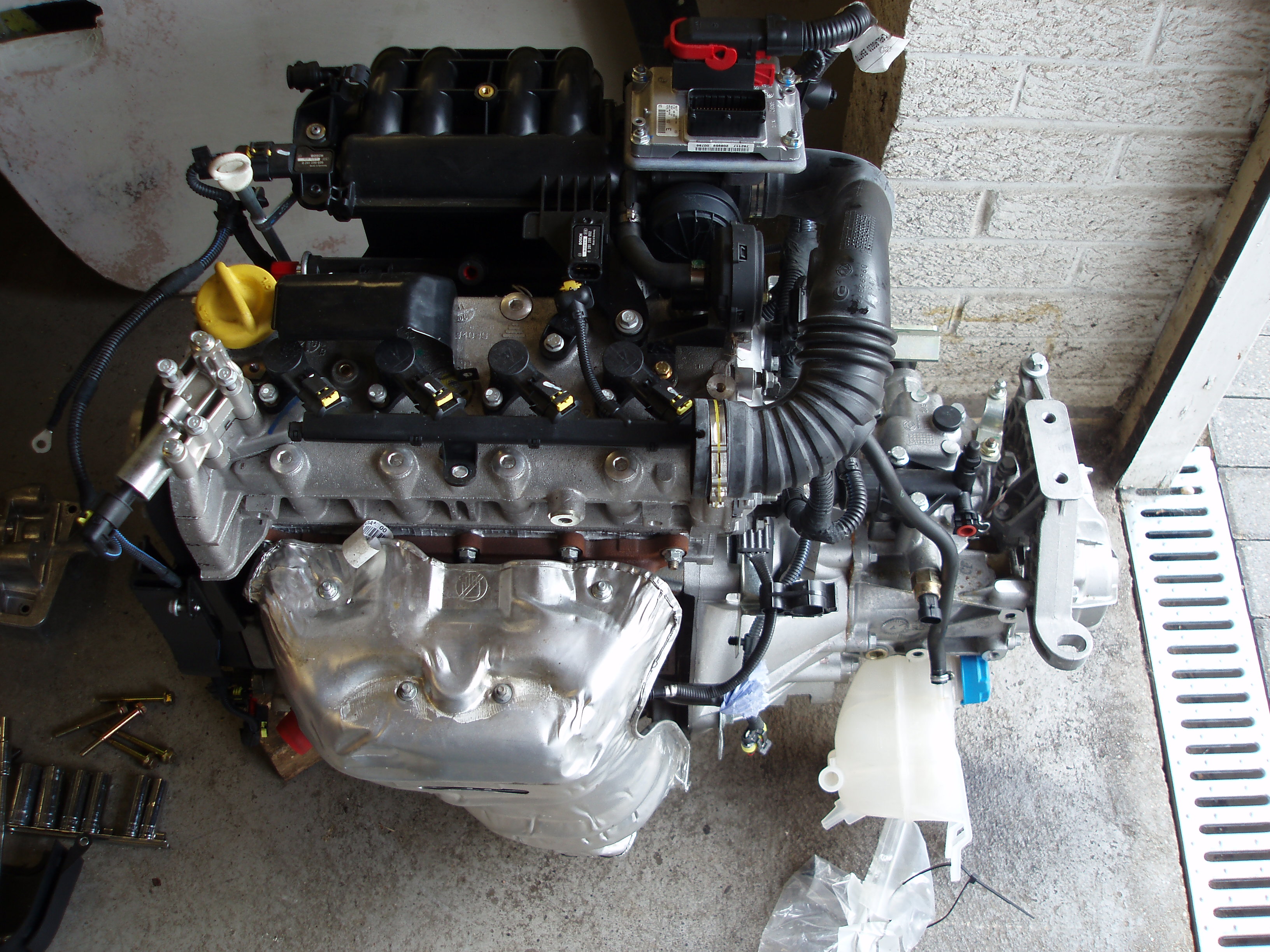

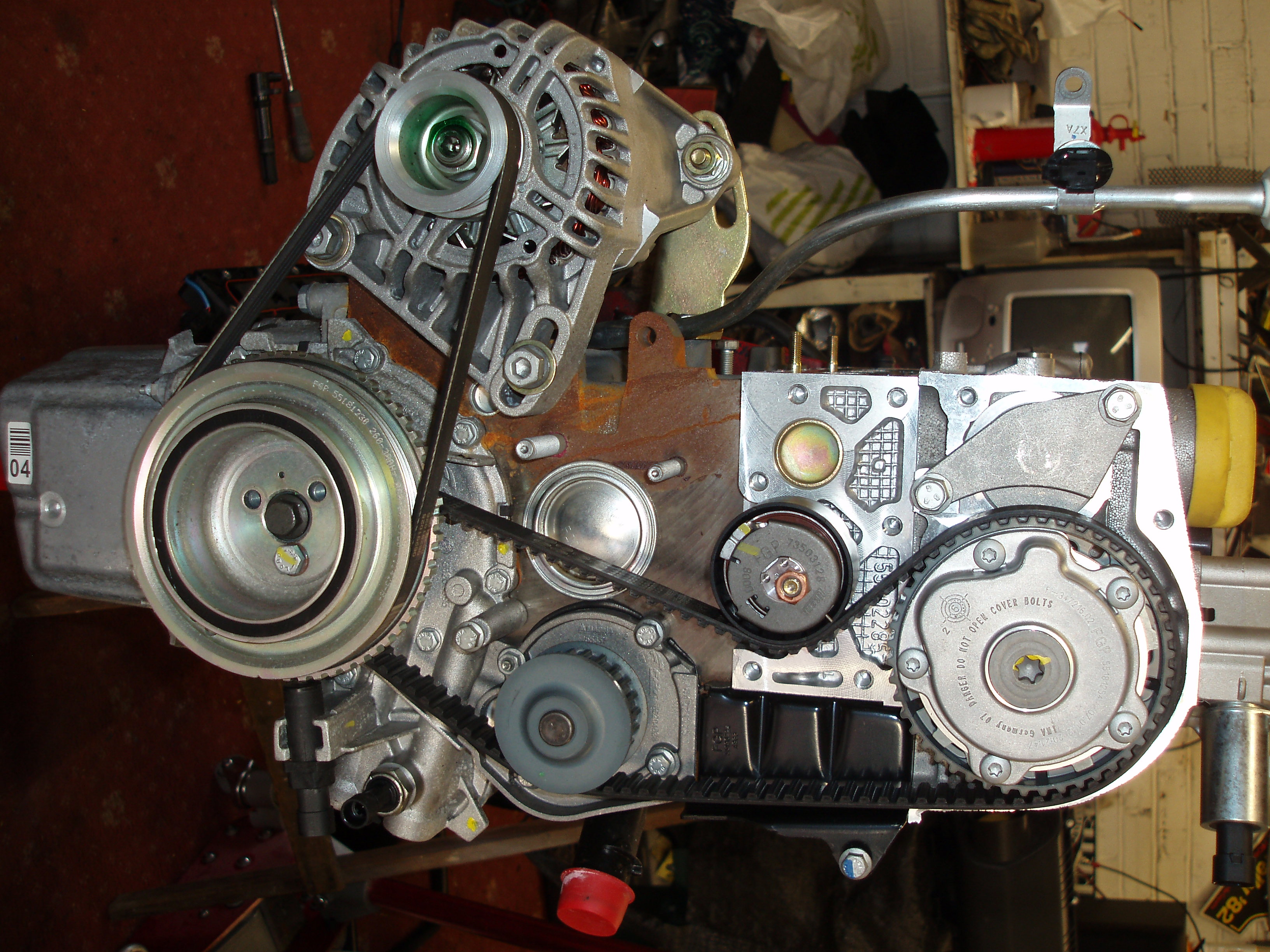

Its been a while since Team Lloyd did any projects, so yesterday we travelled miles to pick up this little gem!
Over the winter we hope to transform this cinq into possibly the first 1.4 16v with 6 speed gearbox, not sure if anyone has done it yet, altho have heard people thinking about it!
We now have the car and a brand new 1.4 16v engine and gearbox awaiting to be joined as one!
The photos:

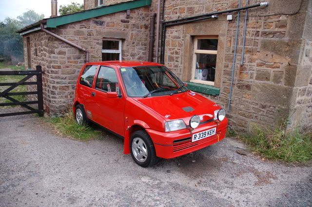

Just looking back at the pics, is that how high a standard cinq is!?!?!? Looks Soooo high!
you always seem to find Cinquecentos with them rub strips on the sides eh :p
I got a cinq with rub strips, they different to them ones though (and better IMO)...

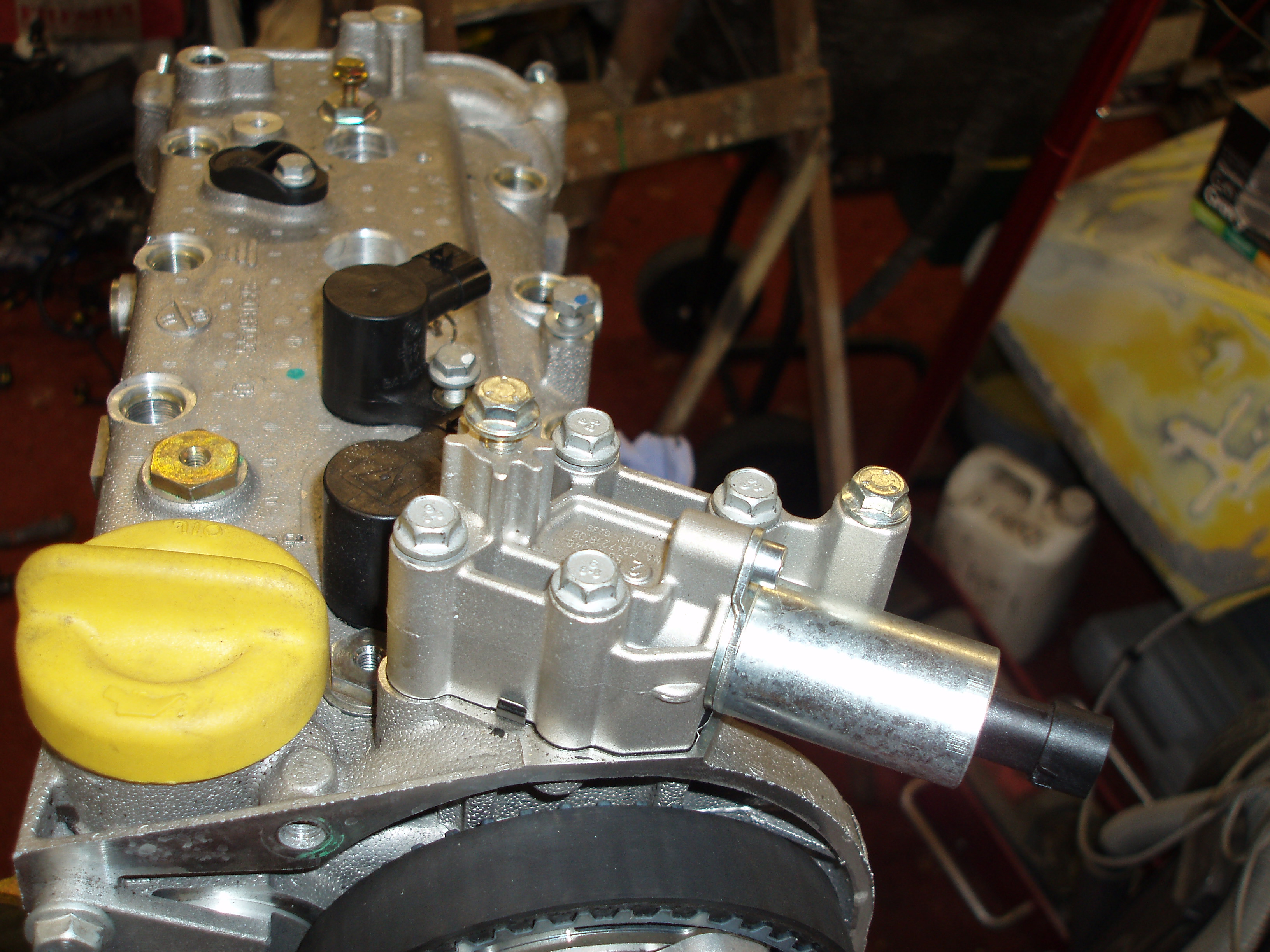

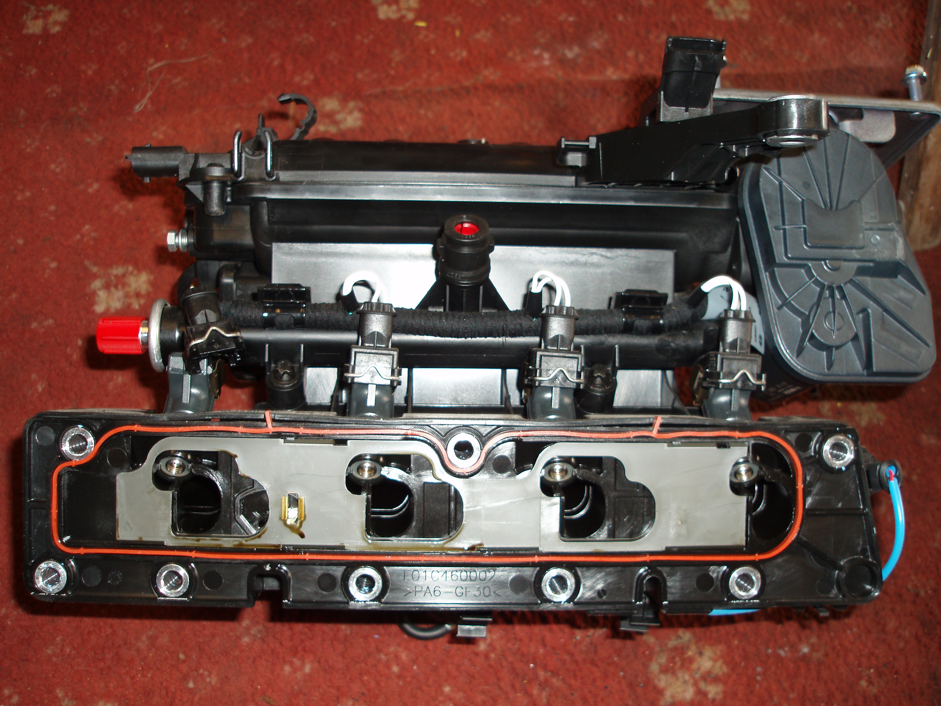

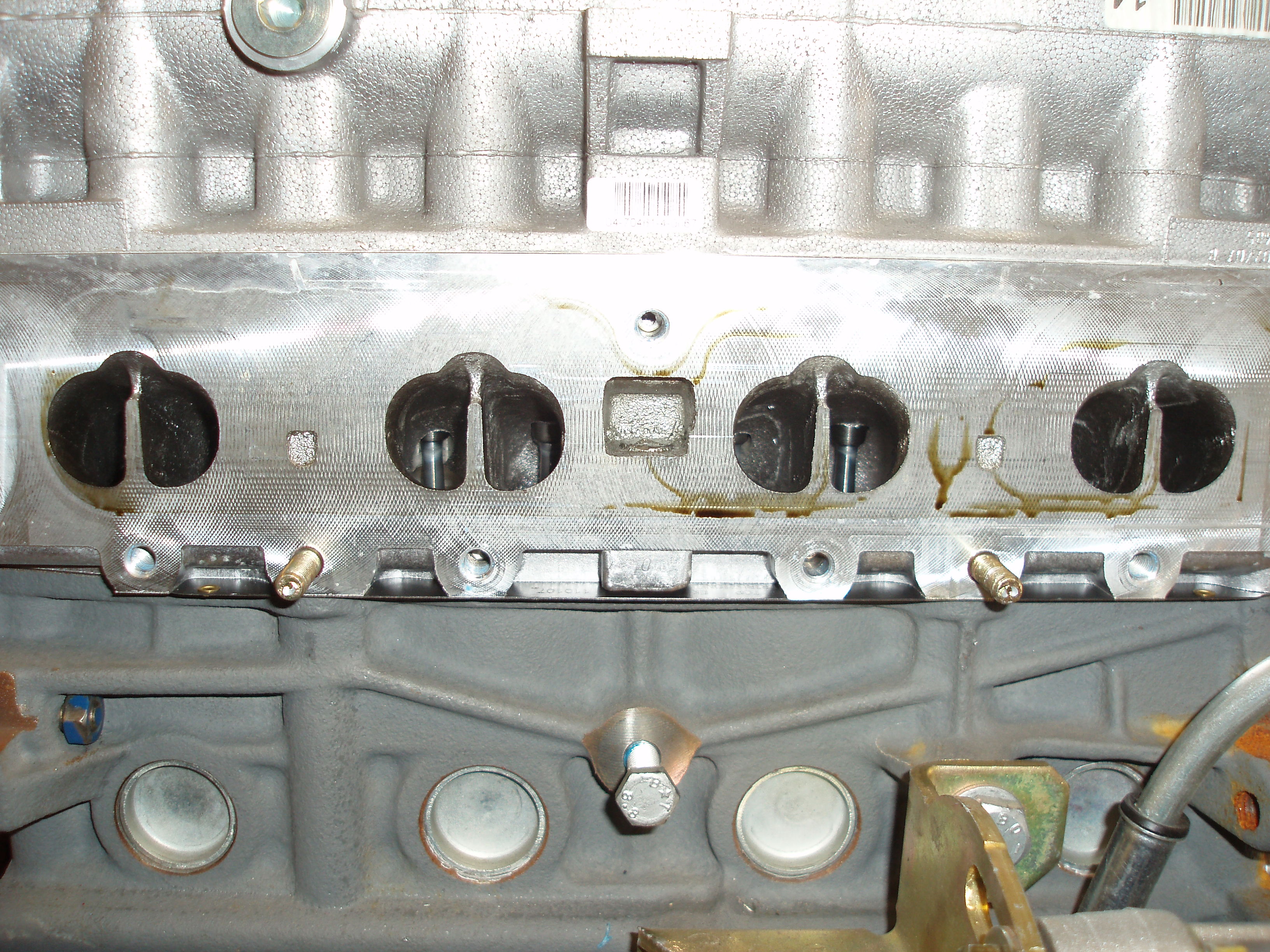

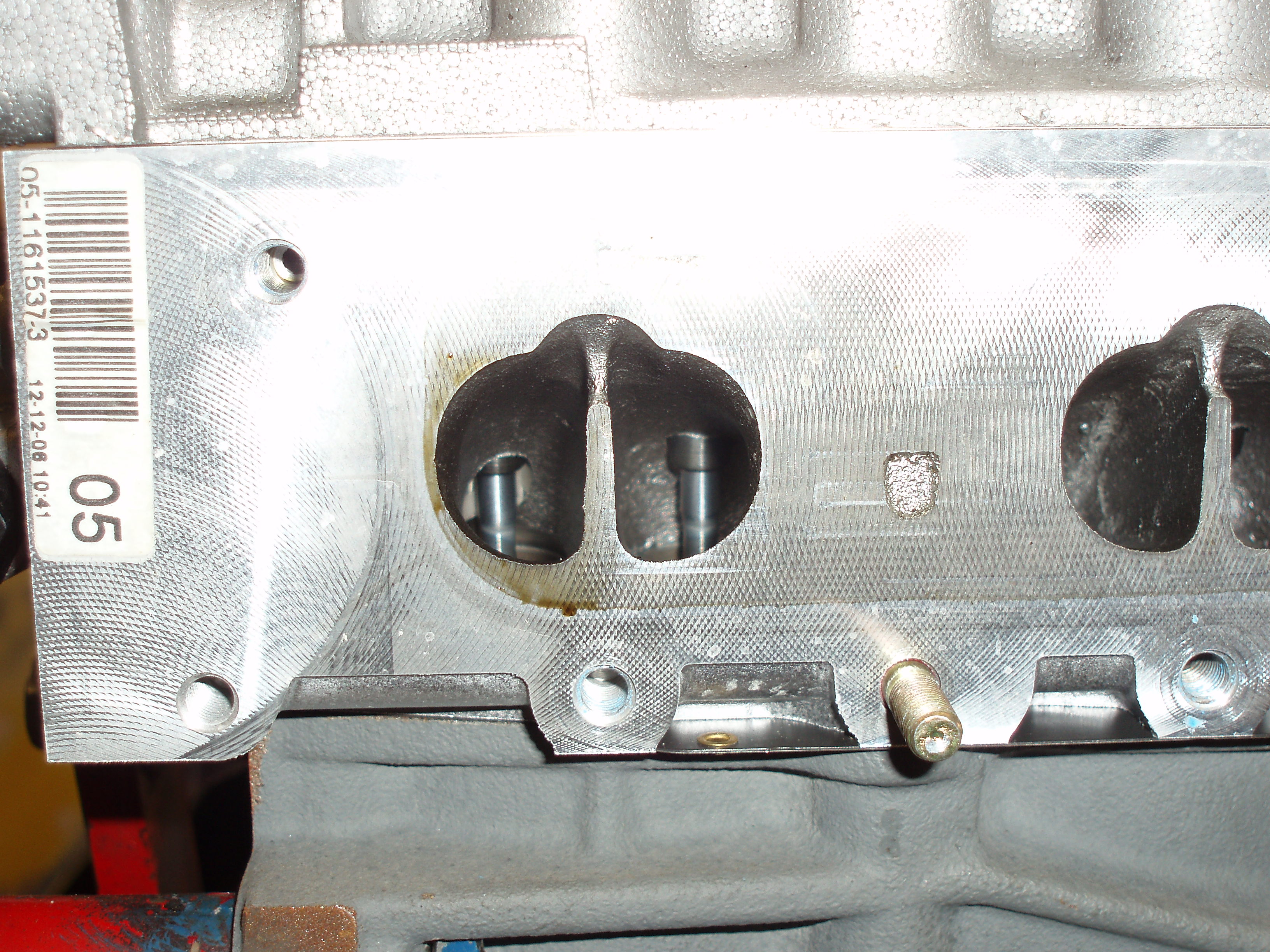

Yes the 1242 head has been thought of, the engine's head is in pieces at moment and weighing up different options.
Yes the engine was removed from a non-aircon Grande Punto.
