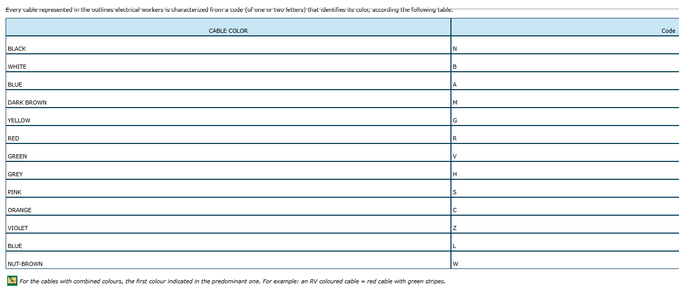

So what do the letters stand for on the manual.The colour code:

@Adam1984, you might take those and the previous table to the workshop, I'm not sure if they have access, so might be helpful.
Is that the fault code? If so BO is the junction box.
