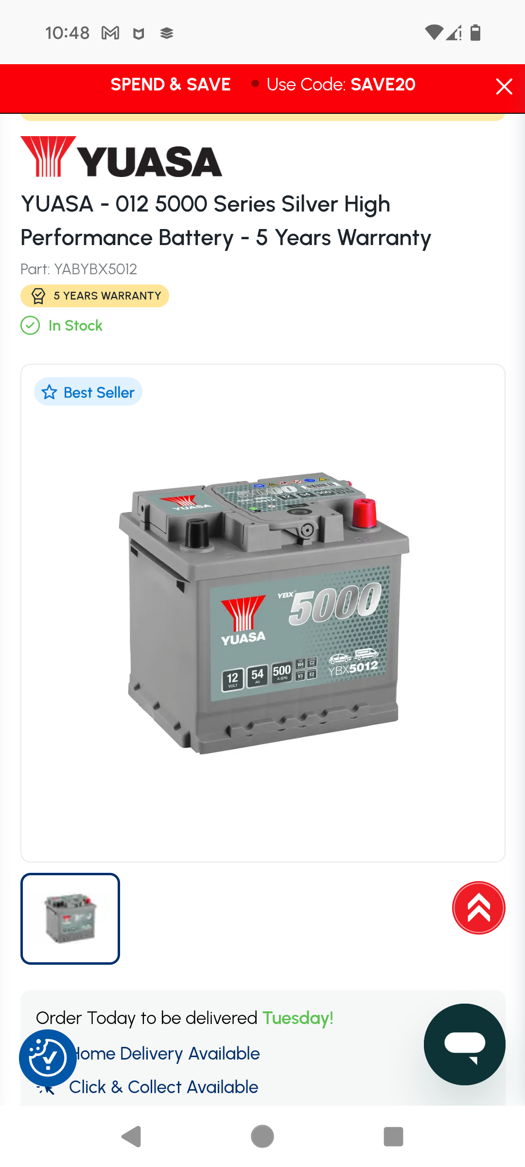

Ok so just get the battery for now then? My car has only done 59,000 miles.
So think this battery will be ok? I also went on Yuasa website and says this is also compatible.

I just got the battery from GSF car parts.
Is it normal for it not to be in a retail box of any kind?

My Yuasa came from Amazon (which was essentially directly from Yuasa themselves). Just a cardboard box. The 5000 should be plenty. Whether it clears your airbag light - dunno.
So it looks like after installing the battery, the airbag fault still exists, so was nothing to do with the battery, but at least I got a battery now that will last a good few years.
He checked the earth strap too and that's all in good condition.
