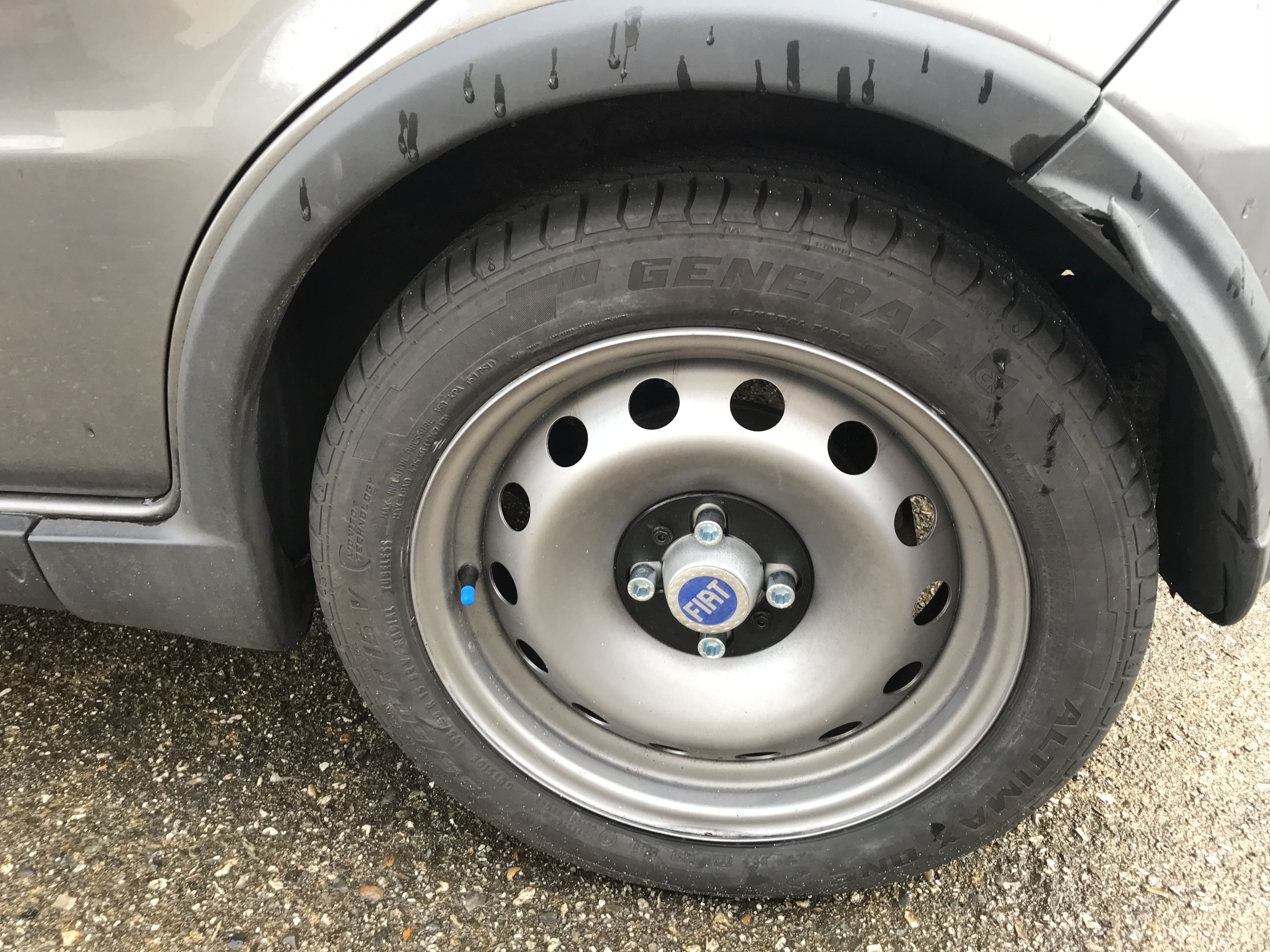

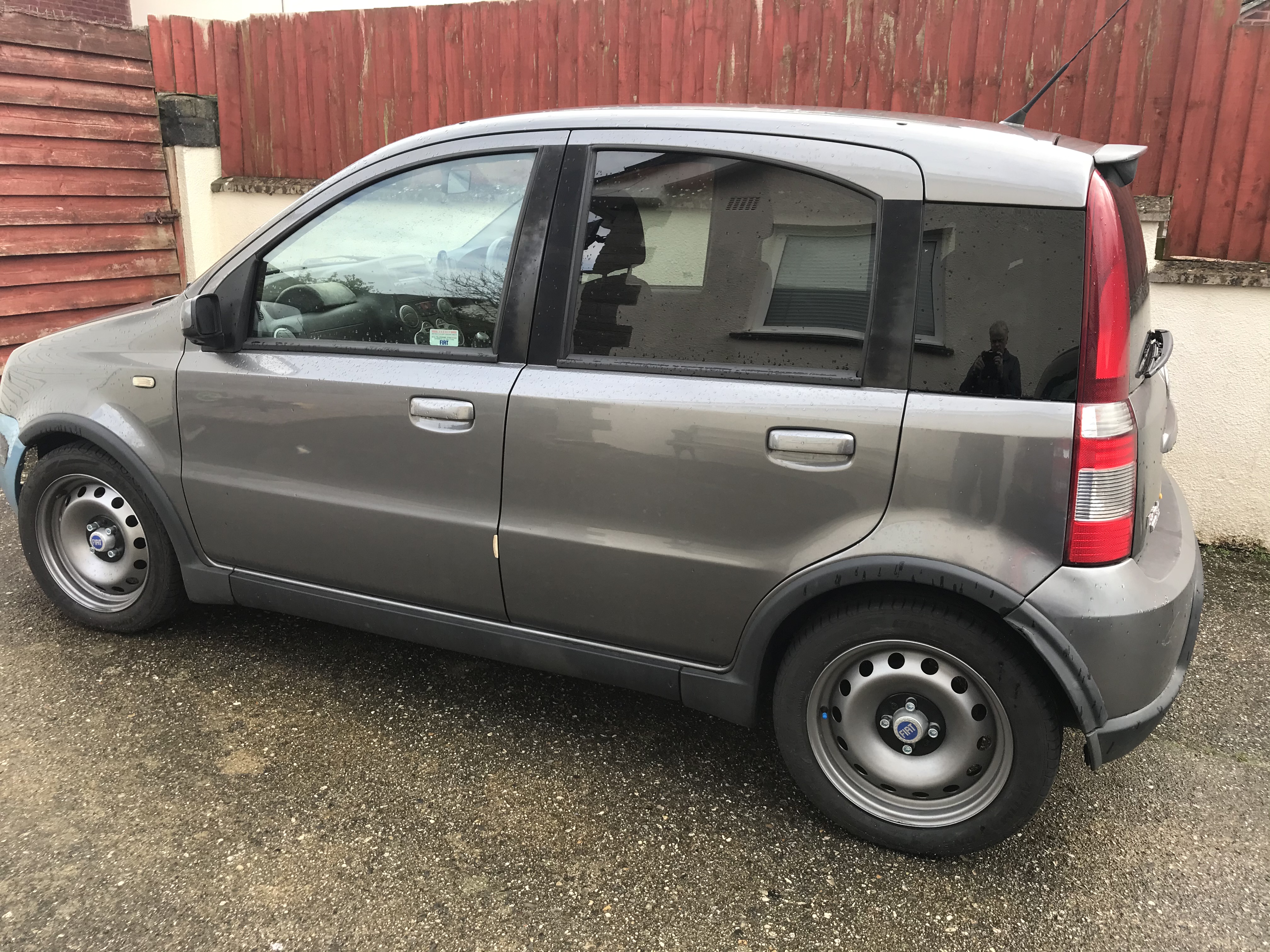

Go for a set of pepperpot steels in the same spec. Radius (deburr) all edges and get them powder coated (or better zinc metal sprayed with suitable primer) and they'll look great. You'll also need a centre trim but some time on eBay will throw something up.
e9ba60fe-5c31-4327-b92b-82dd704a22dd-jpeg.207048
c0e0cfc6-cf41-483b-96ee-ff10fa7b48eb-jpeg.207049
I used spline type wheel bolts and later added black slip-on covers. The wheels are now on the Multijet and painted in a Fiat white. My summer job is to lightly radius all cut edges and get them powder coated.
