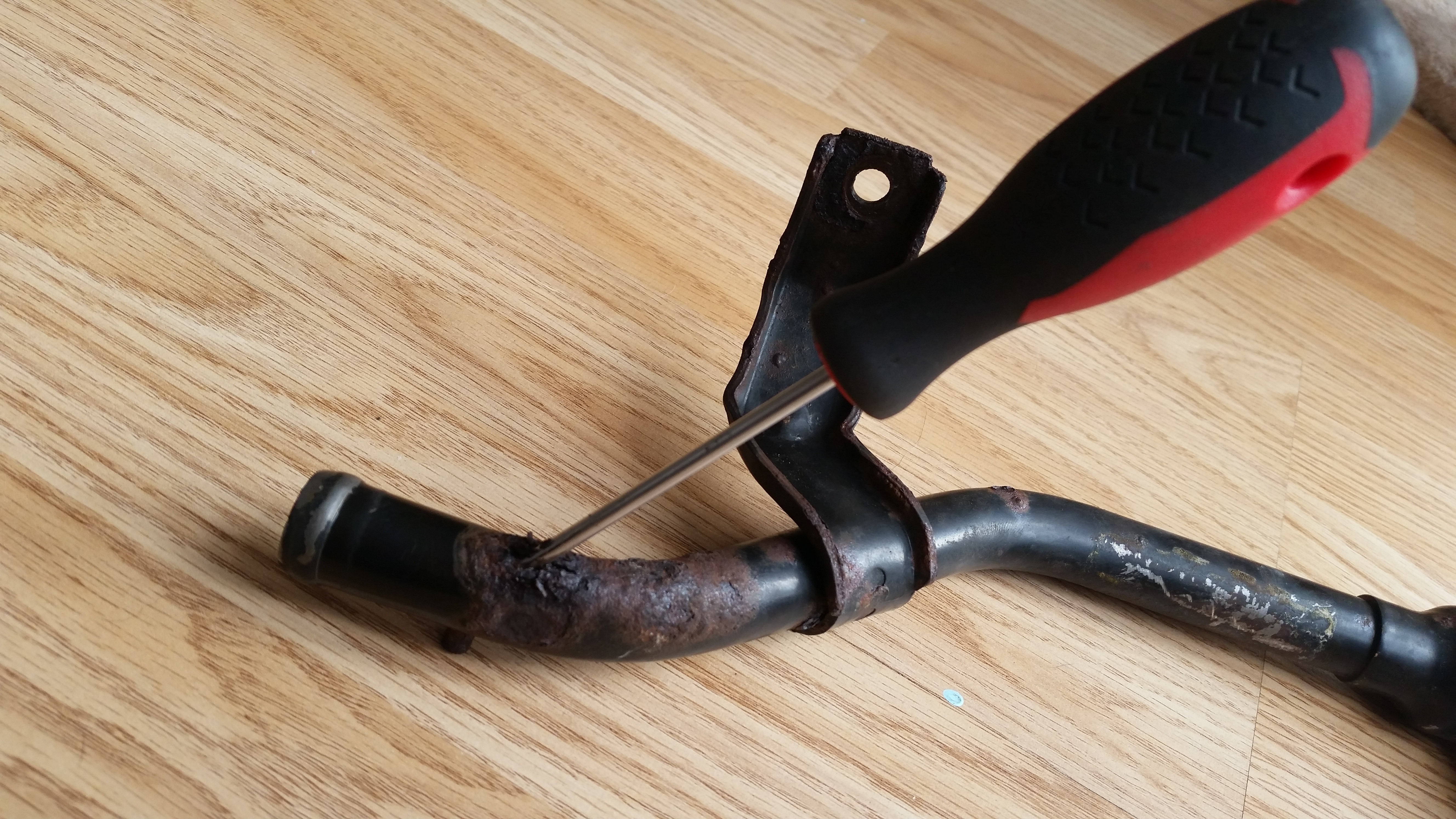

You replaced the metal water pipe? Behind the exhaust.

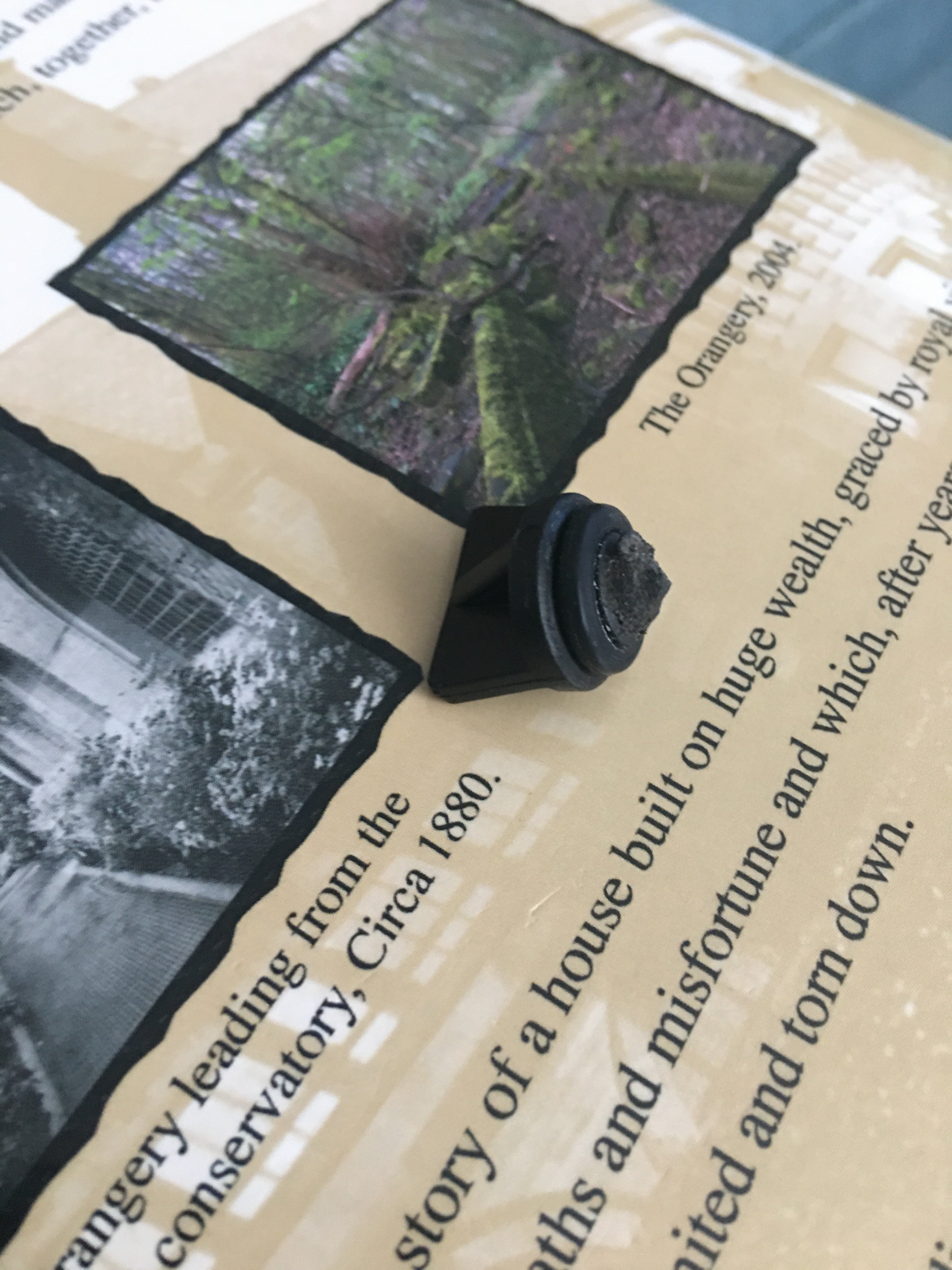

This is what remains of the rad top bleed screw! I found it while changing rads yesterday….. wasn’t even a year old ..was new from euro car parts and cost about £100! Interesting that the rad also started failing down the side too beside the expansion bottle were metal strip meets plastic … I hope this one lasts longer!!!

They are pretty flimsy, the aluminum corrodes quickly and the plastic is brittle. When I was an apprentice we used to repair the brass radiators, resolder hose connections and cracks. There were radiator repair companies who could recore them as well. Mind you I suspect they all died off due to the handling lead solder every day!
You might have got a claim if the side was leaking but they would just accuse you of overtightening the bleed screw just to throw out a claim.
In all fairness I probably did over tighten it! I don’t know my own strength sometimes… it’s prob why the rear bleed screw went on me too a few months back .. but that was a 2011 part so who knows!
