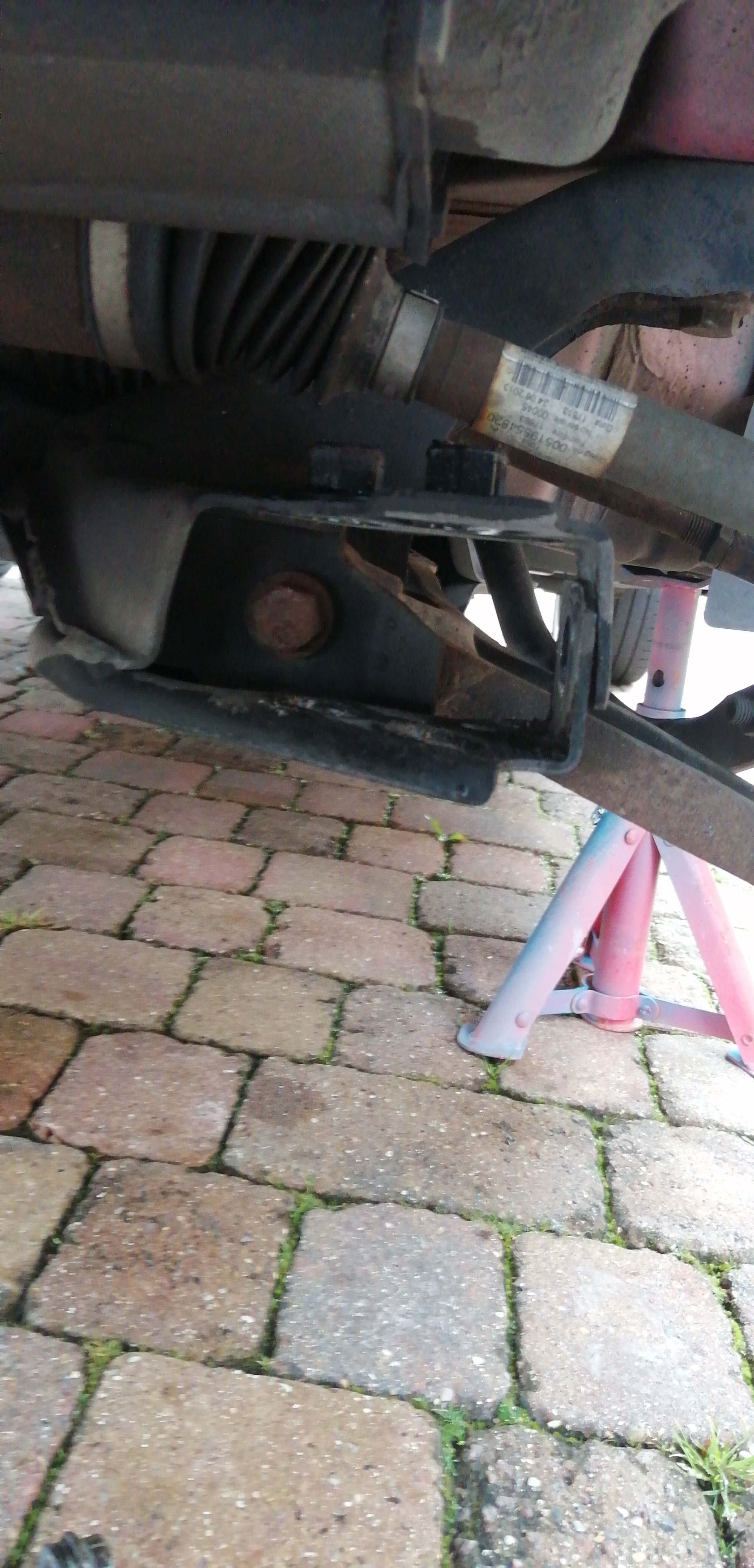

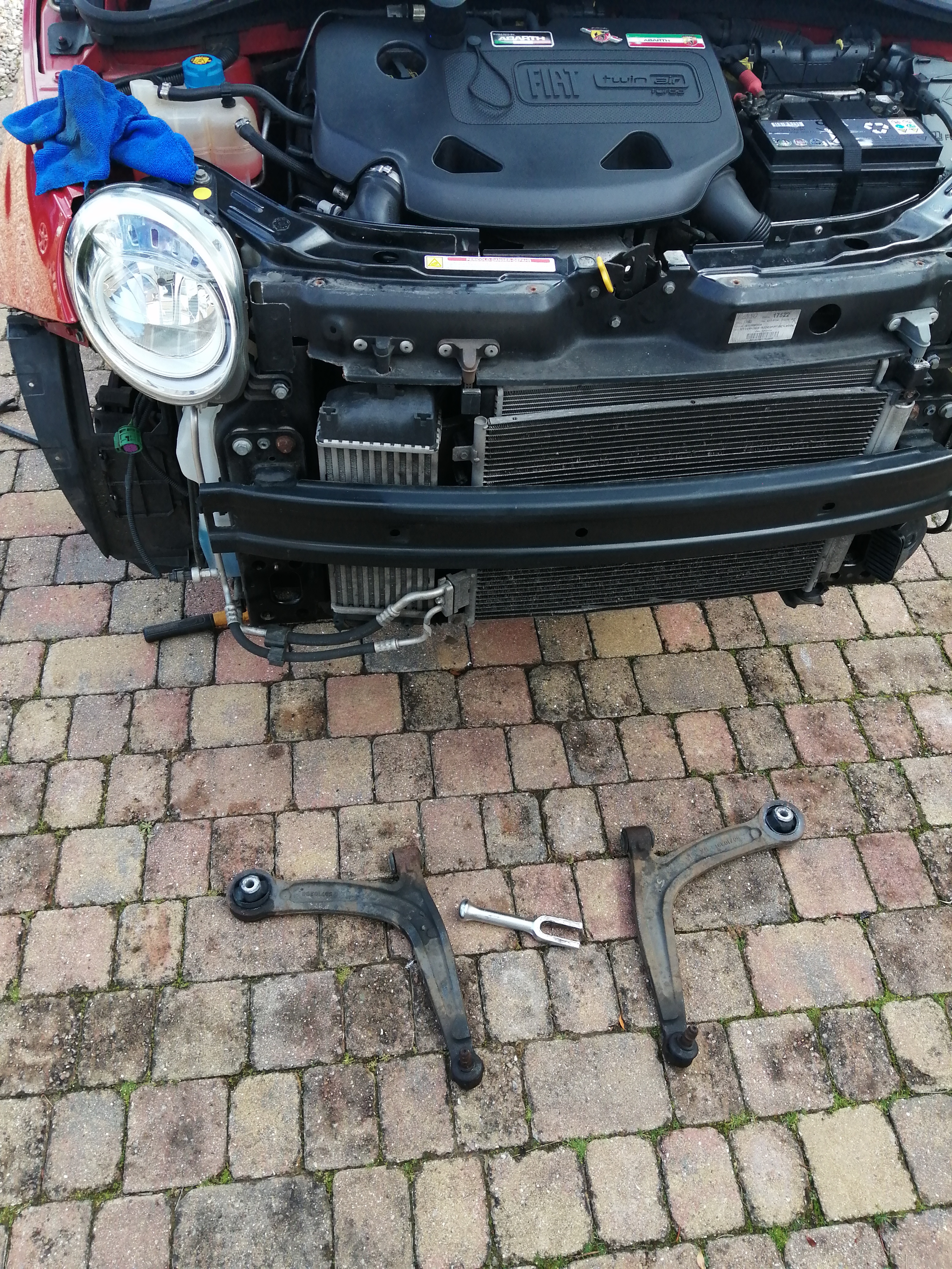

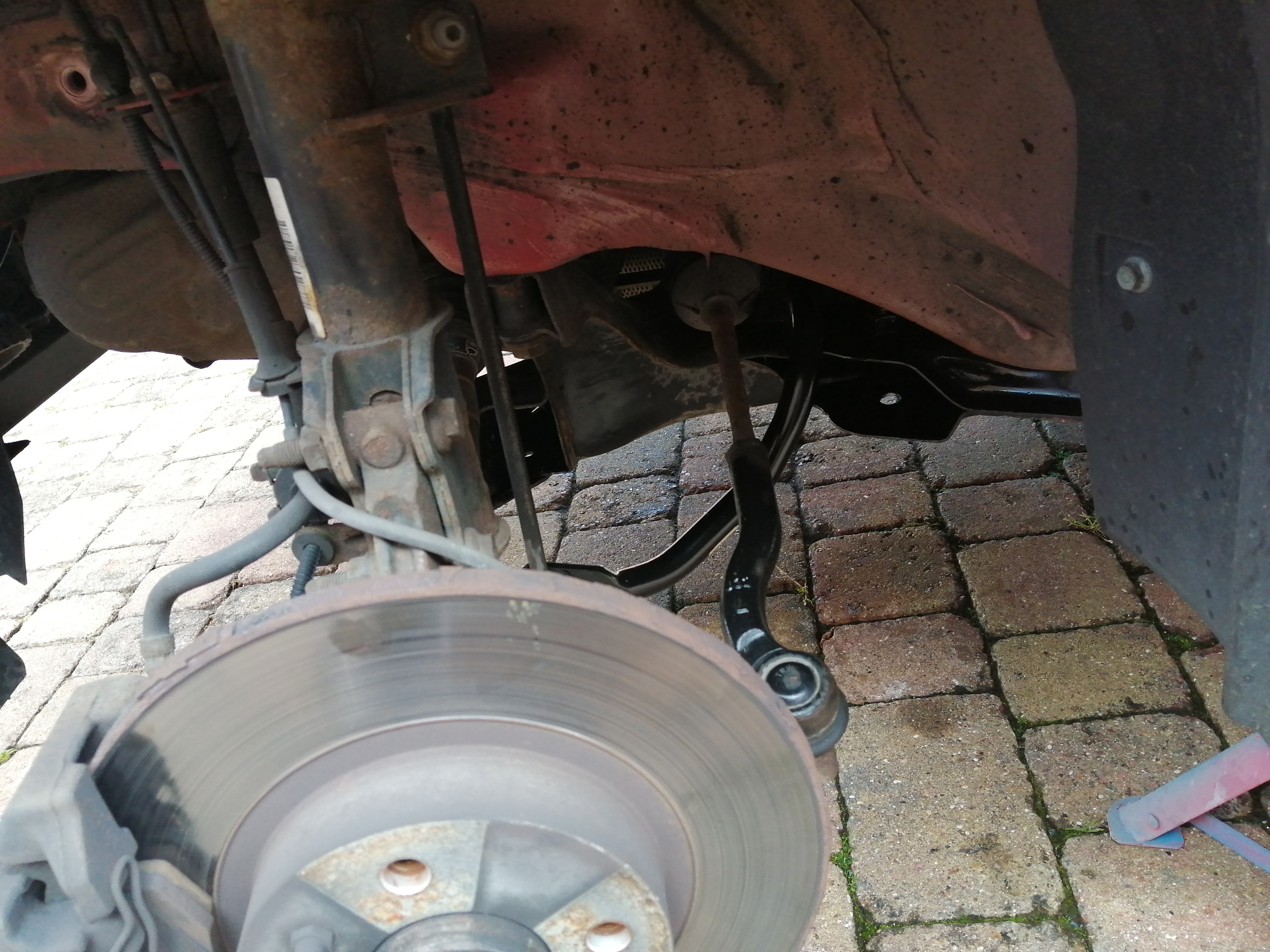

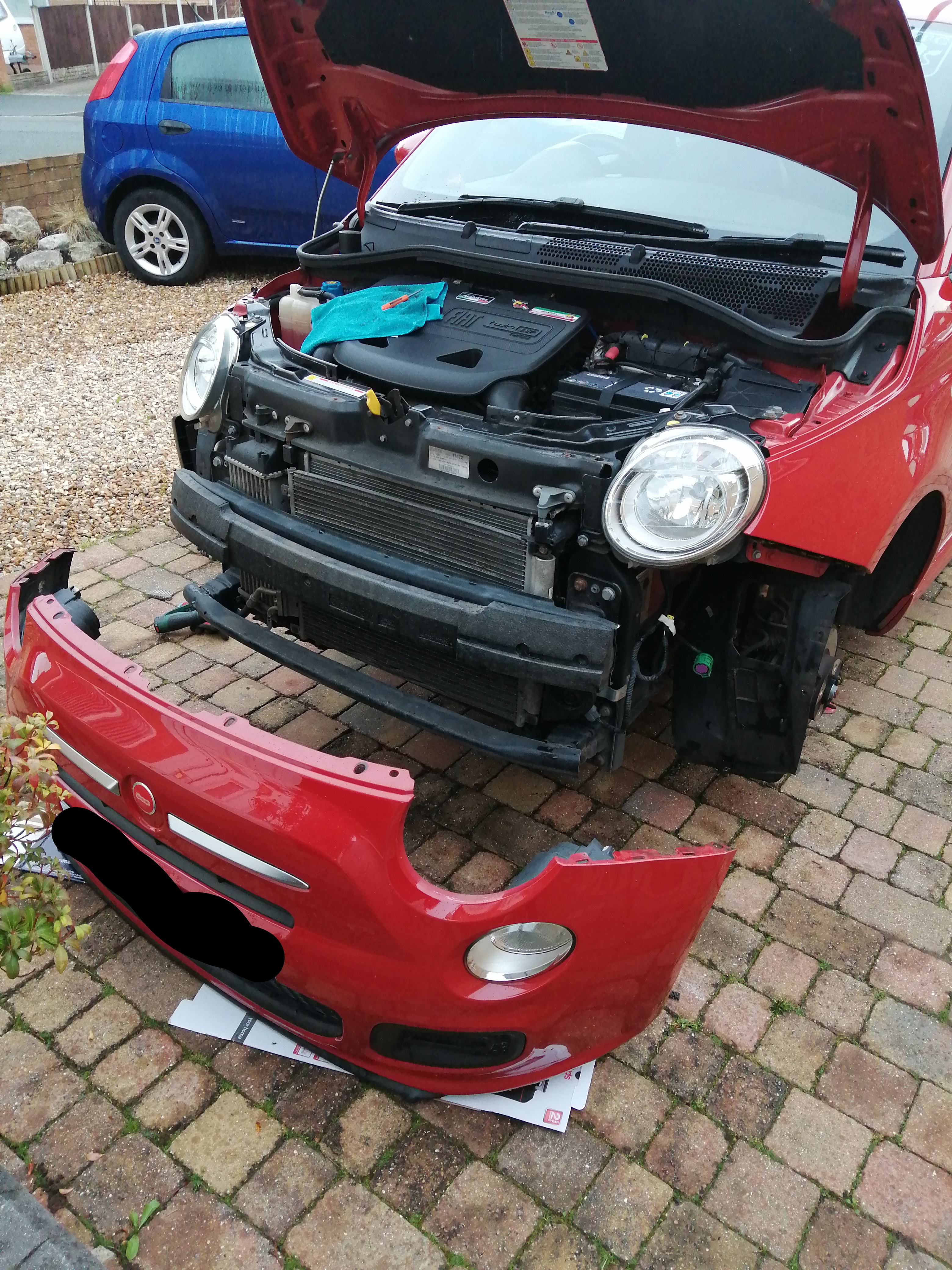

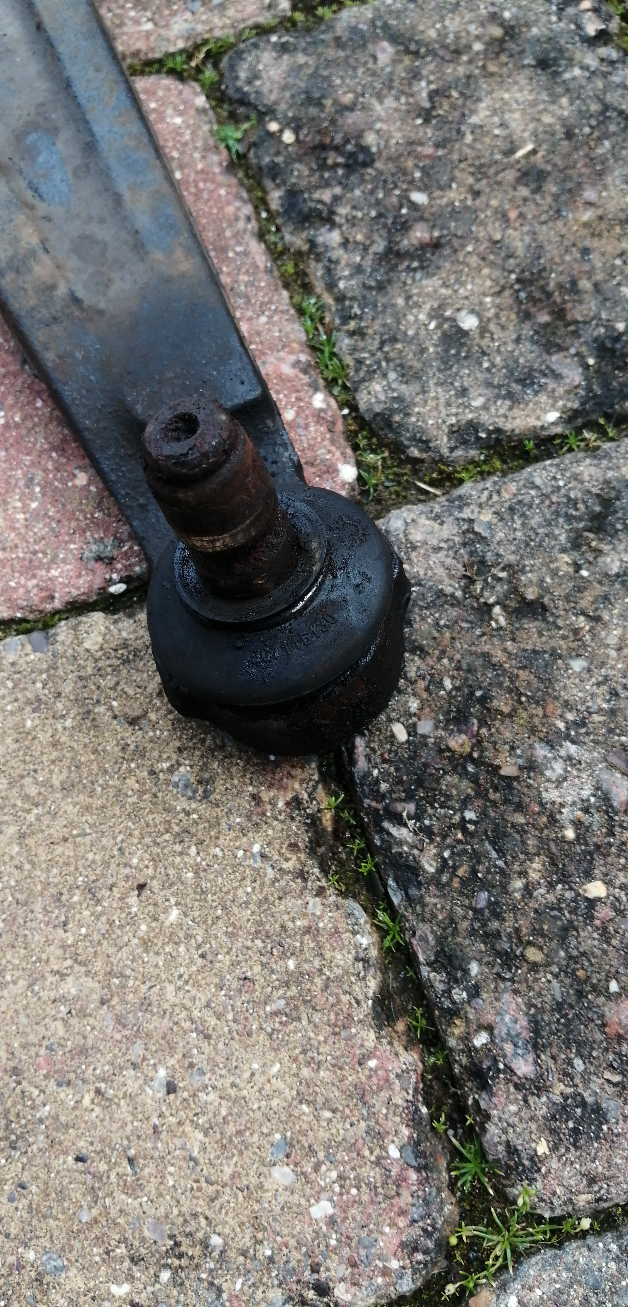

Done some work on the 2013 T/A Sport today. (y)
Around 40mins to remove wheels/front bumper.

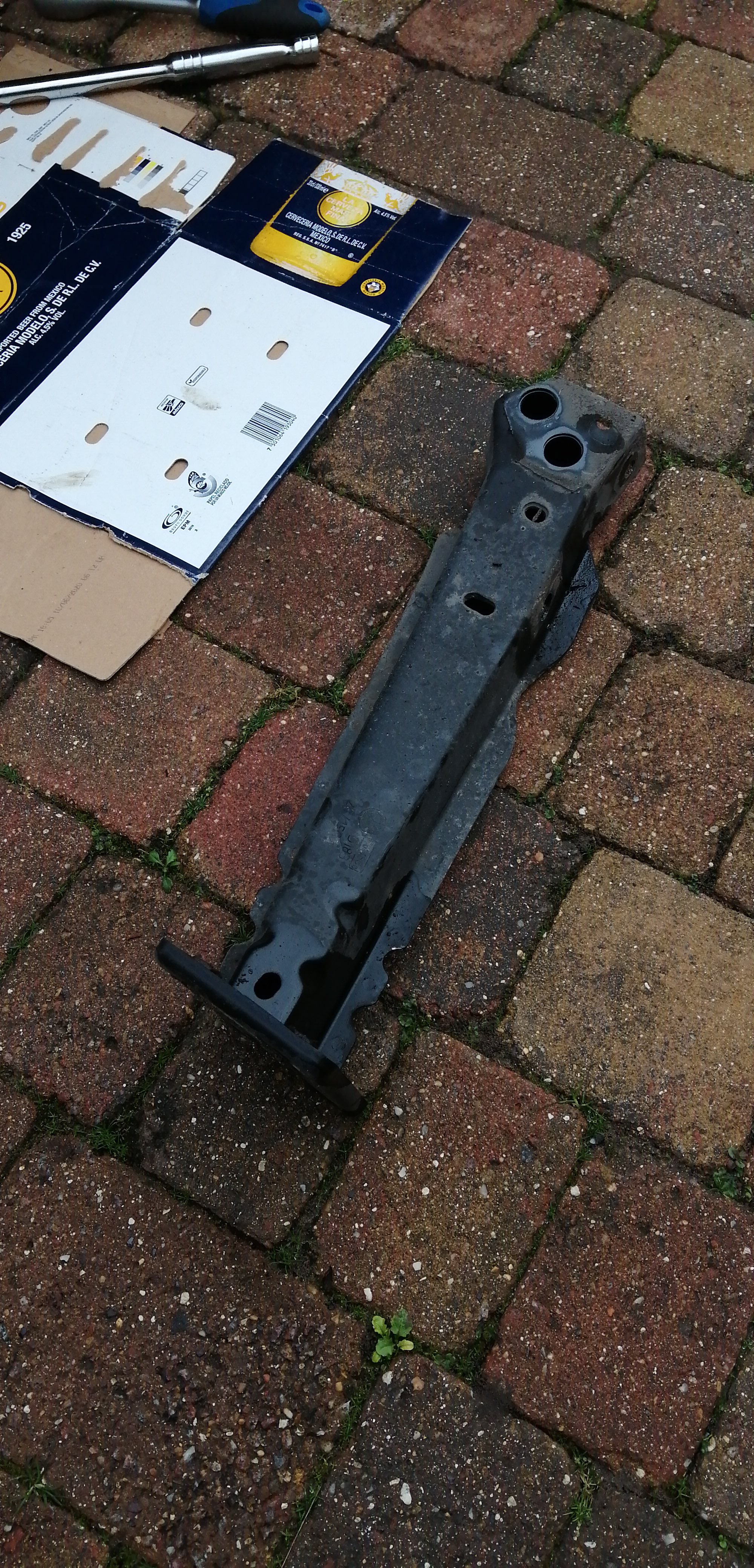

20mins to get off the bottom impact/crash bar.
20mins to get off front sub frames per side.
30mins to get out both wishbones with a ball joint puller and lump hammer. :slayer:
Bottom line.... Dont be afraid to do things yourself for the sake of 2 hidden bolts I saved a fortune on labour.
Peace Out.:slayer::)

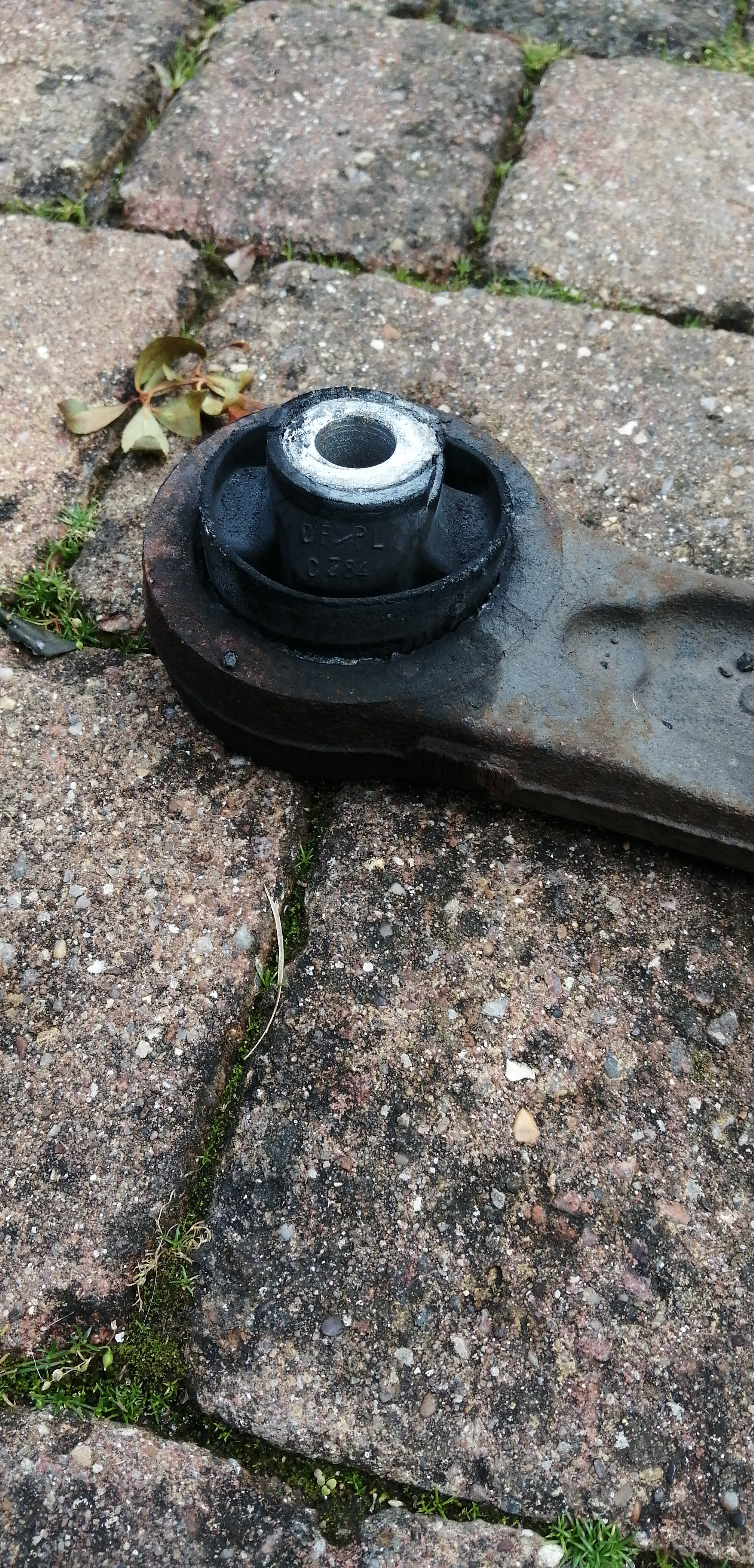

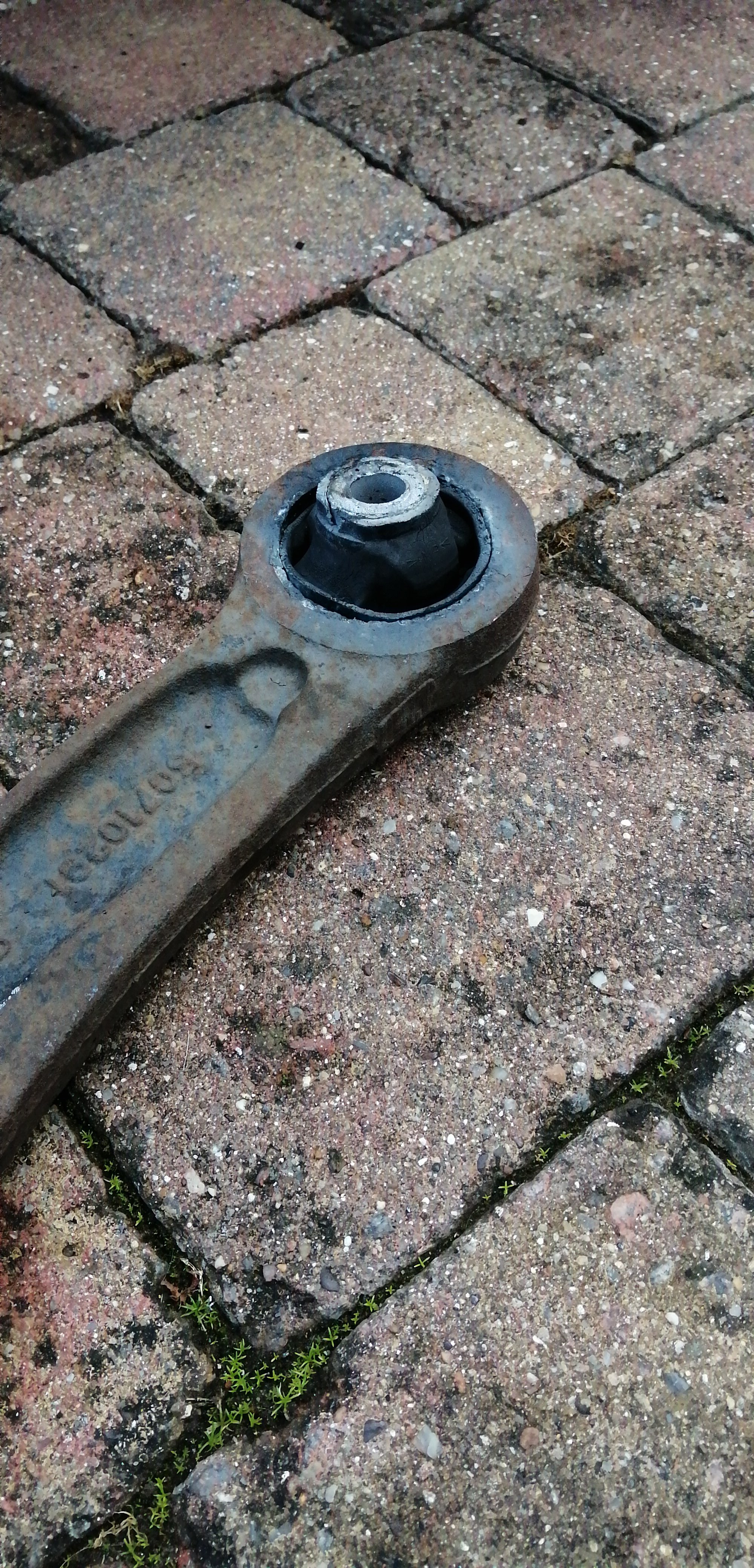

Pictures of wishbone.

Quick clean up before new wishbones installed.
TBC.....

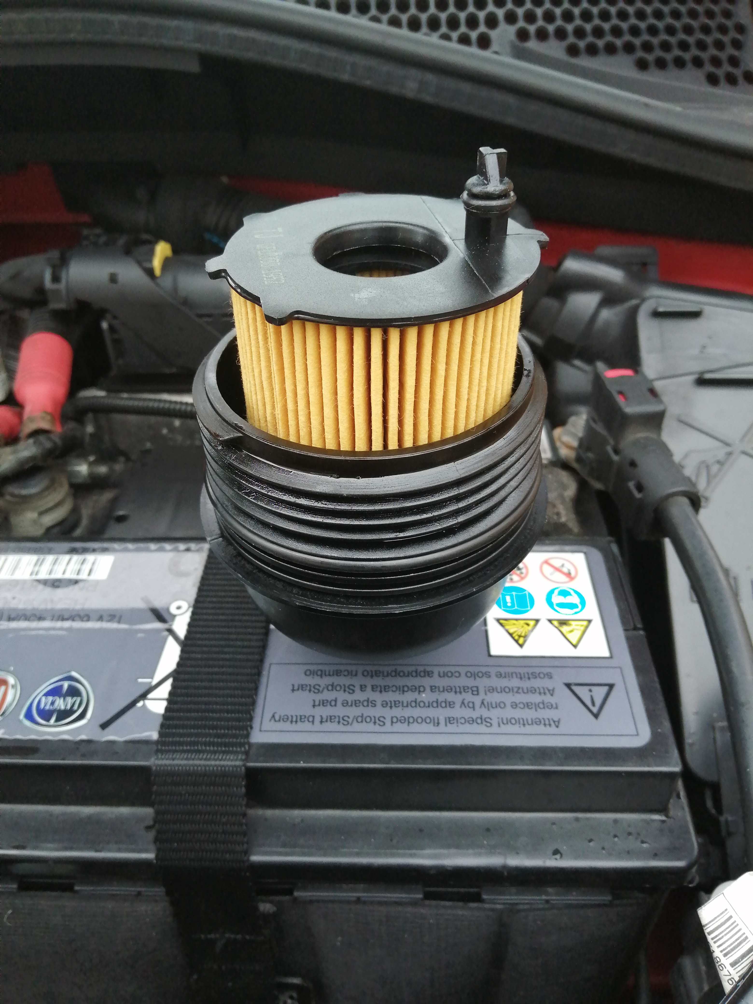

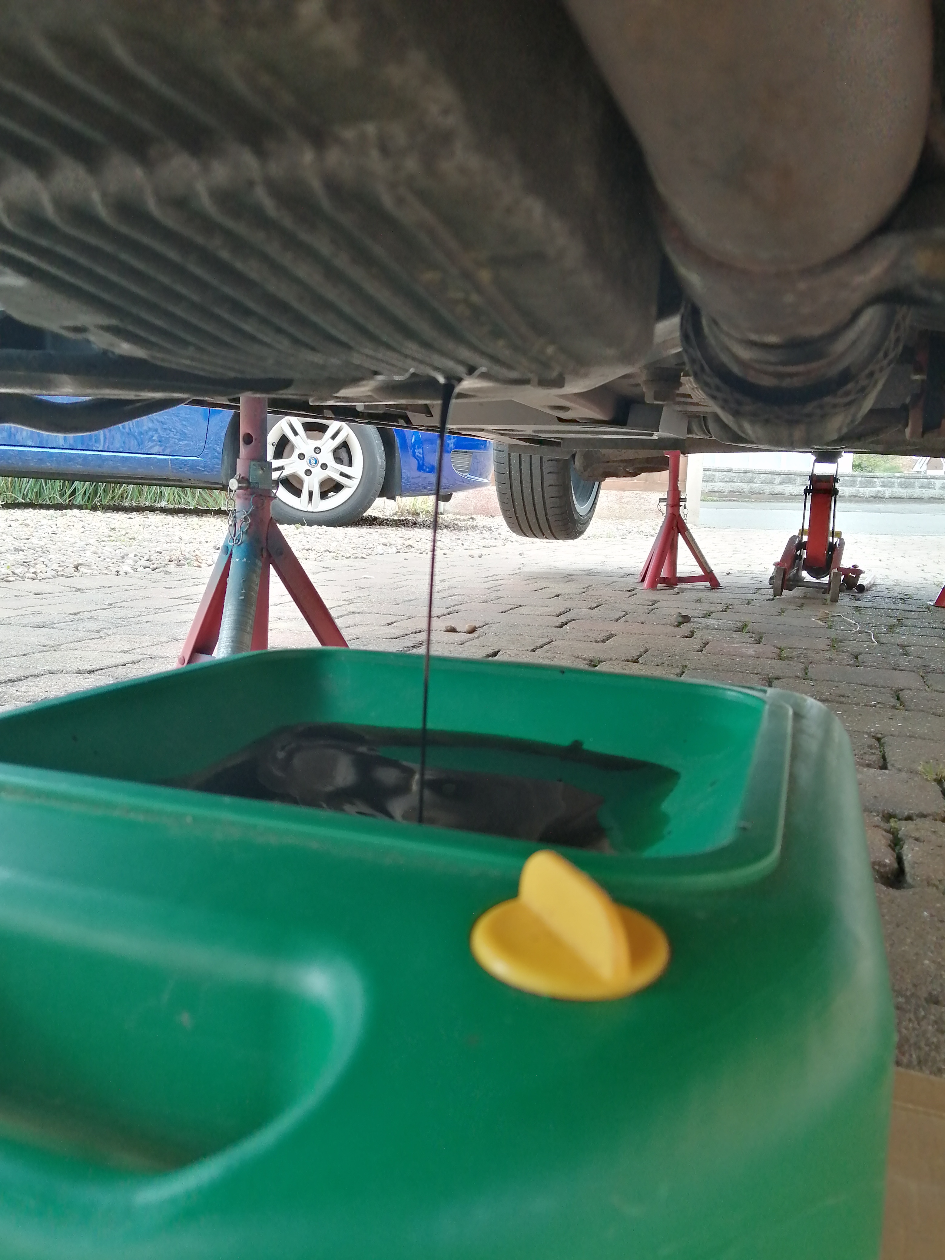

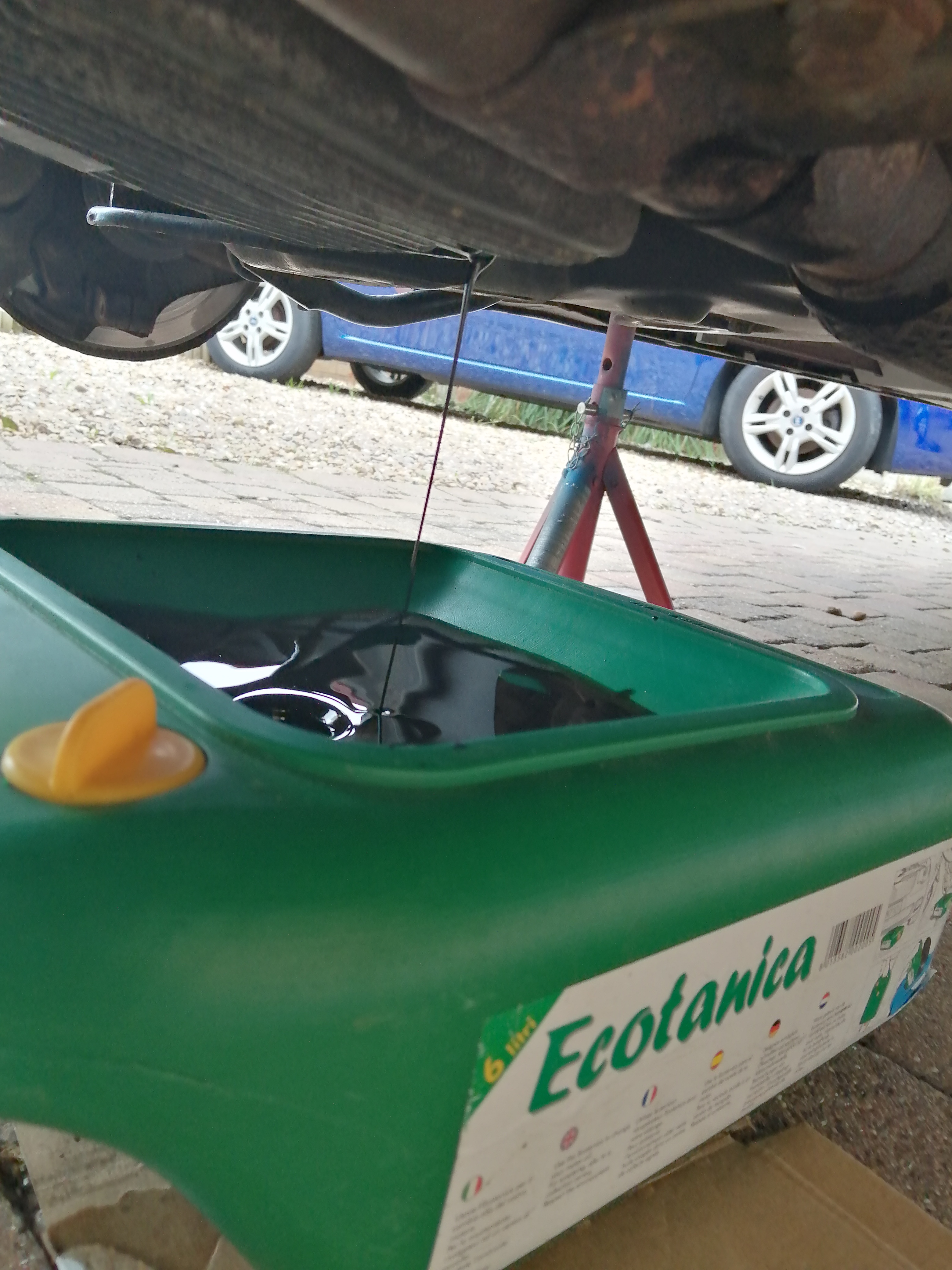

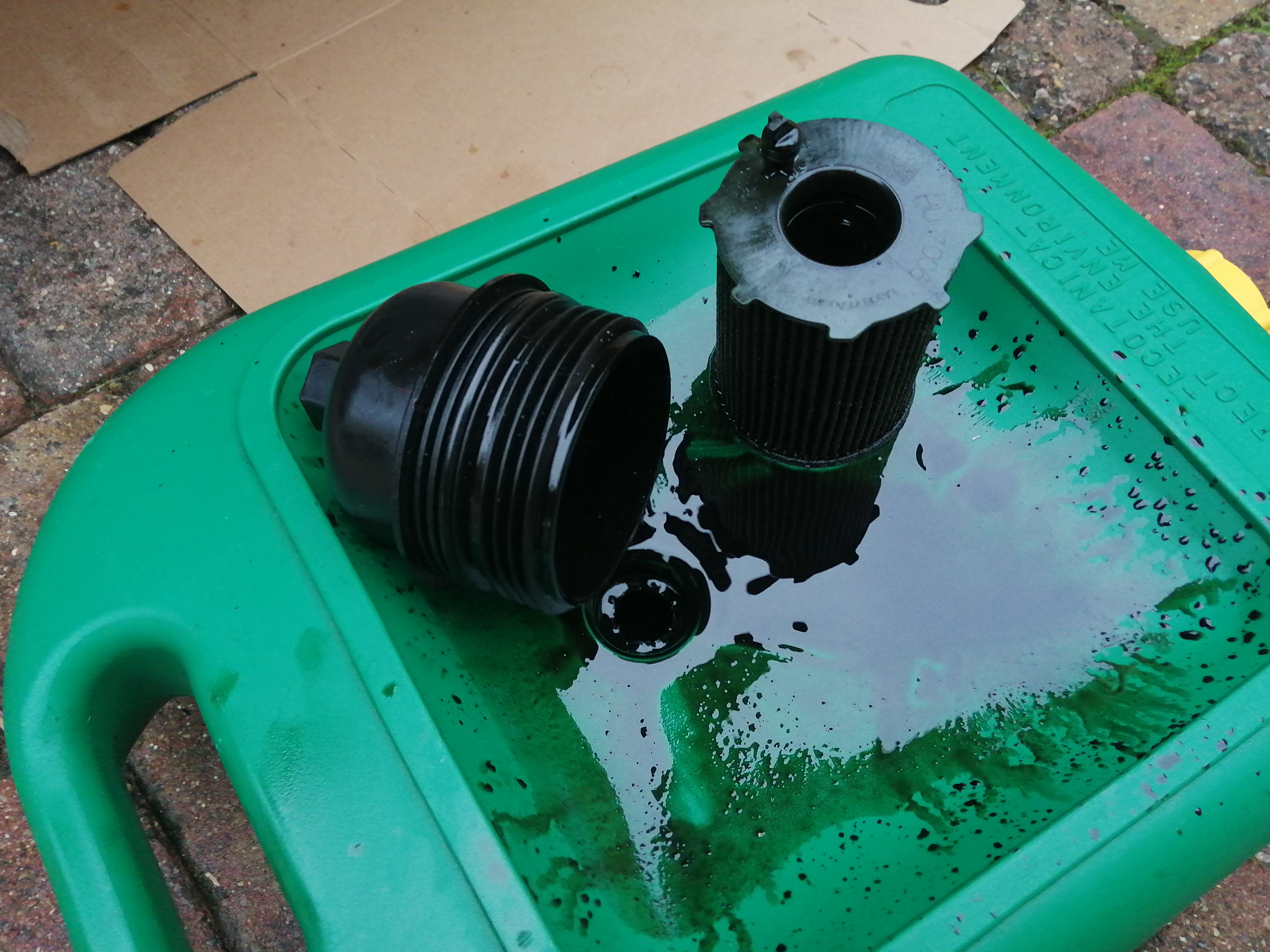

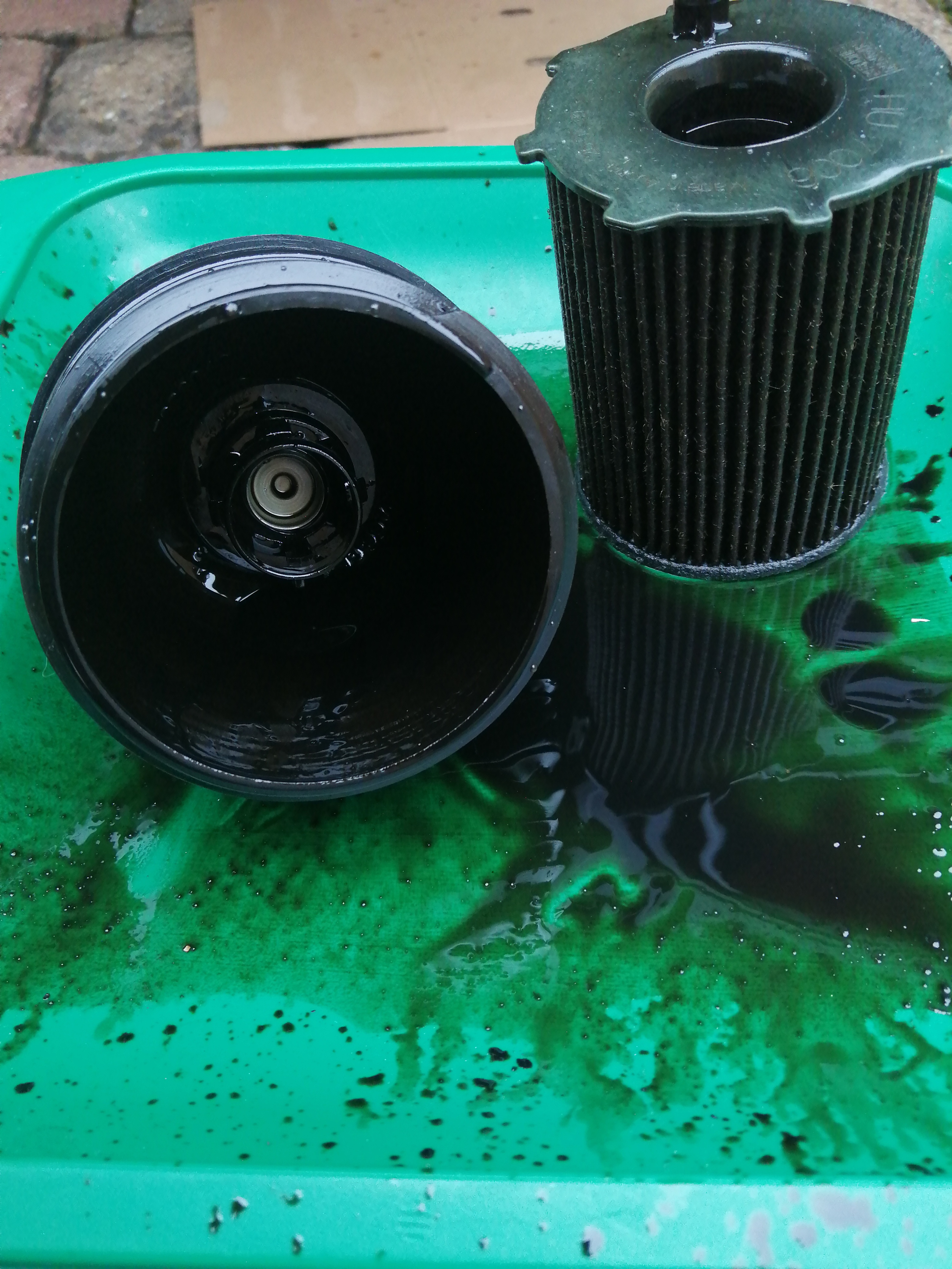

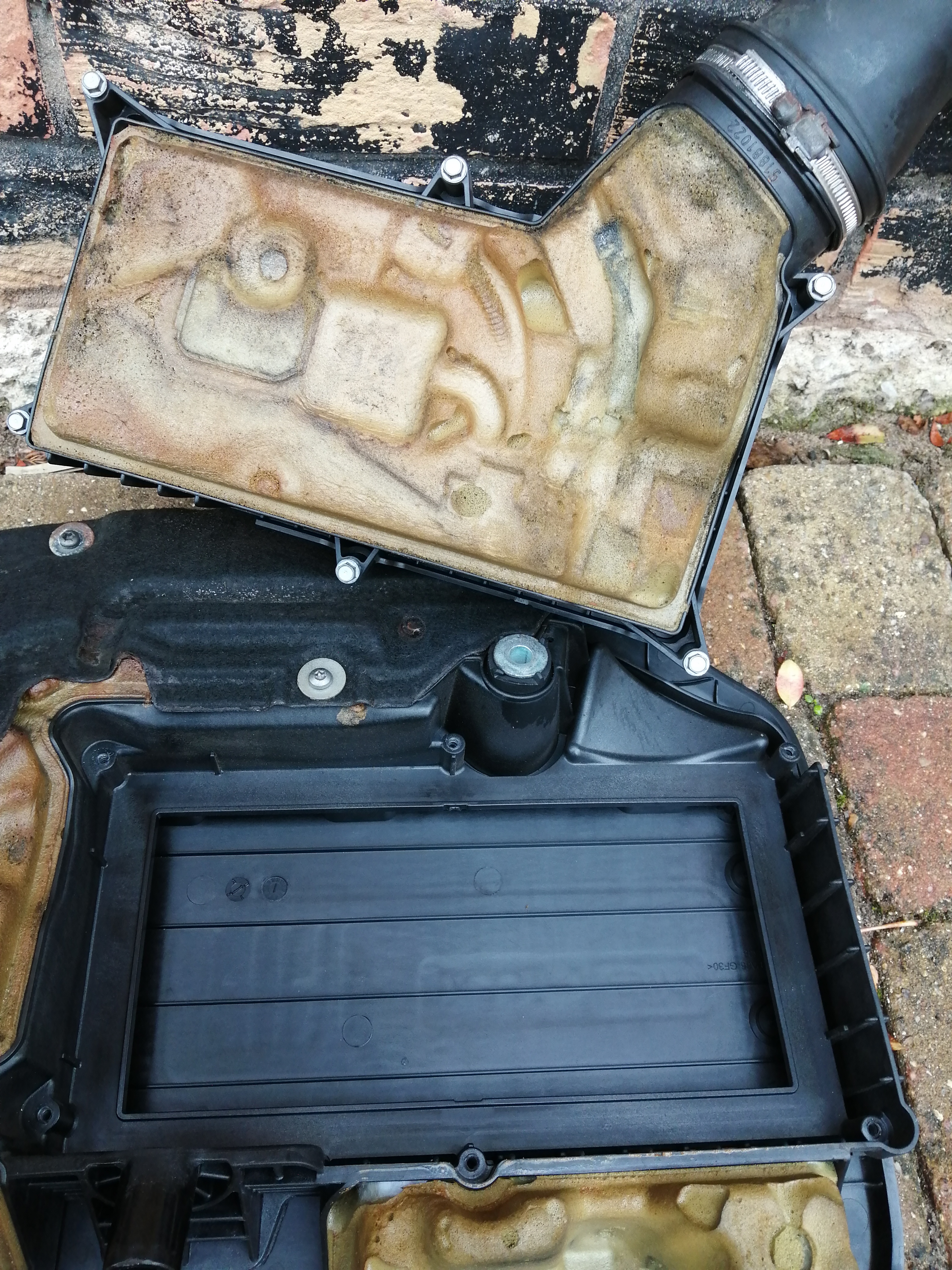

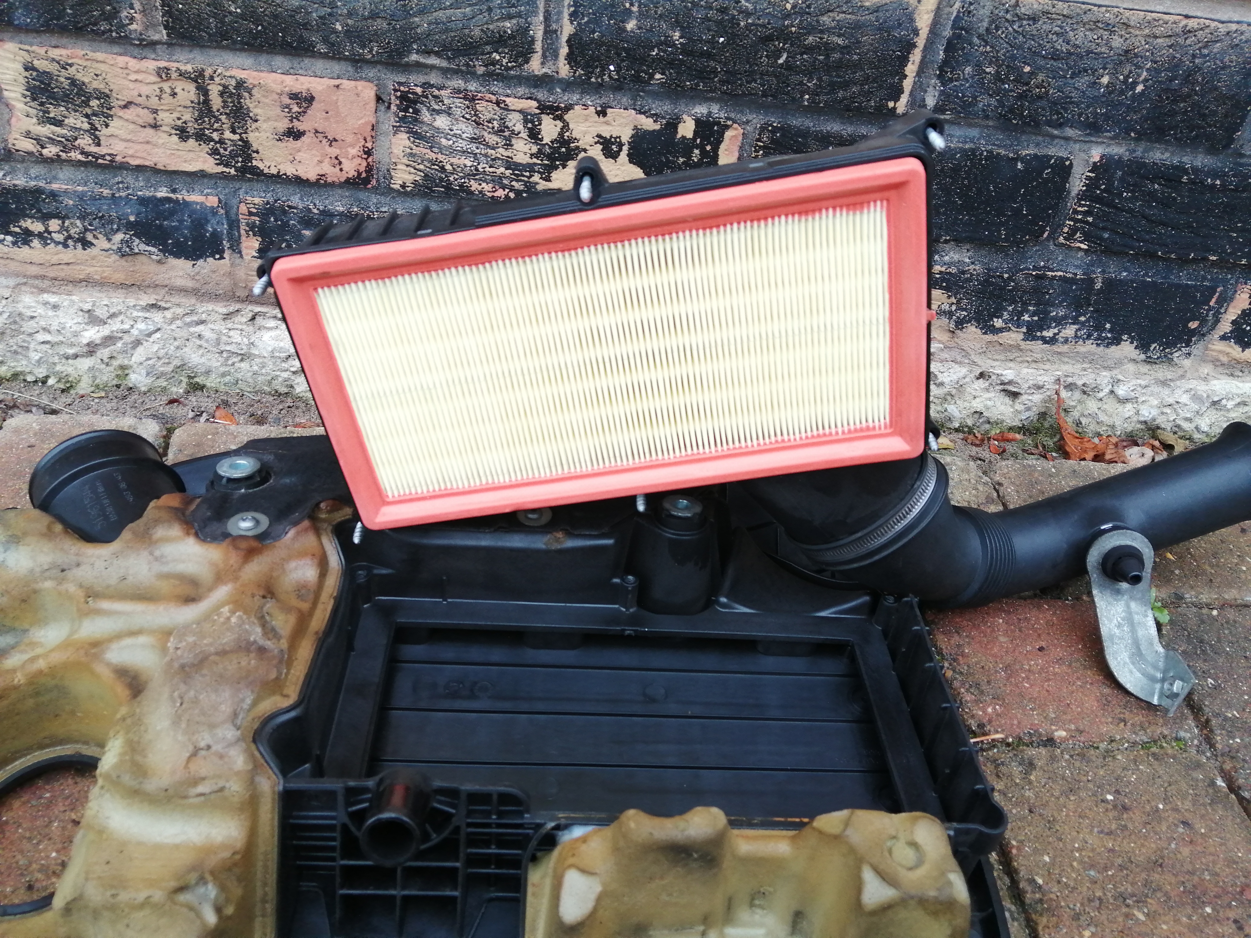

UPDATE: Oil/Oil Filter Spark Plug Change today... Pic Heavy :slayer::)
Again... Few hours graft.... Save on Labour :)

I usually change Oil/Oil Filter, Air Filter, Spark plugs every 5K but because of Lockdown I have gone over 1500miles hence the colour of the oil. :bang: (Embarrassed) :(
