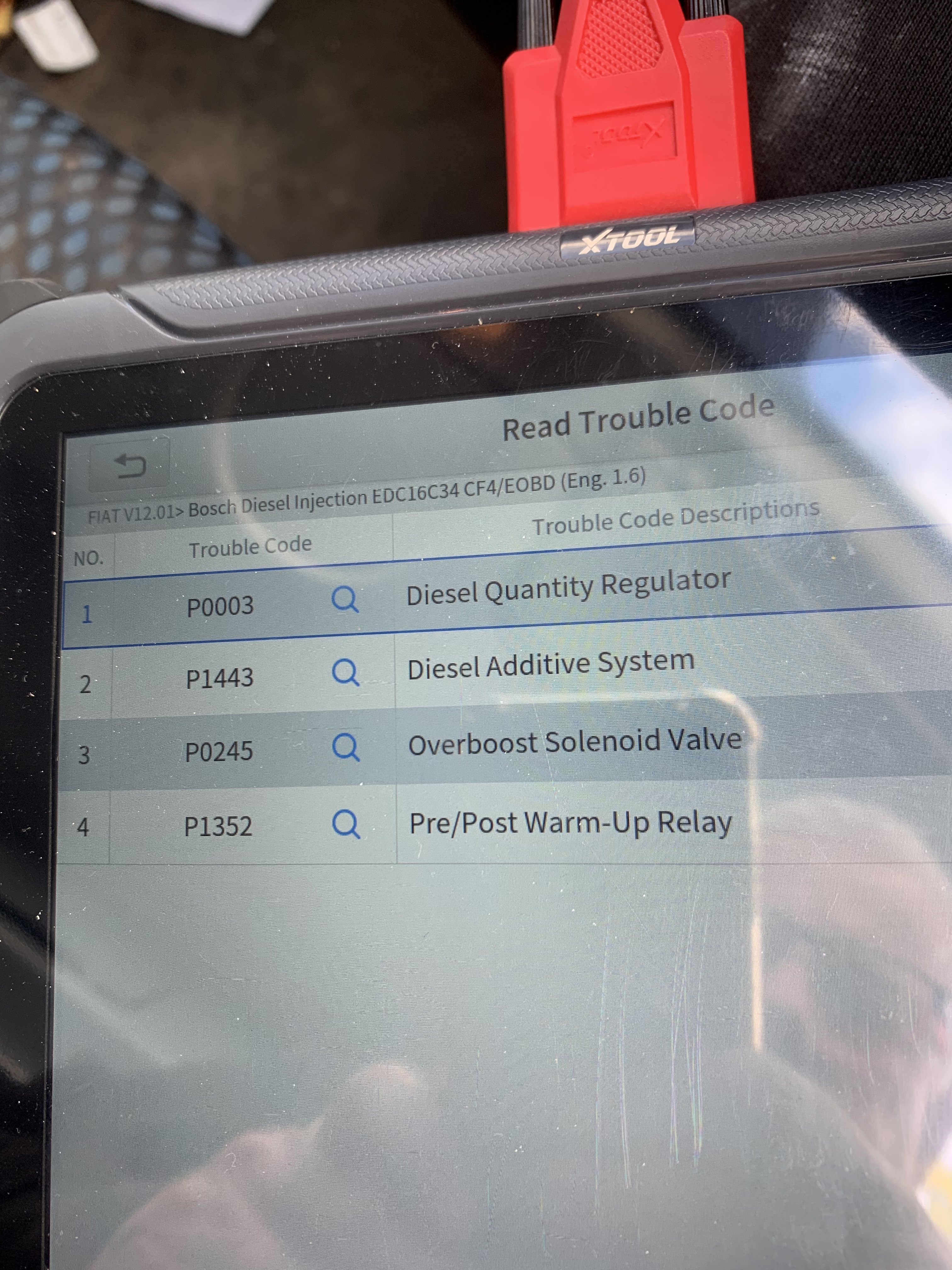

Technical 3 codes that i cant clear with diagnostic scanner

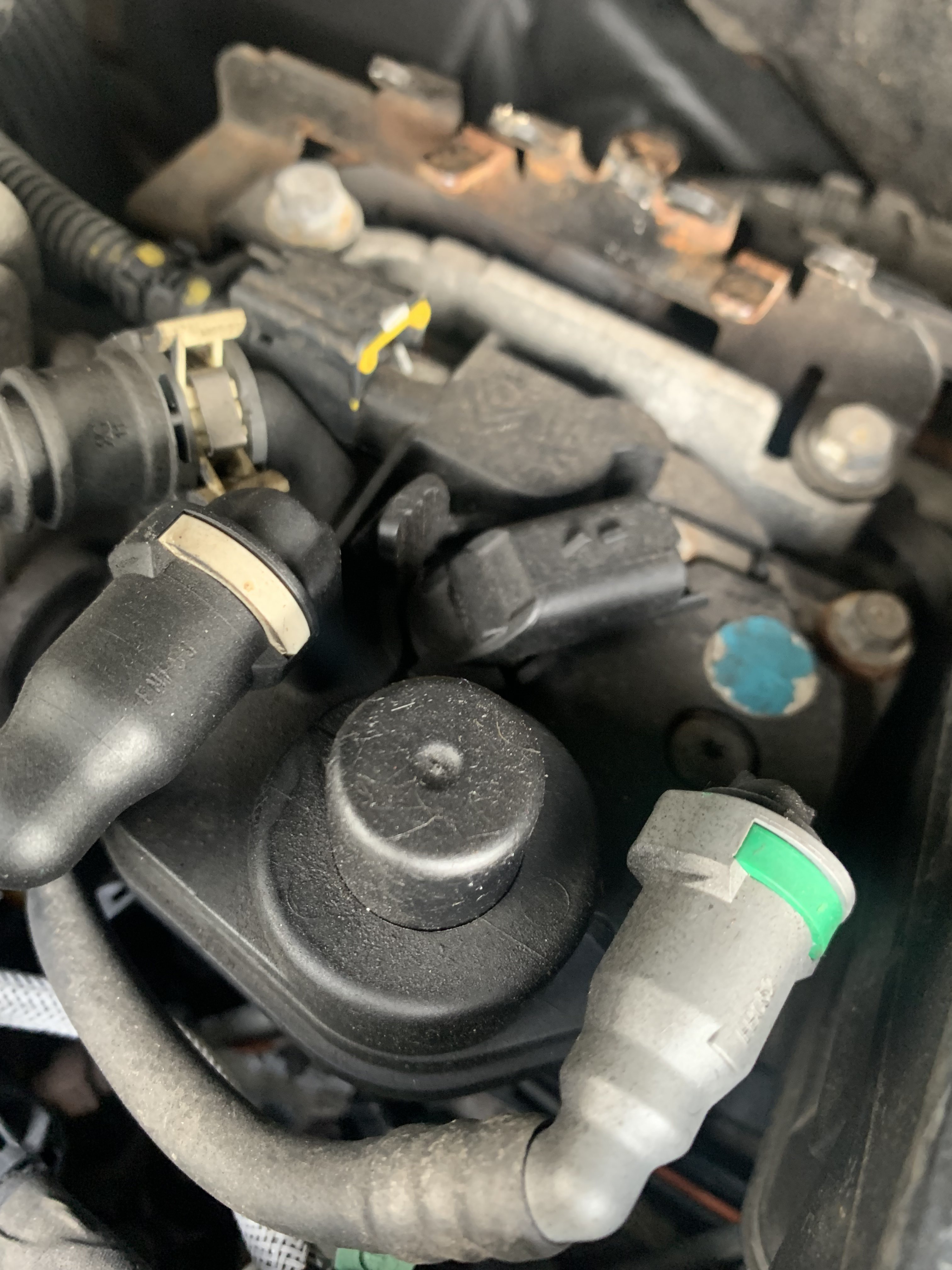

Ive put everything back together i'm getting no reading off the water sensor unless i'm doing it wrong, i use read lead off multi meter onto single prong and earth on the filter container
This prong has no earth its a single lead going to it, reading the plug it gives 1.246 ohm with ignition off

The sensor is on the right

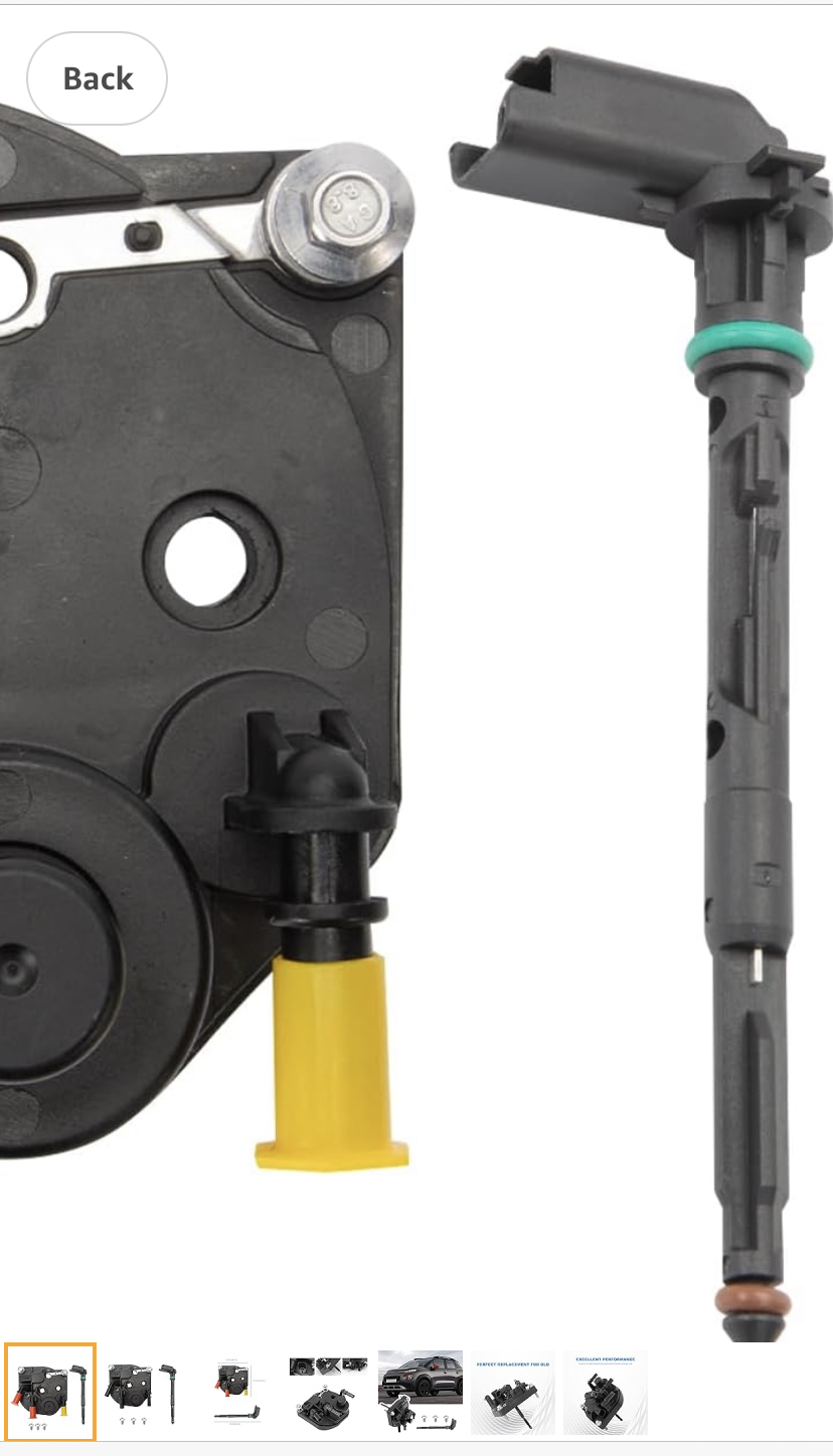

Are you sure that's the right sensor? because google shows nothing like that on a search
Yes its correct, ive just used another fuel filter lid off my mechanic friend and its give same reading and not turning off the stop sign!! Van still disabled and these codes wont clear
I also looked at my friends 2015 citroen, same van and engine but his water sensor on filter housing is disabled?? No leads
Why are we spending so much time on this water sensor? The original codes on your diagnostic reader are nothing to do with water in the filter.

If the fault is with the PAT system, you could spend the rest of your life faffing with the filter, and not fix it.

It also came up as a code, but i managed clear it, now it says “fault eng man system” van has stop sign on and wont run also in eco mode
