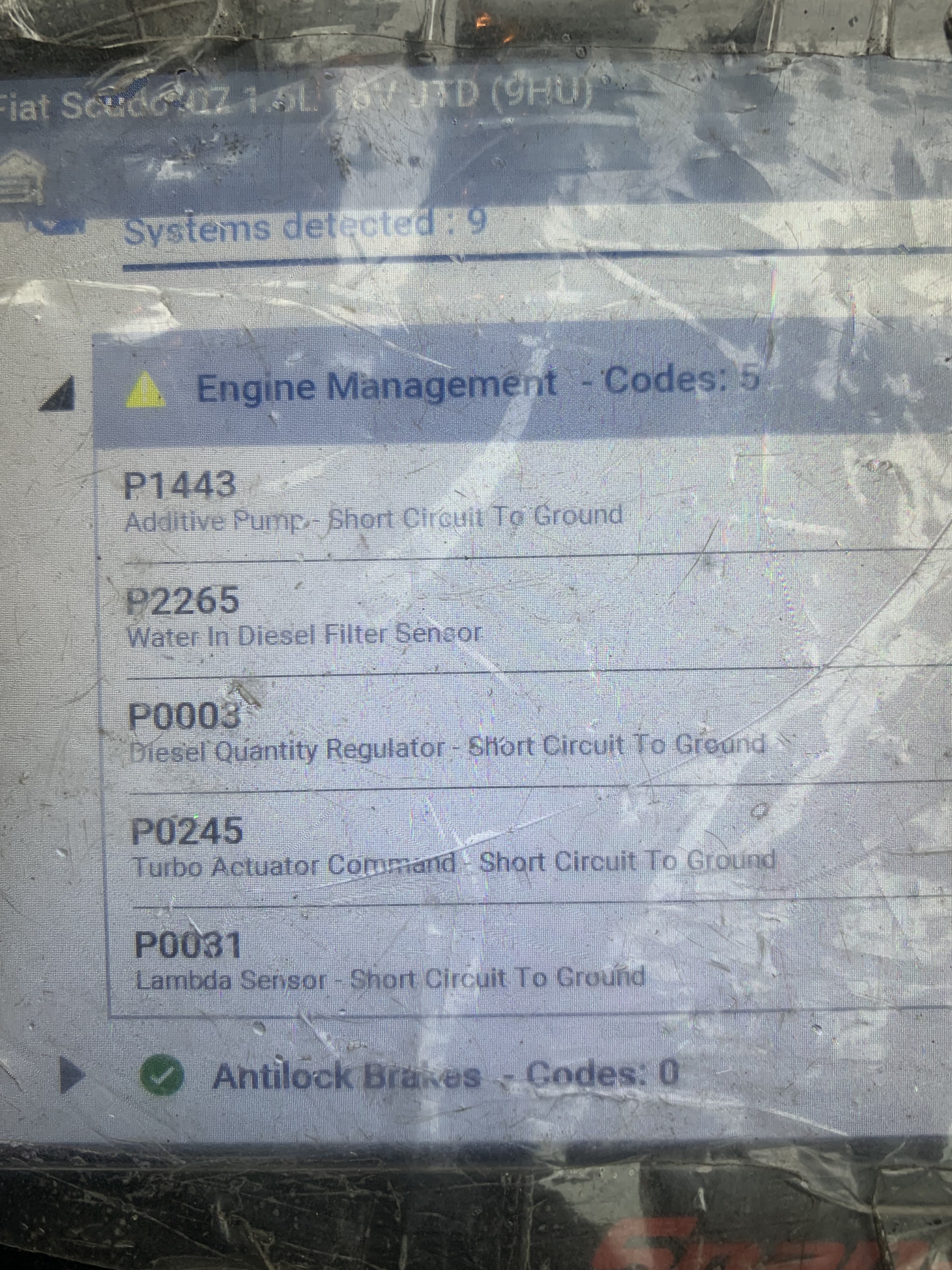

I put new battery on van, stop sign went and it started, after a few revs stop sign back on and stopped, codes still on.
Yes all say short circuit to ground View attachment 453865

Anyone know what sensors are for each code? I know lambda and diesel filter but others no
P1443 The additive pump should, if like the Peugeot /Citroen Range be at the fluid reservoir under vehicle forward of n/s/r wheel.
P0003 Diesel quantity regulator will probably be on the high pressure injector pump or the Common Rail (there may be another electrical sensor/switch/valve there which cuts of fuel depending on type of pump used)
P0245 Turbo actuator command, I am guessing on the bulkhead or the front bonnet slam panel, near the turbo with vacuum pipes connected to it.

Great, so i disconnect all, clear, then scan one by one? So question is, if unplugged and all still there its 4 sensors duff? I cant see it somehow but will do that.
