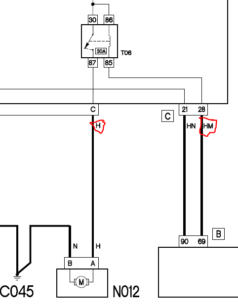

I enclose a description from eLearn, hopefully it matches your car model.
Hi
Thanks for your reply and for the electric diagram. It helps alot. :)
Since the No1 fan is working, i will assume that the temp sensor is ok.
Both fans use the same ground so that should also be ok.
Then, i assume that the relay or power from the ECU to the relay must be
the problem.

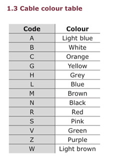

Any idea of colour on the wire from K6 relay to the ECU, and from K6 to Fan2?

I found this in the 2016 Converters and Upfitters Manual, suppose the acronyms were the same for previous models. If so, H=grey and HM= grey/brown.
I attach my own version. I find that including the Italian colour names, helps with memorising the colours..

Yes, i did that, but no luck. The light still there. I tested the fan by removing the relay and shorting 30 and 87 socket, and the fan starts.
Now i have to measure the line between the socket where relay pin 85 is and pin 69 one the ECU but i need a better wiring diagram. I have seen in the Download area, but all is to be burned to CD before use, and i dont have a CD burner or CDs. It must be possible to upload something that dosent need a cd burner...?

SOLVED:
I finally manage to solve the problem with the 2th cooling fan not working. It generated the P0481 fault code, and light up the yellow service engine soon light.
The problem was a tiny Brown/Grey cable going from the F6 relay to the ECU. I had to open up the cable tray, and trace the cable. First you have to remove the fusepanel in the engine bay and disconnect the harness from the panel. Then disconnect the harness from the ECU. Not far from the ECU the cable is soldered together with another tiny cable going to earth ground. I found 4 breaks on the cable. The insulation was damaged and the cable was worn off by irr.
I then removed most of the cable and replaced it with a new more robust one.
This fault is common on this Fiat Engine, and Fiat has issued a Bulletin NO-4834 on this matter.
Note that when you have finished your work, the check engine light will not disapper. You first has to run the fan once, then you can delete the P0481 fault code.
