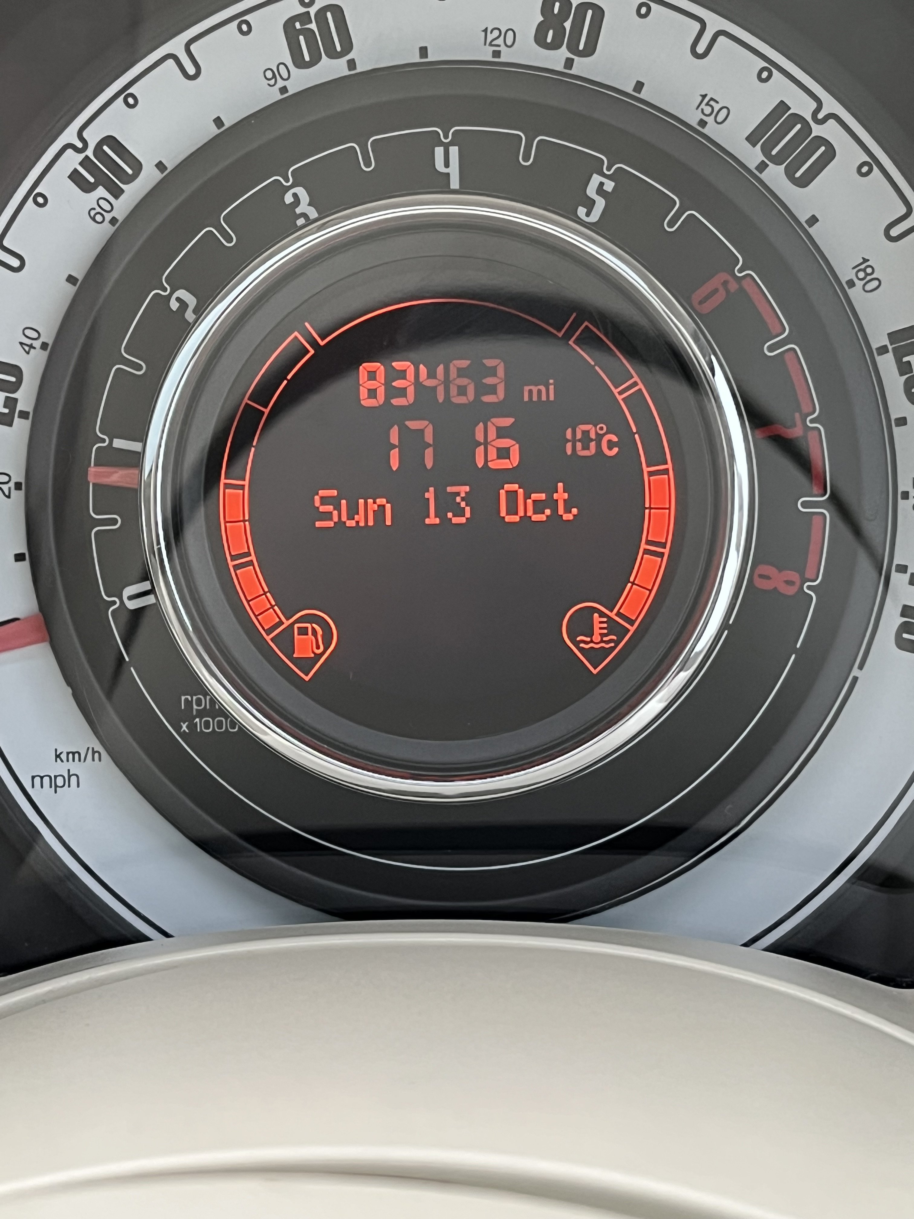

Hi. Is there a backlight behind the lcd dashboard. The top right is really dim and the dashboard hard to read in the daytime. However at night it’s almost perfect. It could do with being brighter any ideas? The image on my phone picks it up perfectly but to the naked eye it’s quite dim.

Hi this is a symptom of the central(orange l c d screen starting to fail!) eventually more pixels will disappear or it will blank out completely! you might be able to buy the screen as a replacement part on e- bay or the like!, and if you put "fiat 500 lcd screen replacement" into you-tube you should find a tutorial on how to replace it if you have basic mechanical skills!, alternatively you can sent it away to be repaired for around £250 and ask them to check for the dim warning lights issue at the same time. if you can remove the speedo unit ?, or look again on you- tube or "love 500,s" channel for how to do that!. best of luck!,

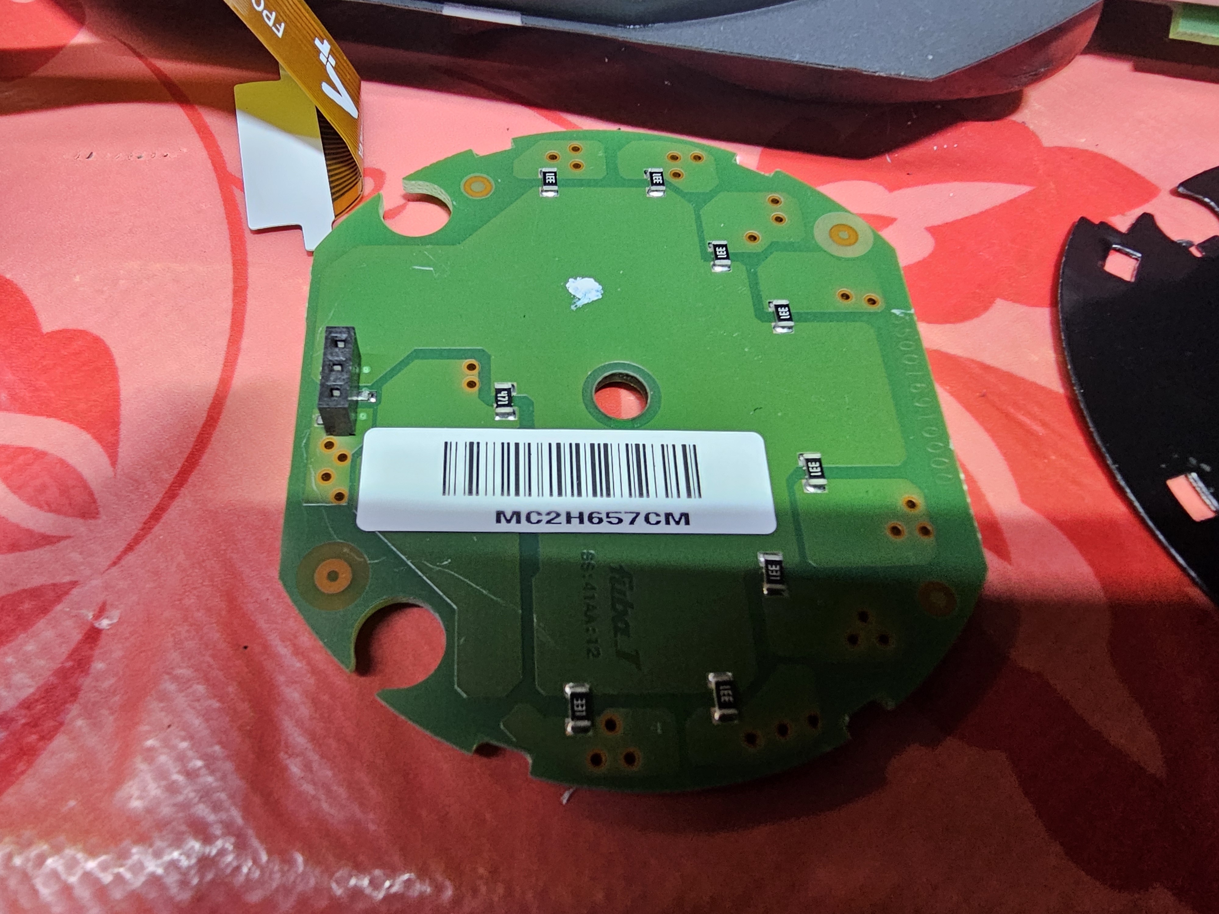

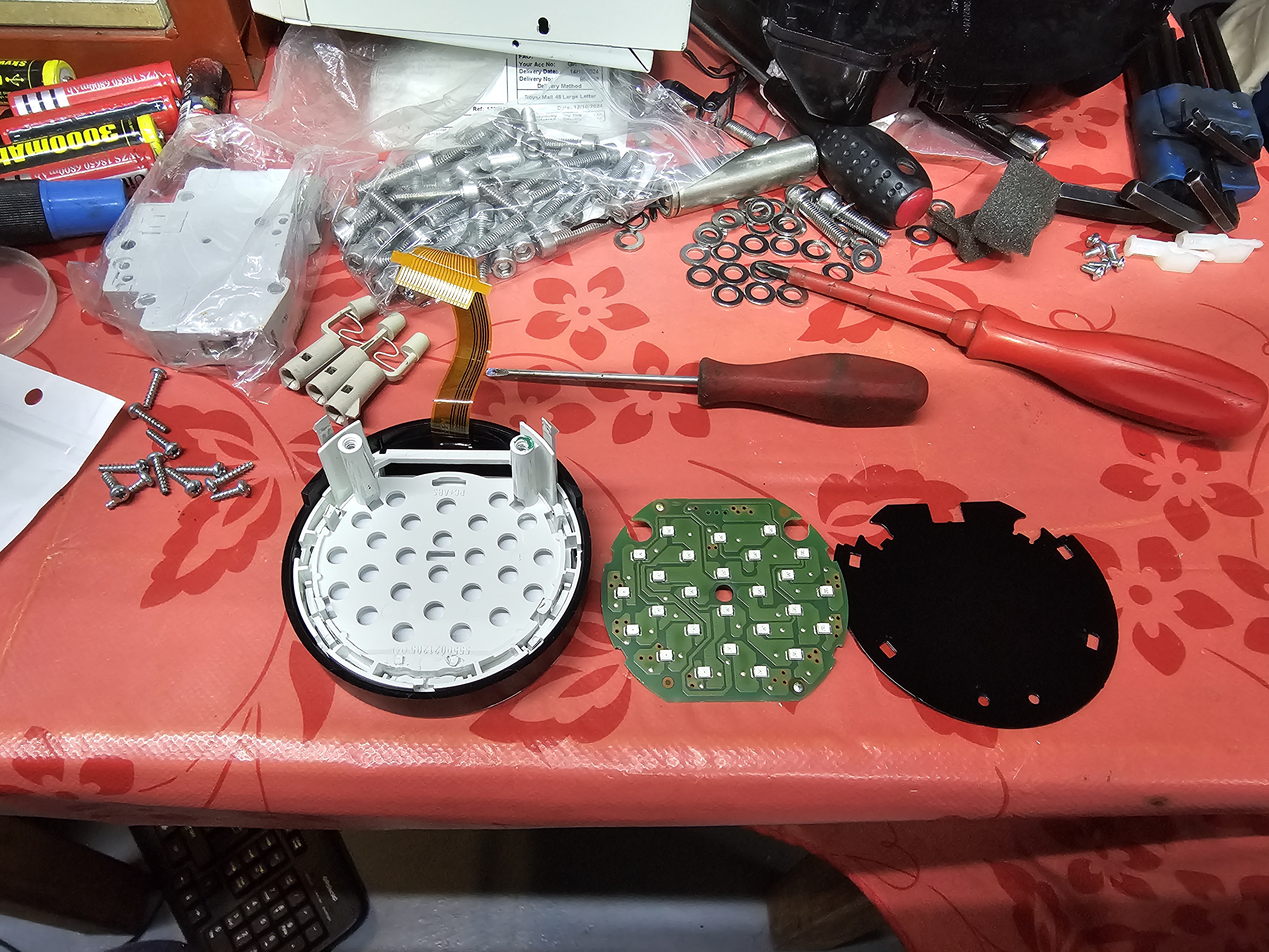

Back light is a circular "plate" type separate to the lcd
