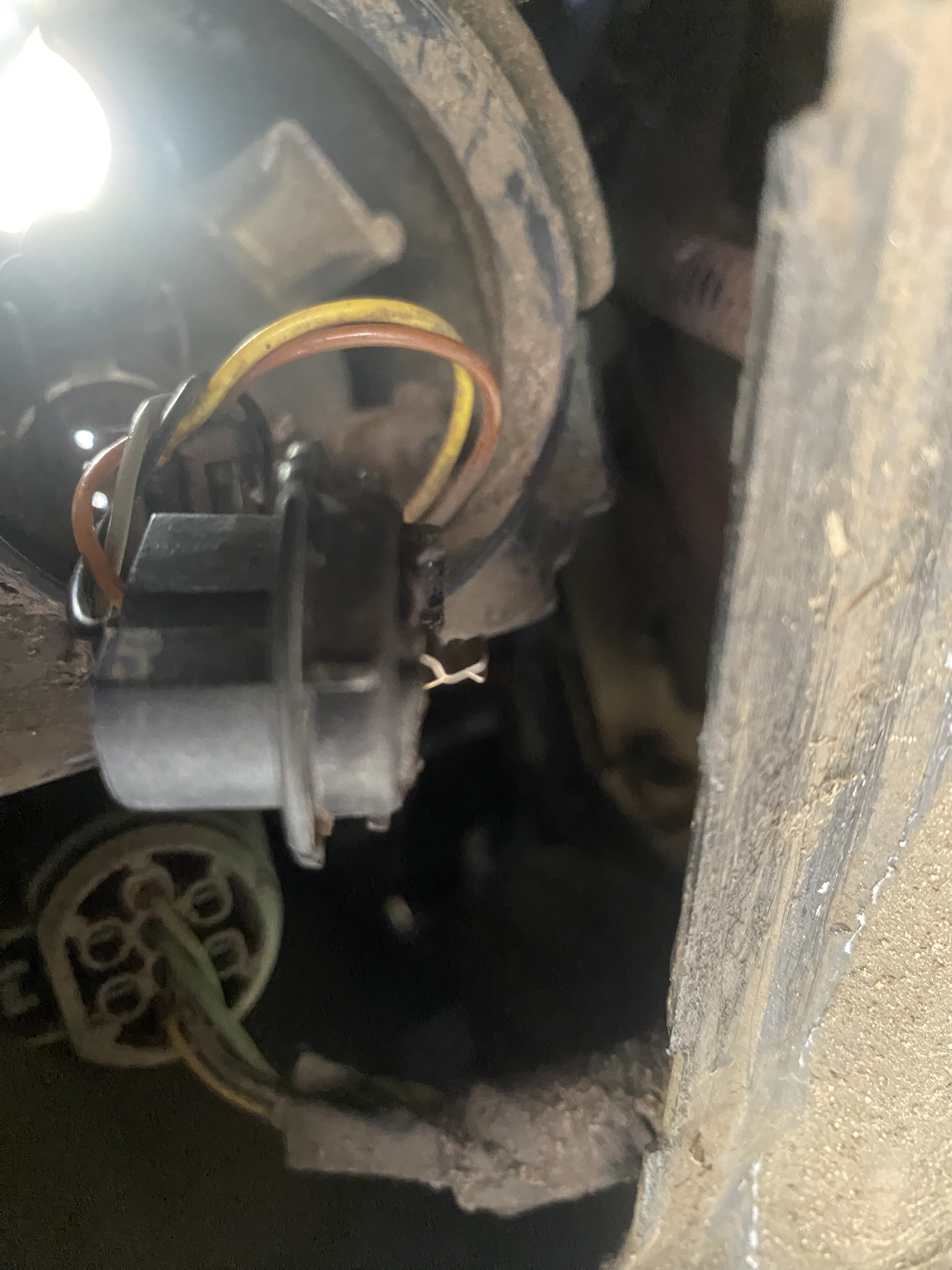

Not sure anyone can help but I need a day time running light bulb holder for my daughter’s car 2011. Garage only had universal and said best online? Don’t suppose anyone can send a link?
The bulb itself looks like a standard W5W bulb, but has two separate tungsten wires, so needs 3 or 4 connectors (ground, possibly another ground, +12V 5W, +12V 21W).
Another question is how is it mounted in the light cluster. Can't find any photos online :( Most likely it is a specific mount, but also could be something common.
Looking at those threads:
it seems that the problem is common, but there was no solution though.
I can't find the appropriate wirings on ePER. Pity.
I had a very similar problem on my girlfriend's non-FIAT car rear light last week. The bulb holder contacts corroded and one of them broke, so the light was not working, I had to cut the wire and solder it directly to the bulb. The car is 18 years old, the wiring is no longer available at the dealership, I've found online a guy who's selling this used part for 100 EUR and new ones for 170 EUR. Plus P&P.
But having found the offer with photos, I've used google lens and found that 5 or 6 another car models use exactly same holders! And a part of them is very popular. Of course the plug that goes to the loom is different, but the problem is in the bulb holders. I've bought the whole light cluster with the loom for around 15 EUR delivered and will resell the cluster :D Then I will just cut the holders and replace in the loom on the car.
Try finding the photo of the wiring needed with the broken holder, or take it off the car and take the photo yourself and then use google lens to find the whole wiring loom. Should be much easier than finding the holder itself.
I'm always on the lookout and I have found no aftermarket version of the Fiat bulb-holder.
There are generic T20 bulb holders on eBay etc. - they don't look the same but in any case I bought one to be sure.. and they don't fit. It looks like the Fiat bulb-holder is a slim/skinny so it's easier to package.
Somebody must make them to sell them to Fiat.. :unsure: but so far I don't know who.
Meanwhile the best option seems to be to buy a whole new DRL lamp.. they're easy to find.. about £50 for a DEPO.. and quality is OE.
Just put a sprinkle of WD40 on the contact flange when you get them.. it keeps the holder a bit easier to remove.. and it's the force of trying to undo a brittle, old and stiff one that breaks them.
