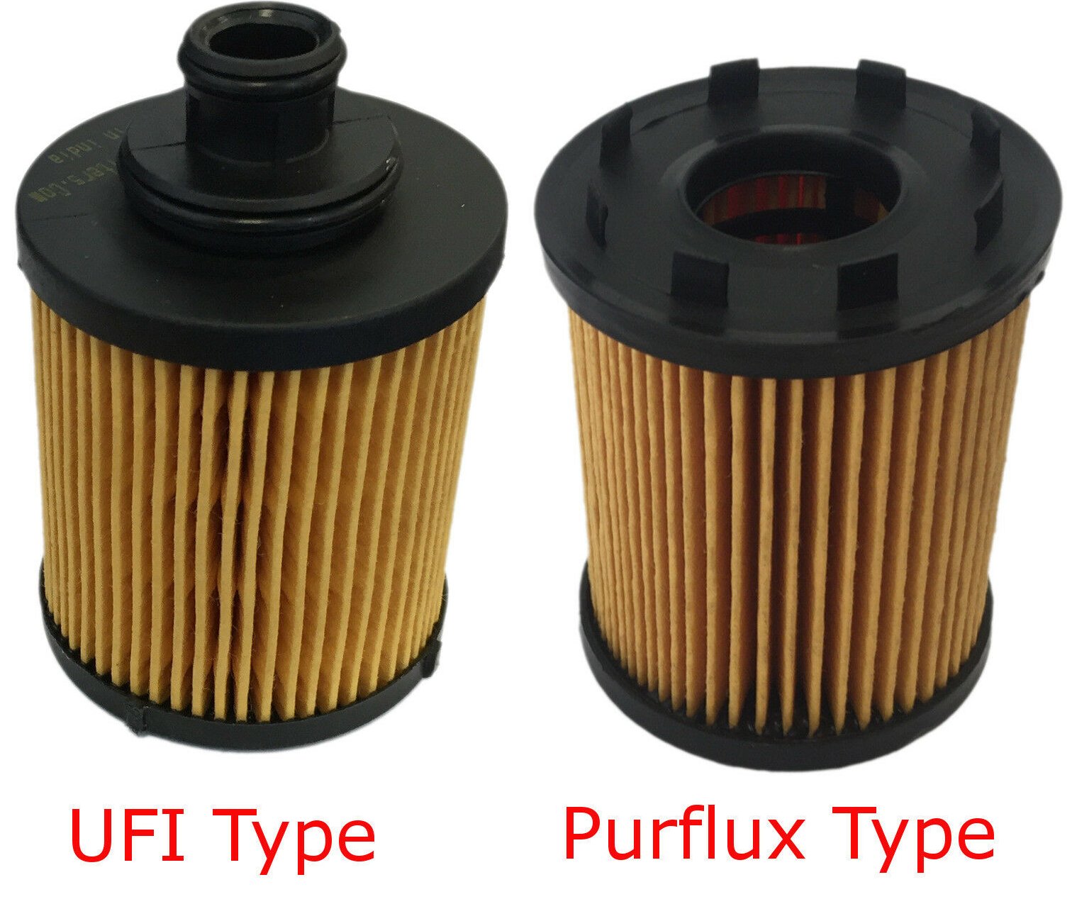

for clarity here are the differences
the tabs on the top of my purflux have a round plastic thing that clips into it which contains a spring [not shown], this then fits to the screw on filter housing/cap to keep the filter central and attached to the housing ready for installing the unit back in place.
it has to be transferred from one filter to another, I will get a pic of it tomorrow or whenever I switch my filters, perhaps it isnt even needed, but mine has always had it.

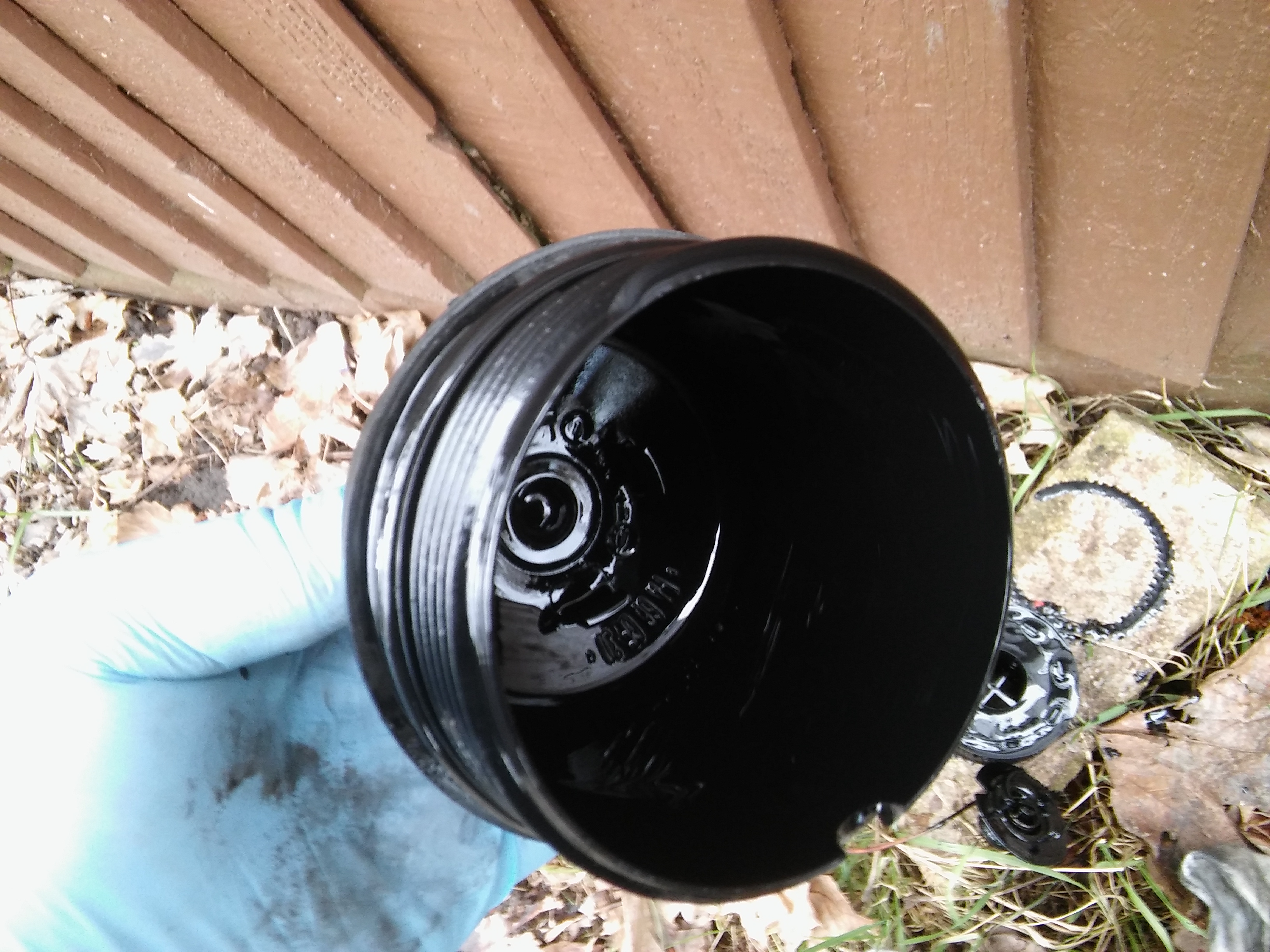

then we have me picking the plastic fitting off the filter
this is the housing turned upside down so you can see the insides, it has a fitting for the plastic bit to clip into
now I have put the plastic bit into the housing, its clip is broke [always has been under my ownership, so it wont stay there, it has to be put onto the filter first]
now here is the inside of an aftermkarket housing, it just has a small moulding that fits into the top of the filter, doing away with the clip altogether [I am going to order one]
so thats that, engine still runs perfect with this new filter [a Crosland] which I just put in, so my initial problem was with the oil filter bought previously which was made by ZIP Filters.

The second picture was like the filter on my 500 was both the one on the car and the replacement I got because of a small chip out of the one that came with the car
A one piece lid without separate center part
