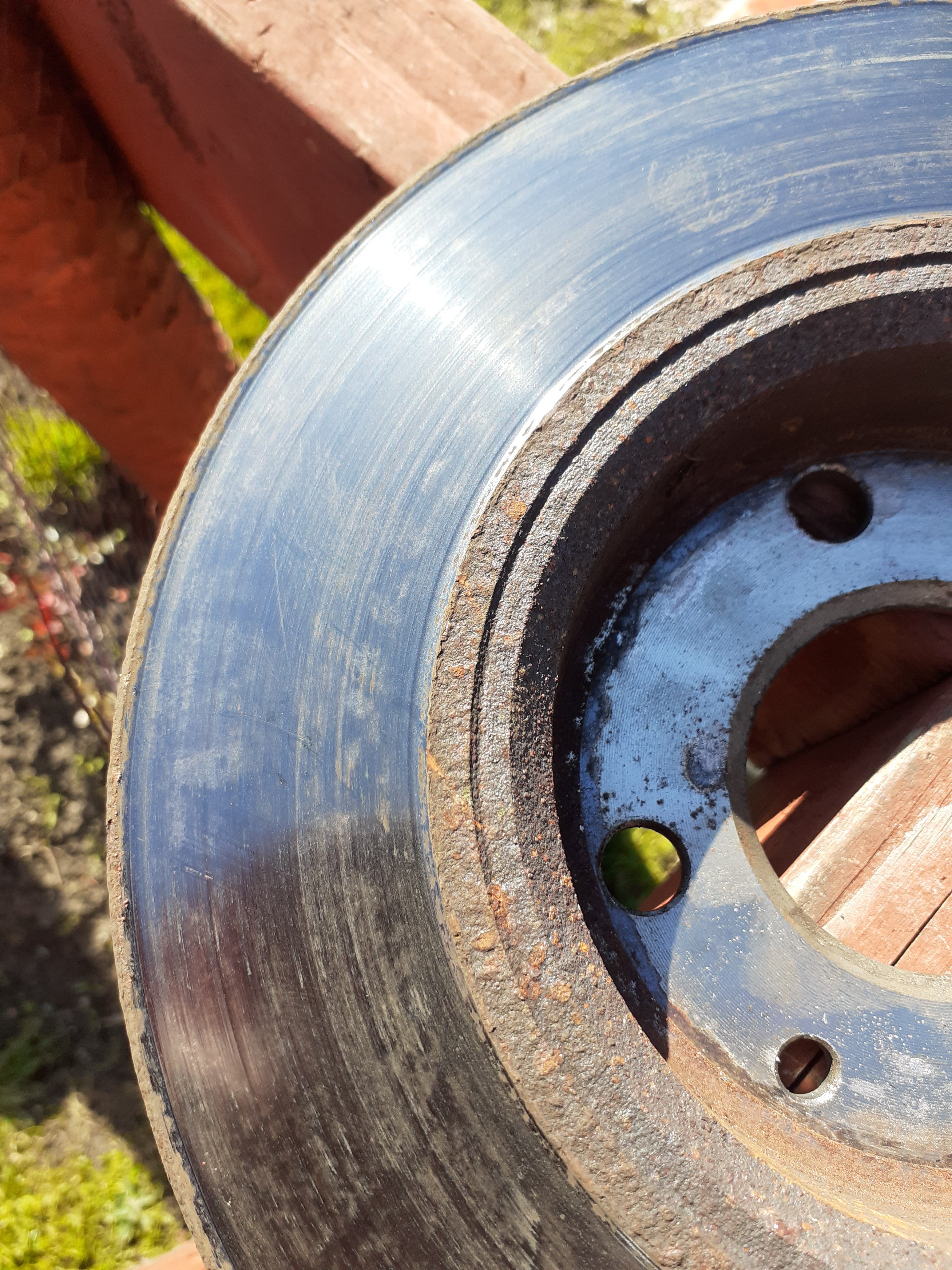

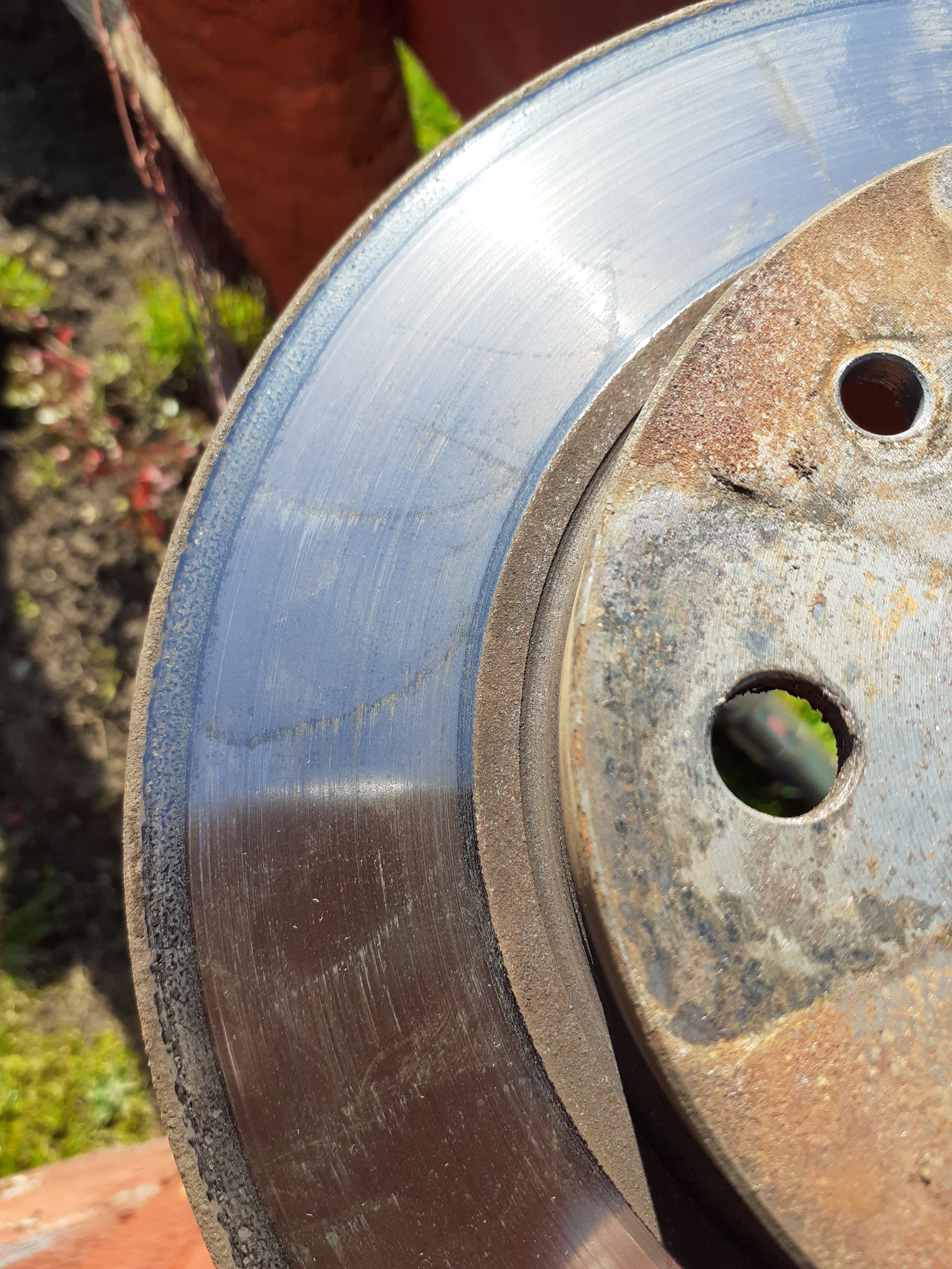

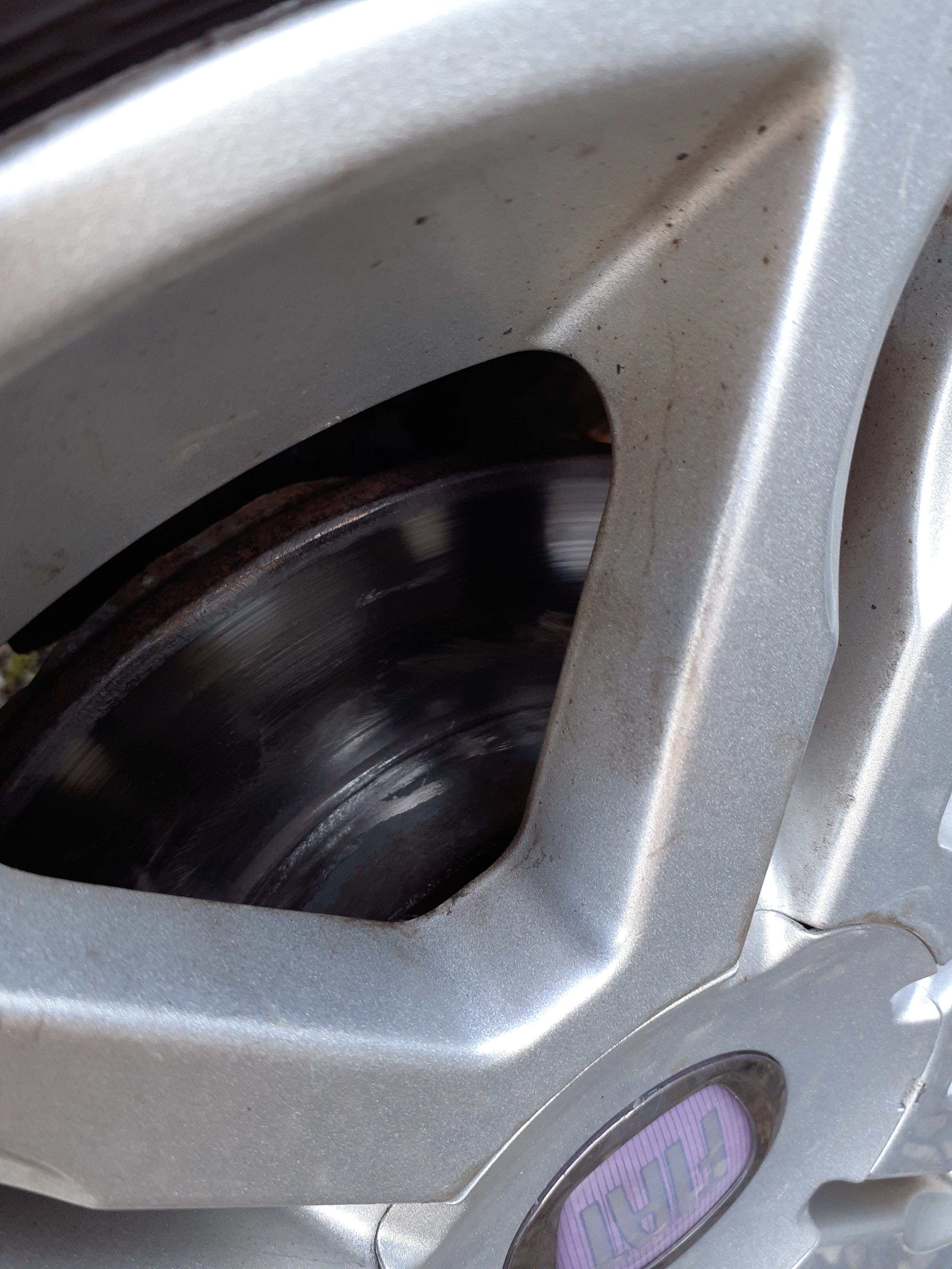

Well I managed to get the discs off and cleaned again. Not too bad but already looking shabby after just 10 months. I conclude the caliper mounting slider pins and bushes are not good so will try and get another year at which point the whole front brakes will go in the bin. New calpers are around £80 a pair and come with the new slider pin. I am going to seek some soft brake pads to encourage the piston to move quicker rather than stay more or less static. I hope new pads will conform to the disc quicker and help prevent rust and crud build up.
